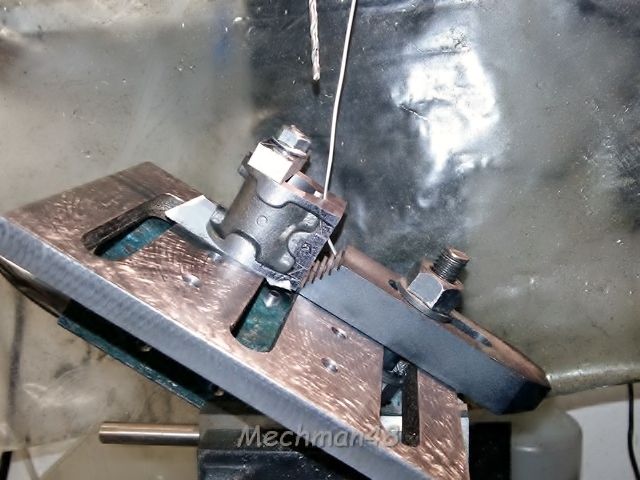

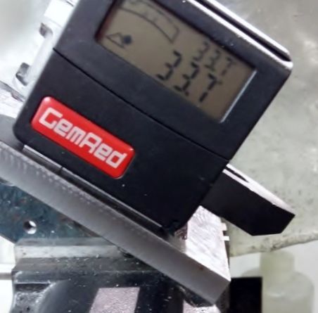

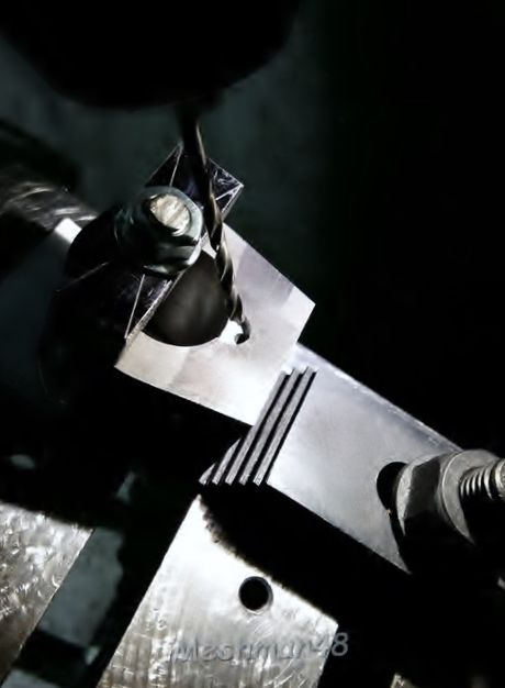

                                When it comes to machining the steam passages I set up the cylinder on an angle plate set in the vice & squared up the steam passage calculated centre line with a square then drilled both steam passages. The book says the angle should be between 25* – 30*, my angle gauge shows 33* but given the casting discrepancies a degree or two either way shouldn't raise any concern.

                                Passages drilled…have come out nicely in the port centres.
