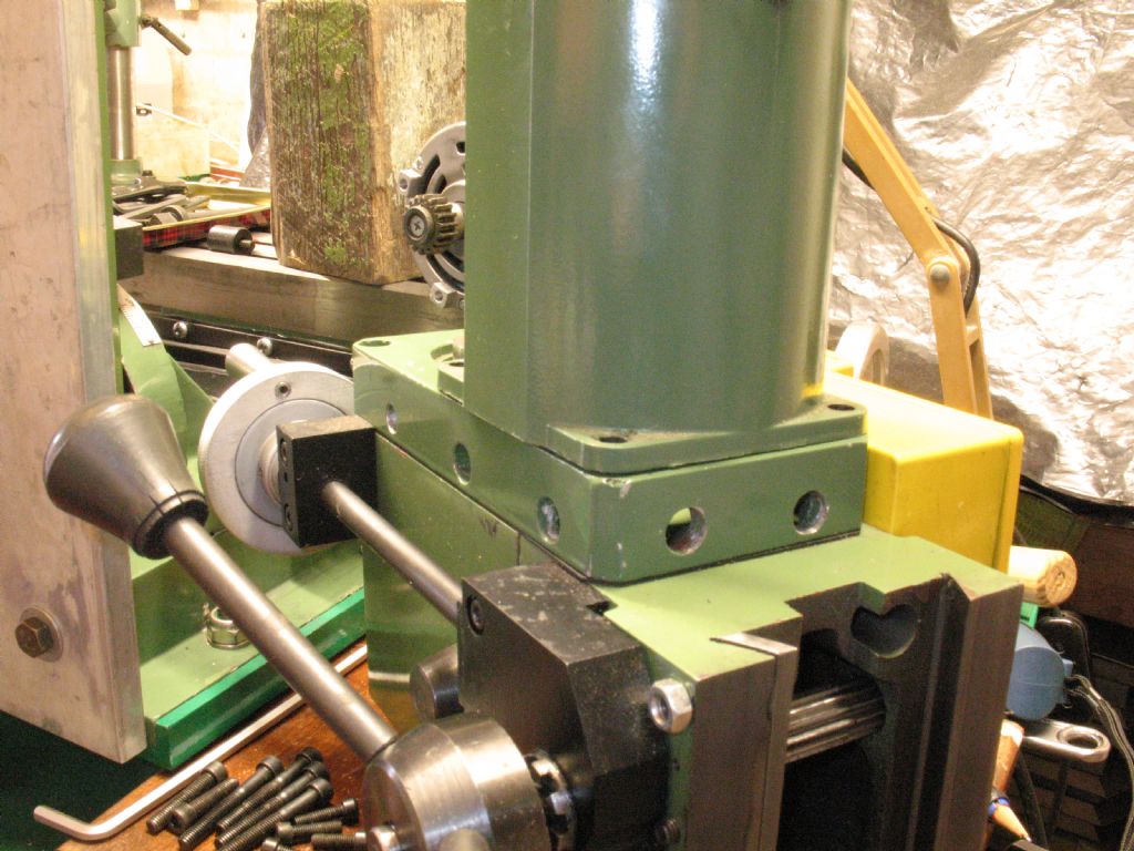

        Hi folks,

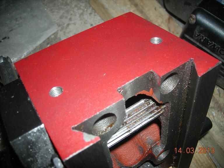

        I am looking for informed opinion on the strength of cast iron when subjected to an extracting force of about 16kg via either a M6 or a M8 bolt.
        In MEW 251, Phil Dawes describes how he modified his SX2P milling machine by replacing the spring loaded side lifting arm by a counterweight system. As I have a Warco MiniMill (X2 clone) using the same system, I thought that it should be possible for me to do the same.

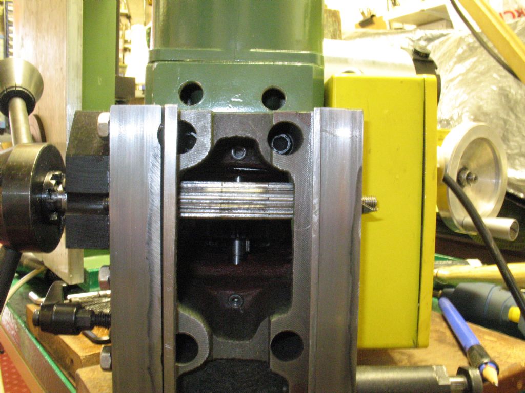

        Phil says that he was able to attach the lifting chain to the milling head by means of the two rear bolts holding the motor to the head. As the photo below shows, I do not have those screws, and the two nearest screws do not have sufficient room to have a suitable bracket attached.
        It seems to me that my alternatives are to either replace the cast aluminium spacer between the motor and the actual milling head with a longer spacer but this then poses problems with creating the spacer on the lathe, the lengthened spacer being 200mm long, or to fasten the lifting chain directly into the dovetail section of the milling head.
        The flat surface of the dovetail is about 23mm wide where the rectangular cutout is whilst the vertical thickness is 11mm.
        The second photo shows a close-up of the rear of the dovetail.
        You will be able to see that there are caphead screws down the two holes, whilst in the middle of the cutout section can be seen a dowel which serves to ensure that the two halves of the head are correctly located.
        As I see it, I can either use a single M6 thread or a single M8 thread into the top of the dovetail, hence the thread would be 11mm long. I suspect that M8 would be better as then the individual threads would be thicker, and therefore stronger. Alternatively, I could shape a piece of 6 to 8mm thick steel to fit inside the curved section with a clear hole through the cast iron. This would have the effect of compressing the cast iron and at the same time spreading the lifting load over a larger area.
        Ideas & thoughts please. Incidently, I am proposing only using one screw through the cast iron. I feel that providing two screws, even if only M6 might weaken it too much.

                      Peter – to try to offer an answer: There are two fairly big holes in the back face of the motor support block. It seems possible to add a plate bolted to these holes – simple bolts, nuts, washers – and then add your chain, hook, etc to the plate. This would mean that the strength of the attachment depended on –
                      a) the two bolts in shear – and they look like 10mm each, ie plenty;
                      b) the thickness and material of the plate – up to you and your scrap stock.
                      And in the event of failure of the extra support, no damage would be caused to the machine.
                      Regards, Tim

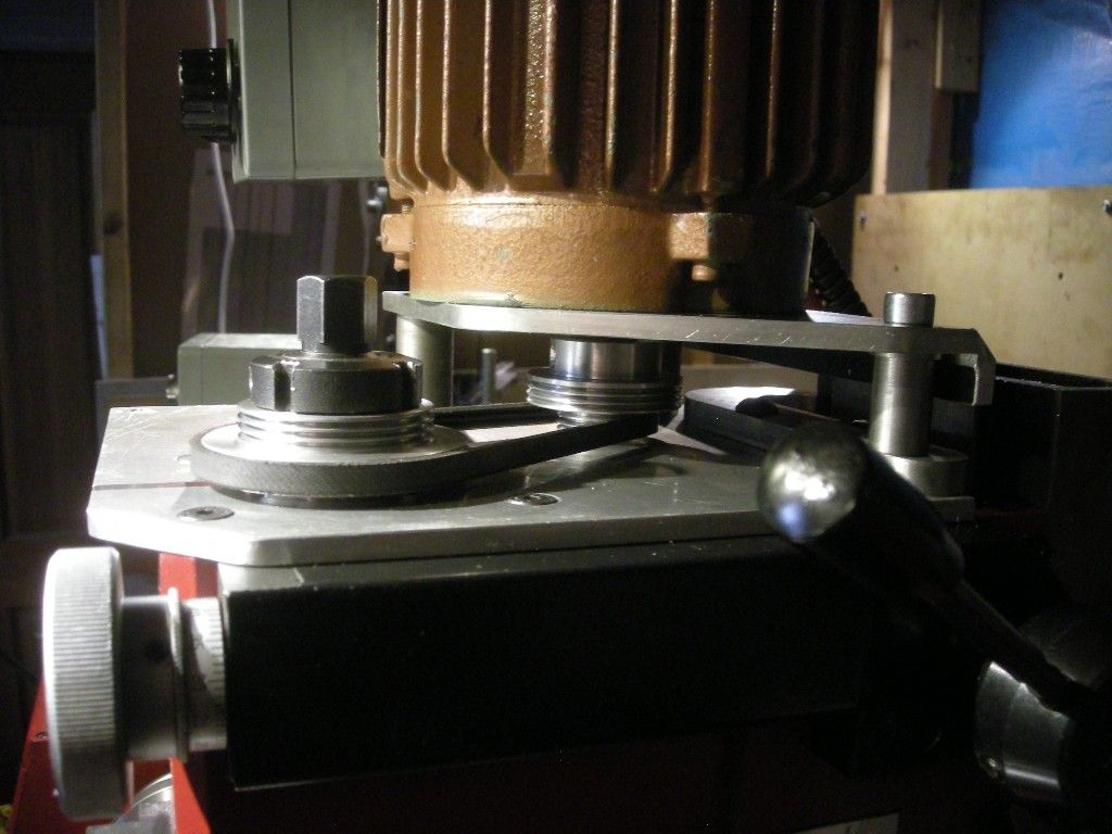

                            Peter,

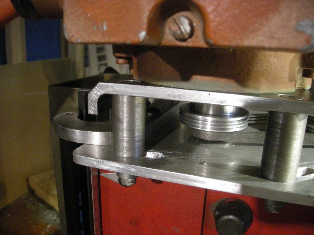

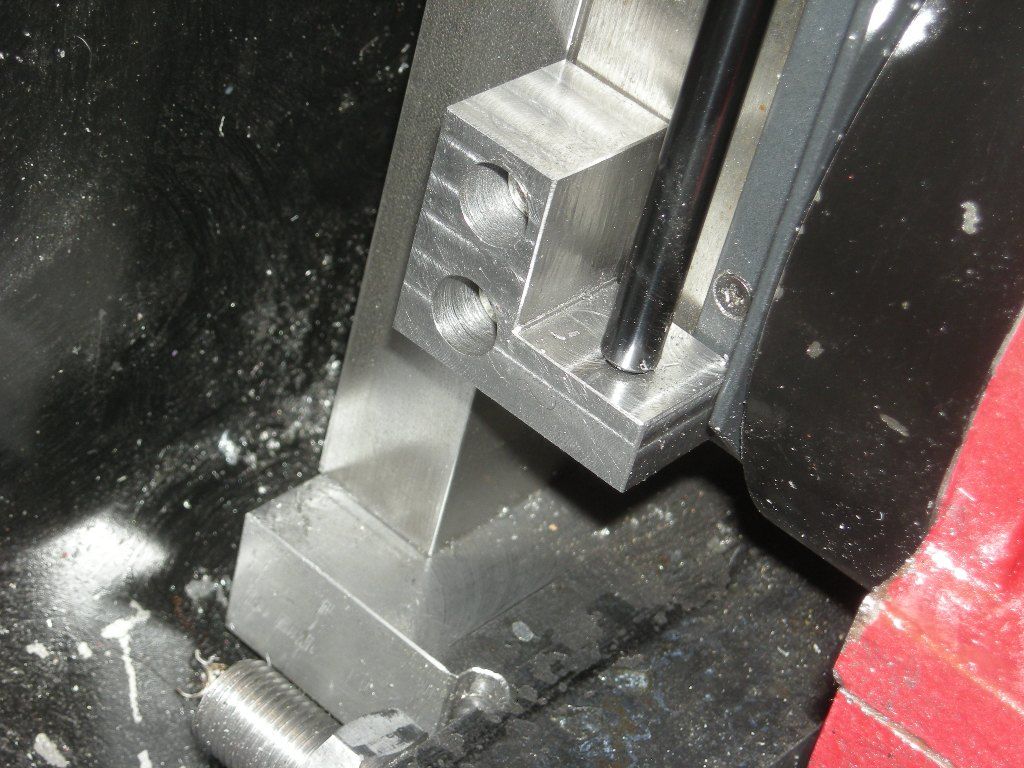

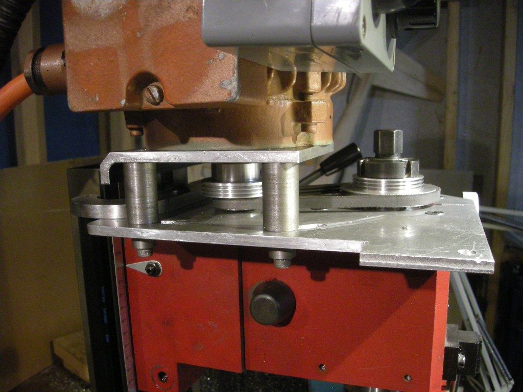

                            My X2 has been modified to use an air spring to support the head with the additional weight of a 3 phase motor. Two M8 cap screws into the cast iron rear housing/dovetail area have been sufficient for several years without any issues.
                            The photos below show the setup as it was before further mods recently, including moving the mill head from the lathe and attaching it to an SX1P X-Y table.
                            Andrew.

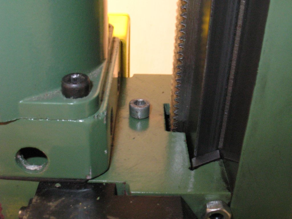

                                        Hi all,
                                        Thanks for all the replies. Some answers.
                                        Tim. The spacer appears to be a cast aluminium block, well not so much a block as 4 sides and a top about 6mm thick with a few ribs therein. It's lightweight, so I don't think it's either steel or cast iron. I have to admit that when it comes to cast aluminium or cast iron, I'm rather shy about putting any load on.
                                        Richard. I have now drilled and tapped the casting (see photo – caphead screw inserted). I used the workshop cleaner to suck up any dust as it was produced so didn't see the dust. I drilled & tapped easily without using any tapping liquid or grease. I'm reasonably certain it is cast iron.
                                        Andrew. I understand what you are suggesting but I would then need to modify the spacer to be able to use them.
                                        XD351. That's just the sort of answer I was looking for. No photo required, thanks.
                                        To all. I've now drilled and tapped for M6 as shown in the photo, eg the cap head bolt near the rack.
                                        You will notice that I haven't got much space to play about with, and indeed having done it, I now find that the top part of the motor cover means that the lifting chain will have to be attached on the rack side of the screw. In addition, there is a mechanical stop at the top of the column which may get in the way, but that can be made shorter or even permanently removed if necessary.

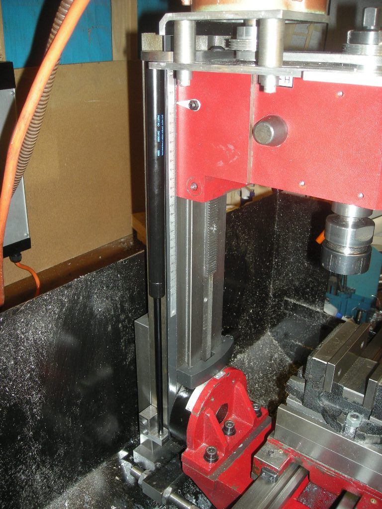

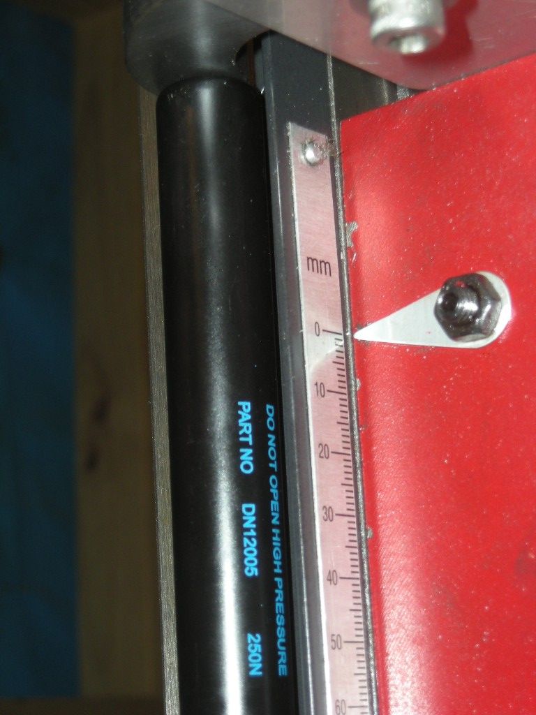

                                          I made a pulley system with a couple of gas struts for my SX2P. Photos are in one of my albums. I used a wire rope and fixed this into a block which is fitted to the cable after it is passed through a plane hole in the top of the spindle bracket. It works very well and balances the head perfectly. The hole strut assembly drops into the column and held with some screws in the top face.
                                          #353768
                                          HOWARDT
                                            @howardt
                                            I also took the opportunity to pack the rack out on the column. This improved the movement of the head, whilst it didn't remove all the play from the pinion it was a lot better than as built.

                                              you'd be better off attaching the chain in line with the M6 screw, can you screw an eye bolt in?

                                                I only buy and use the 12.9 capscrews. Where you have the M6 screw, to secure a a lifting point, you could thread a piece of steel bar, wind it in to it is finger tight, then mark where you can drill a cross hole, and use a 6mm shackel to attach a chain or what ever else you want. The connection can also be made with a long grub screw, with enough sticking out to screw on the adaptor for a lifting something. You have room for at least a piece of 12mm something. You could also modify a capscrew , put a 6mm thread on one end, skim down the socket head(if it is too big) then drill the crosshole for a shackel also. Neil
