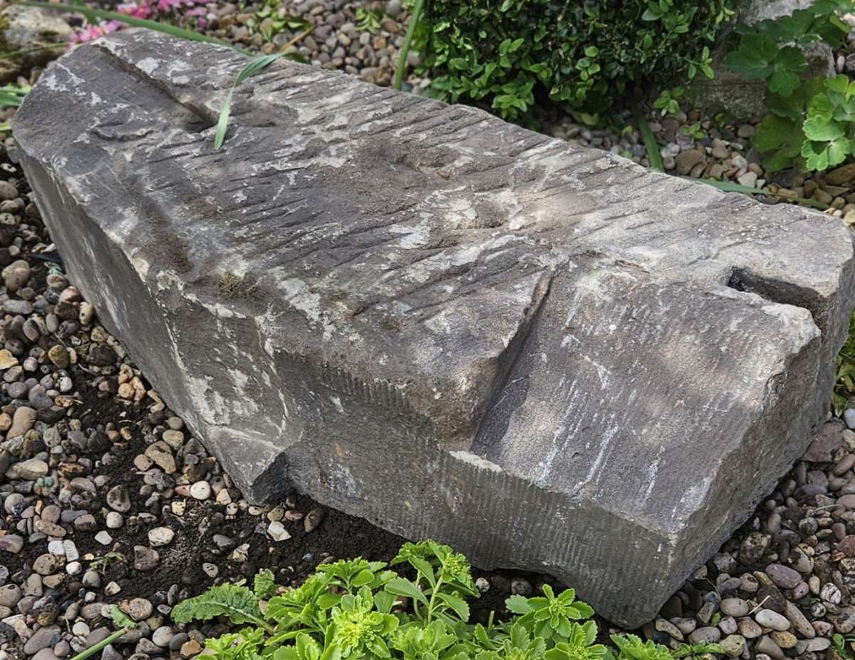

      Our community garden is located on the site of a victorian town house which was demolished in the late 60s.
      We dug up a little bit of stone that kept blunting our lawn mower blade.
      Turned out to be a bigger job than we thought.
      20250529_122857
      Its a lump of dressed sandstone, with obvious tool marke on the rear and lower faces but clean chiselled surfaces on the top and front. There are two slots cut into the top face. Underneath mortar still bonded to the stone face.
      Does anyone know what part of a house this looks like, it woukd be nice to see if we can mat h it to the original building .

        Possibly a window sill but broken i.e. only the LH part — note the sloping top and dressed front. ????

          Thanks John.  Yes the sloping part was something I noticed. Are the slots for metal staples to keep the blocks together?

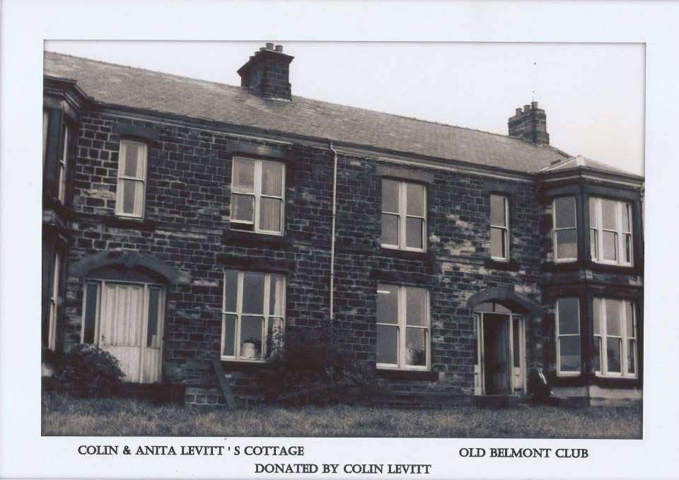

          IMG-20250529-WA0033
          This is an image of the original building. It was apparently a single very decent house when first built, with servants bells on the kitchen wall. But it was split into three separate cottages and then converted into a social club in the 1920s.

            The far slot is for a cramp, the near one could be too, but could conceivably be a lewis hole, for lifting – the block broken in half at this point.
            Half of the sill of one of the bay windows?
              The cramp you mention, is this a metal staple to join two pieces,  I’m not very up on my masonry.

                Yes exactly that, a staple glued in with molten lead.
                A lewis is a method of lifting usually involving three keys or feathers linked by a shackle, placed in a dovetail-shaped hole – the outer two flare out at the bottom to form a dovetail shape, and are inserted first, followed by a central parallel-sided one to keep them from closing. Once all three are in they are linked by the shackle and lifted – a brilliantly simple idea going back millennia that’s never really been bettered (only made cheaper!).

                      Possibly a cornice rather than a sill, but pretty certain it’s a bay window part.   Broken perhaps because it was thrown from a great height when the building was knocked down.
