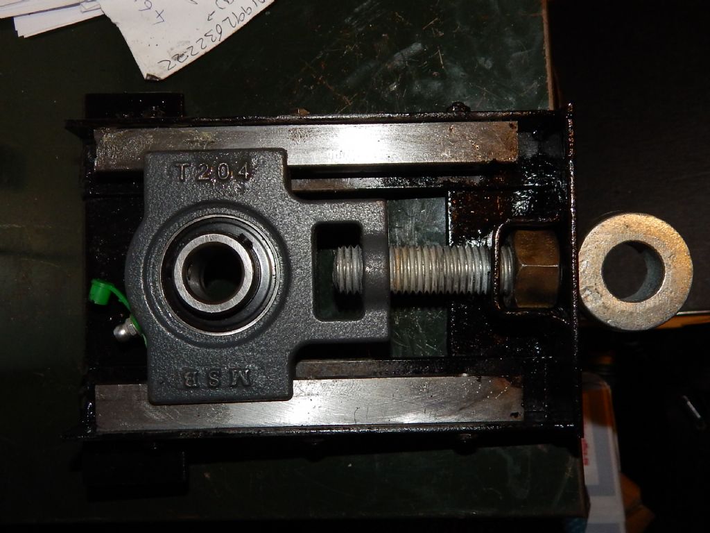

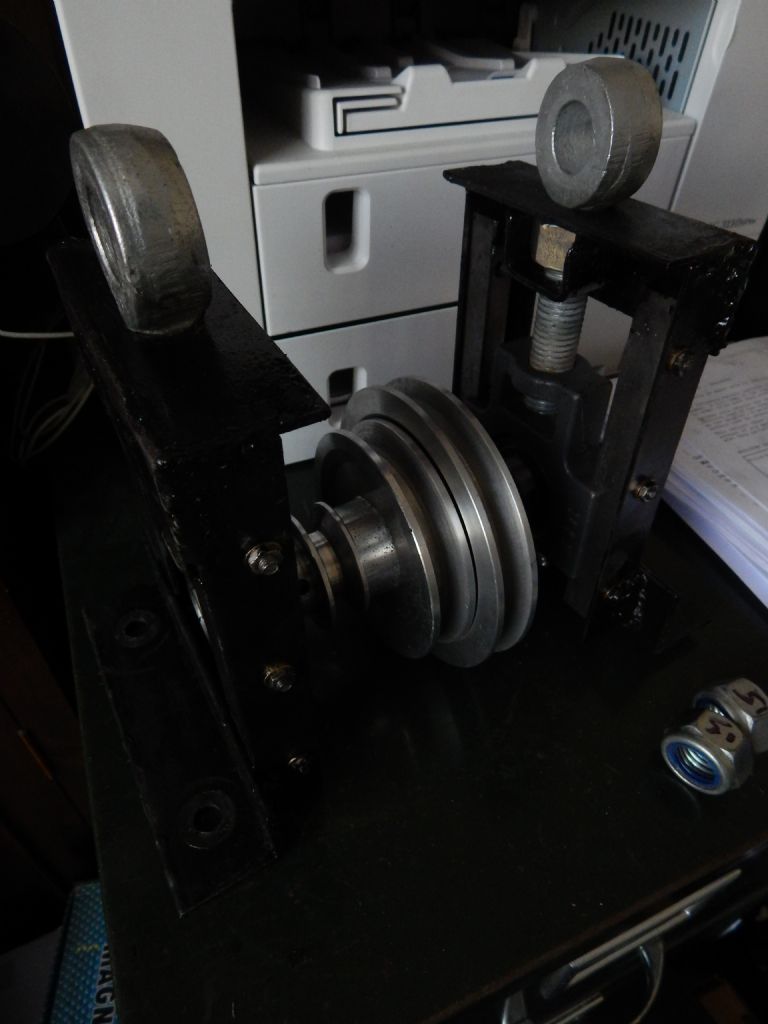

              welded in nut holderWelded in nut holder one side

                  Added in the eye bold and nut all fits ok on this one . Checked my excel spreadsheet and 3000rpm gives me extra 59rpm. I can fit in a six in pulley or even an eight so have room to change speeds MAdded the eye bolt and going to cut down a nyloc to fit in to bearing

                    Hi Martin, you will be better to put an ordinary std. nut in the bearing aperture and then drill and pin it through the threaded rod, rather the a Nyloc one.
                    Regards Nick.

                      Hi Nick,
                      Am going to try the nyloc cut down first. 5mm from the other side of nyloc . I think it should hold fast as it will spin in hole. Why do you think this would not hold i would prefer a castleated nut but its hard to find one 3/4.

                            Hi Martin, a nyloc may well hold OK, but it will be more of a pain to hold while you are tightening it up, or taking it off if you need too, as you will not be able to get a spanner on to it. A plain nut should screw on far enough with your figures and a roll pin will be both much easier to put in and remove. It's the most common way I've seen it done in industry and far easier that a castleated nut. A small nut and bolt can be used instead of a roll pin if you wish, as long as it is not too long to turn in the aperture.
                            Regards Nick.

                              Or you could dig the nylon ring out of the Nyloc nuts you already have, put a wide sawcut across the top and you then have a castellated nut that will screw on easily and can be retained with a split pin that will wrap nicely around the reduced dia of the nyloc.

                                Thanks everyone I cut the nylocs of with a friends lathe and drilled one and have it pinned with a roll pin works great . Have had to order some more roll pins as I ran out so am in limbo with motor apart until I can fathom what all these connections are fore. I have a circuit diagram but its not helpful as its has 9 types of motors a D.C Series , D.C Compound, Split Phase, Induction Repulsion – Four Motor leads windings in series D.C Shunt , Induction Repulsion Three motor Leads, Three Phase, Two Phase -Three wire , Two Phase – Four wire.
                                Mine is a Kity motor single phase with a cap and four wires and two temp I don't think it fits into any of these nine so am a little confussed as to what type is what.
                                Made up nuts for roll pins
