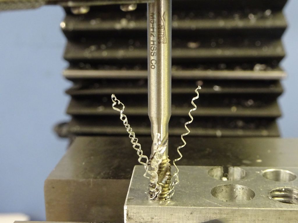

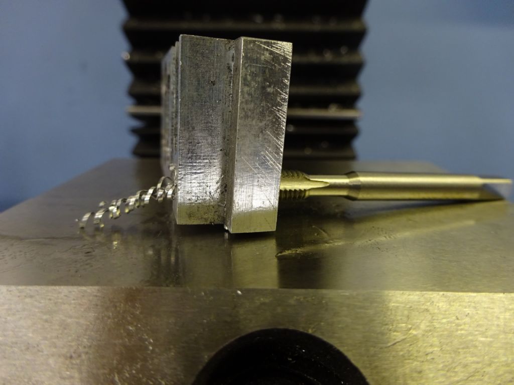

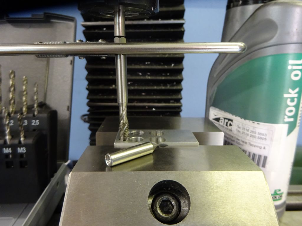

                        #428941
                          I thought I coverd that
                          "The shorter lead taper on the spiral flute and spiral point taps can make it a little harder to start freehand so they are best guided either by the machine that just drilled the hole or a tapping guide/tool."
                          They are not easy to start just by hand you need a cachine or guide to start them and to get the best performance drive them under power, Andrew tends to use a slightly larger tapping drill size than me so that may be why he finds it easier. Hobbiyists don't need the performance so they can be turned with a tap wrench with the top of the tap guided.

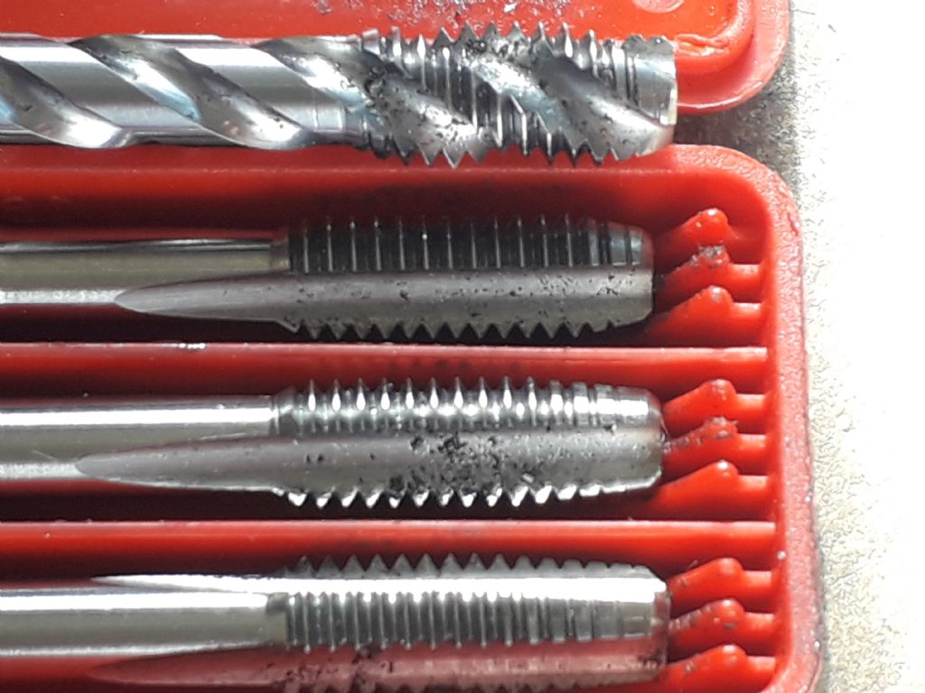

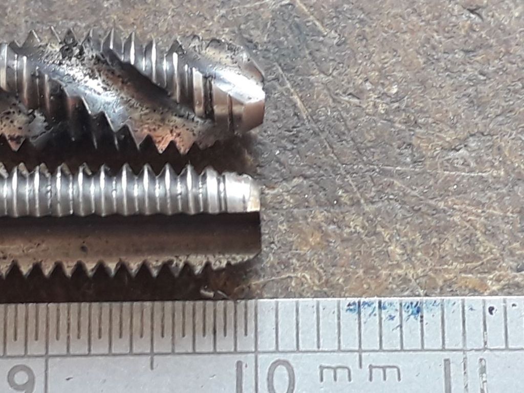

                                        Vic, I took it that you asked "why are they called machine taps" I thought I answered that they really need a machine to guide them be that directly under power or using the machine to guide them. They are not easy to start by hand.
                                        Michael many of the saller size "machine" taps come with a pointed end as do hand taps so really you need to compare like with like, unfortunately I tend to grind these pointed ends of my taps so that I can get further into the bottom so don't have any photos to show.
                                        However this red box contains a set of three Dormer E500 seriesM6 x 1 hand taps in the usual 3 tapers together with a YG-1 spiral flute tap at the top. All four have had the pointed end ground off and as you can see there is very little difference in how far a full thread could be cut to within the bottom of a hole, probably less than one turn.
                                        And the two together
                                        If you also take into account the swarf at the bottom of the hole as illustrated on the thumbnail of the video there really is not a lot in it.

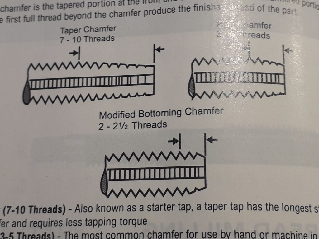

                                        #429078
                                          Vic, you may also have been asking this question "Anyone know why they aren’t just called spiral taps?"
                                          That is simple, as there are two distinct styles in common use they need to be called spiral point or spiral flute. I also have some spiral point hand taps so that is another reason to give separate names separate them.
                                          I think we should all get used to using them, at least those of us with a few years to go as hand taps are going to become harder to find, just looking a one doorstop size catalogue I have here there is about 6 pages of hand taps and over 30 of "machine taps" and even more pages given over to thread milling. Industry is what all the main makers produce for so the home machinist will find it harder and harder to get what their grandads used.
                                          Also from the same catalogue, half a turn in it.
                                          Edited By JasonB on 15/09/2019 13:18:36

                                            Jason,
                                            I regret to say that your catalogue clipping further confuses the issue
                                            It illustrates the Modified Bottoming Chamfer, not the Bottoming Chamfer
                                            The 'Chamfer Styles' tab on this page **LINK** does rather better
                                            https://www.mscdirect.com/basicsof/taps
                                            … interestingly; it also distinguishes between 'bottoming' and 'plug' in a way that makes sense, but is, perhaps, uncommon.
                                            [some other sources use those words as US/UK variants]

                                              Not sure what your first link really shows, it says that a bottoming tap can have upto 2 turns of chamfer, The link to the YG one I posted has from 2 turns so depending on what is actually being used you could get to two turns of the bottom with either. It is also interesting to note that The Dormer ones that I bought from MSC state that one in my photos is sold as a bottoming tap and that has more than two turns so it does vary from make to make.
                                              Agree you won't get as deep as a bottoming tap with one turn of taper but you could get as deep as one with two turns.
                                              So that would seem to cover your question "are they suitable for bottoming" , the small pointed end on the AXI one would fall within the cone of the drilled hole unless you are drilling flat bottomed holes Though Axi don't state what tapers theirs have.
                                              That link I posted was for one of about 30 spiral flute taps that YG-1 do, and the tapers do vary on then so you may even be able to find one with less than 2 turns if needed in just the same way shopping around for a different bottoming tap may get you closer to the bottom with one make than another, eg 1 turn as per your link. Or just grind the end of an old or broken one down to zero taper as those that get out to the workshop do when a thread is needed as deep as possible.
                                              Edited By JasonB on 15/09/2019 14:43:39
