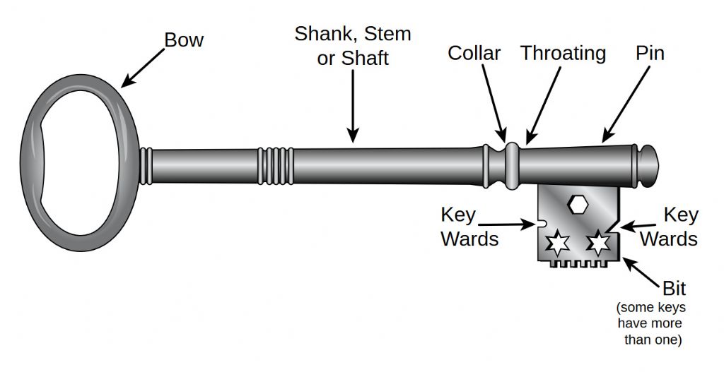

                              The narrowest slot is just under 2mm wide and 6mm deep. There are 14 slots in all, 7 on each "blade" (Can someone tell me what the correct name is for my "blade"?).

                              #278634
                              Journeyman
                                @journeyman
                                Courtesy of Wikipedia:-
                                Cheers, John
