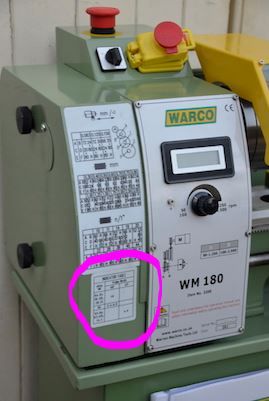

      I'm trying to cut an M16 x 1.5 thread on my Warco 180. The leadscrew is 2mm and the gear train set up as per the plate on the cover. The problem I am having is that I cannot pick up the cut on successive passes even though I'm using the same point on the thread dial indicator. I am ending up with a cut every .5mm or so instead of the single thread at 1.5mm. Am I doing something wrong or is it likely to be a problem with the lathe? Any thoughts would be welcome before I tear my hair out in frustration.

                      #384493
                        You should have the "indicator chart" on the front of the machine though not all have it.
                        This shows what numbers you can use for each pitch and I also think there are two options using either a 40T or 42T in the drive train. Can't find an image on line big enough to enlarge.

                                  Thanks to all who responded to my plea. My lathe has the plate fitted but I didn't have a clue how to read it – I do now! As the 42 tooth gear wheel is about as rare as rocking horse poo I'll just leave the half nuts engaged and reverse the lathe. It's only a short length of thread to be cut and there's no panic to get it done so I can use the rest of the piece to try it and get some experience before doing it in anger.

                                      Is the 42T not supplied as part of the gear set or is it already on the indicator? Sometimes they bot fit on the end and you just swap them round or move the indicator so the correct one is engaged.
                                      Would make sense that 42 is needed going by what has been posted above: 42 x 2mm pitch = 84 which can be divided by 1.5.
                                      #384563
                                        Watch this video, about 2mins in he shows the 42T gear which is included when you buy the machine, finer pits and slightly angled.
                                        26mins in shows the chart with 1.5mm pitch needing the 42T gear and then drop in on No 4 or 8
