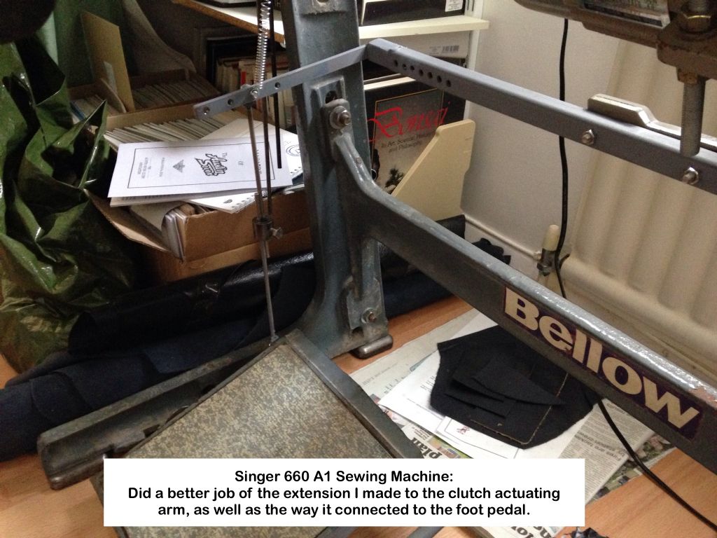

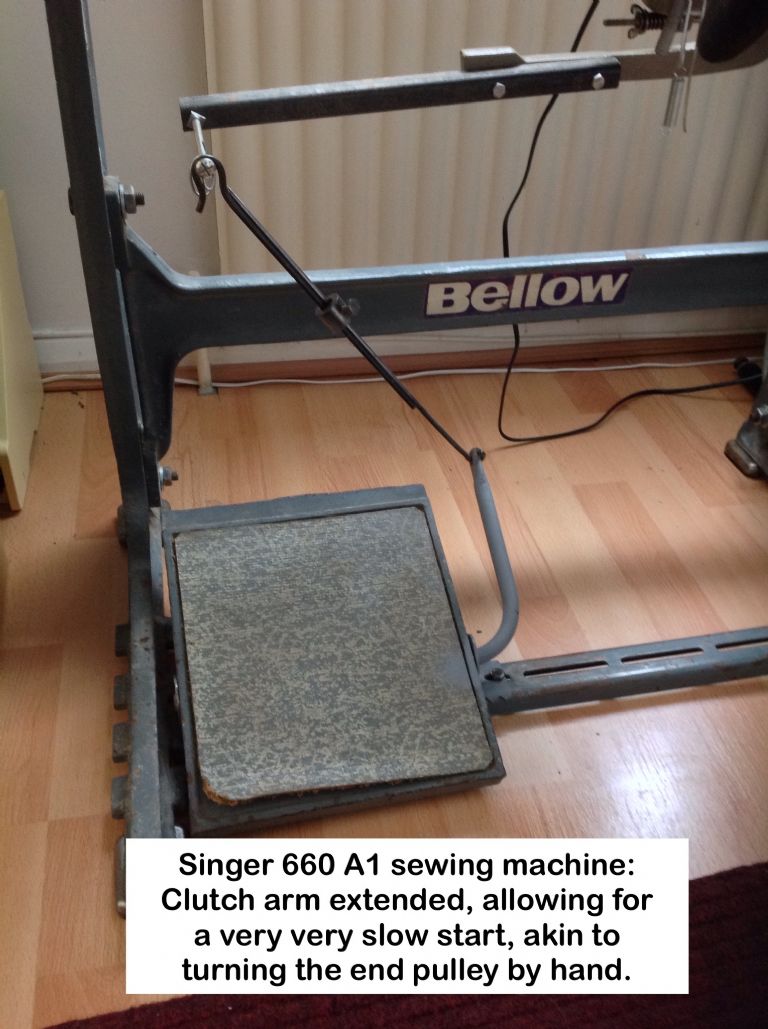

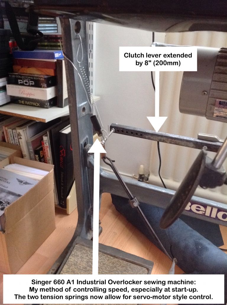

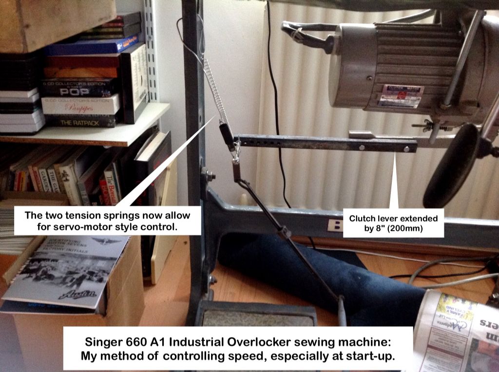

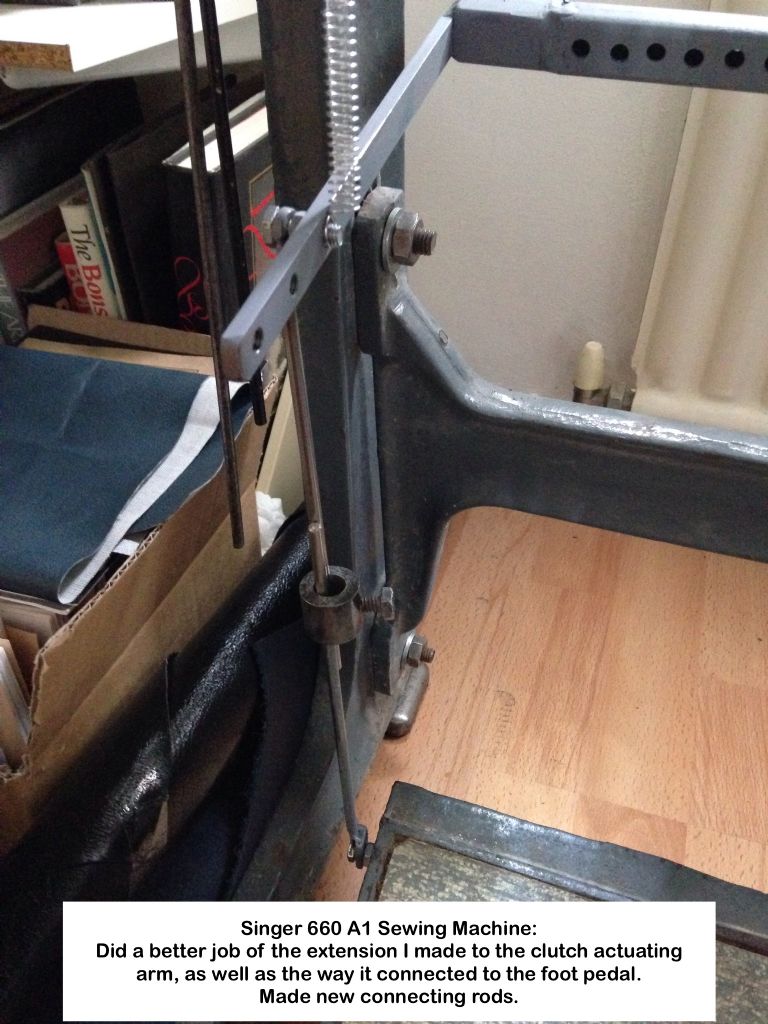

                  #197756
                  OuBallie
                    @ouballie
                    Yesterday.
                    Time to try and tame the the start up of the machine, as it takes off as soon as the clutch bites, making it difficult to start sewing leather.
                    A servo motor would of course solve the problem, but that would be the absolute last solution.
                    Leverage sprang to mind, so I grabbed a piece of 20mm sq tube, drilled three holes to lign up with those in the clutch arm, bolted it in place, and extending said arm by 8.1/2" (215mm).
                    Had to fit that long bolt to the end in order to get the two foot pedal rods to hook up.
                    The result had me whooping with joy as I can now get the machine to start at a crawl, thus making it much more pleasant to use.
                    Singer 660 A1
                    Geoff – This has to be my quickest mod ever surprise

                                        #199444
                                        OuBallie
                                          @ouballie
                                          Update at last on slowing the start-up speed of the Singer.
                                          I am now able to get the beast to start at a crawl, but only time will tell if I've been successful once I start serious work using leather.
                                          If not, then a servo motor it will be from College Sewing.

                                              Completed at bleep last!
                                              Singer 660 A1 sewing machine
                                              Works well
                                              In action
                                              Geoff – I know thinks take a while to get done at Chez OuBallie, but this really is talking the wee wee!
