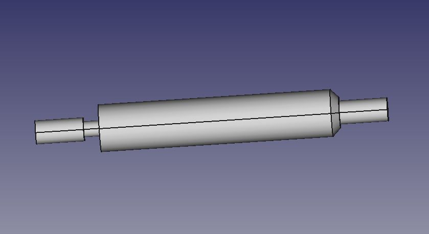

                I'd be inclined to try Silver steel and to heat treat it. The long unsupported rod breaks because it acts as a lever and puts a lot of stress on the rod just where the 3mm thread weakens it considerably.
                Hardening a silver steel rod won't make it stronger but it might make it more resistant to fatigue cracks by turning it into a spring that distributes the stress rather than concentrating it. For the same reason it might pay not to cut the usual relief on the inside end of the thread, instead cut the thread into a chamfered end. ie Prepare the rod as on the right rather than the left.
                I'd make the chamfer longer than shown in the drawing.  The latest version of Freecad on my machine is unstable and buggy – I didn't push my luck after I'd got the model nearly right!

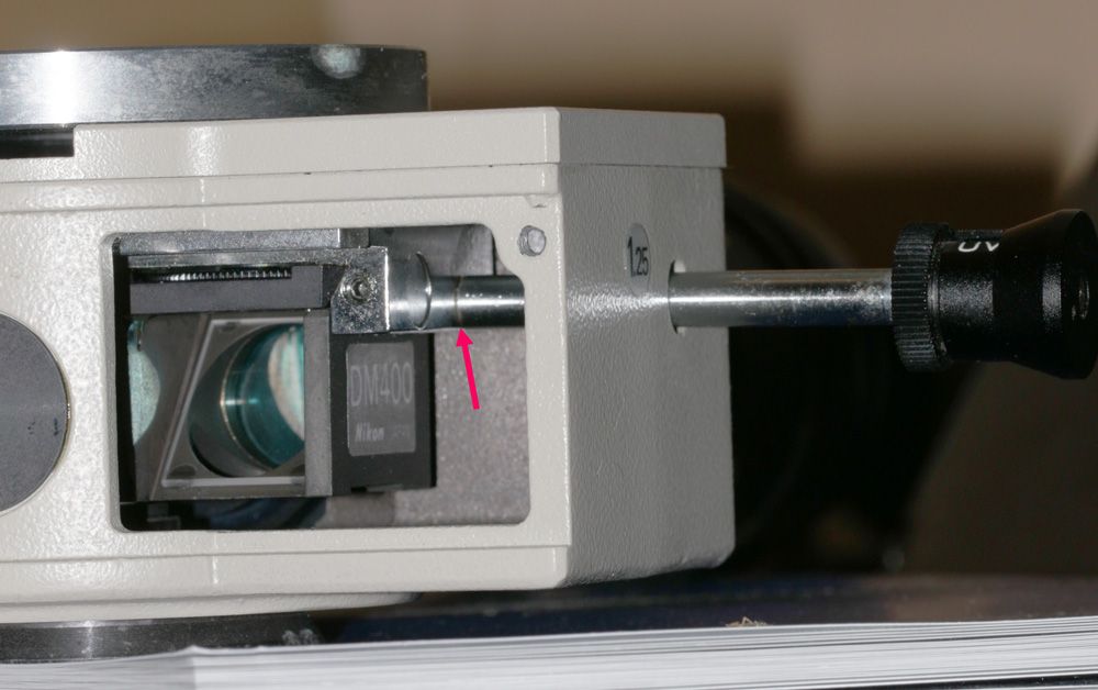

                                                I'm not that confident the tailstock on the lathe will be very near the axis…
                                                ANyway you asked for pictures:
                                                This is the bit of microscope, the one existing rod is in place, screwed in a the point arrowed. It IS steel of some sort that it goes into. As you can see the rod goes through a large hole. Quite why they break I don't know.
                                                It's moving a filter cube in the fluorescence illumination head of a 'scope. There are two filters and a dichroic mirror in the cube. You use light of wavelength X, which reflects through the objective lens onto the subject, which you preload with fluorophores which emit at a different wavelength Y. None of X gets up the eyepiece / camera, so you only see your excited bit of subject, emitting in its own colour. Then you use a different excitation wavelength and cube and different fluorophore, for a different bit of your subject. The light source is usually a mercury arc lamp, though LEDs are replacing them because they're made with a narrow colour bandwidth.
                                                Normally you tag a protein or drug or whatever so you can see where it's got to. You can tag cancer cells or TB cells, or things smaller than a wavelength of light. They emit so you know they're there.

                                                      Posted by Chris R 1 on 25/01/2019 01:39:15:
                                                      It's moving a filter cube in the fluorescence illumination head of a 'scope. [ … ]
                                                      That looks unusually poor engineering for Zeiss Nikon Chris … but I suppose they have 'moved with the times'
                                                      I suspect that the reason they fail is that they unscrew slightly, in normal use.
                                                      The bending stiffness should be maintained by face-to-face contact; but if the joint slackens the load will be taken by the screw.
                                                      Is there room to add a sleeve to the end of your new rod … to span the joint line question
                                                      … it only needs to be a thin tube.
