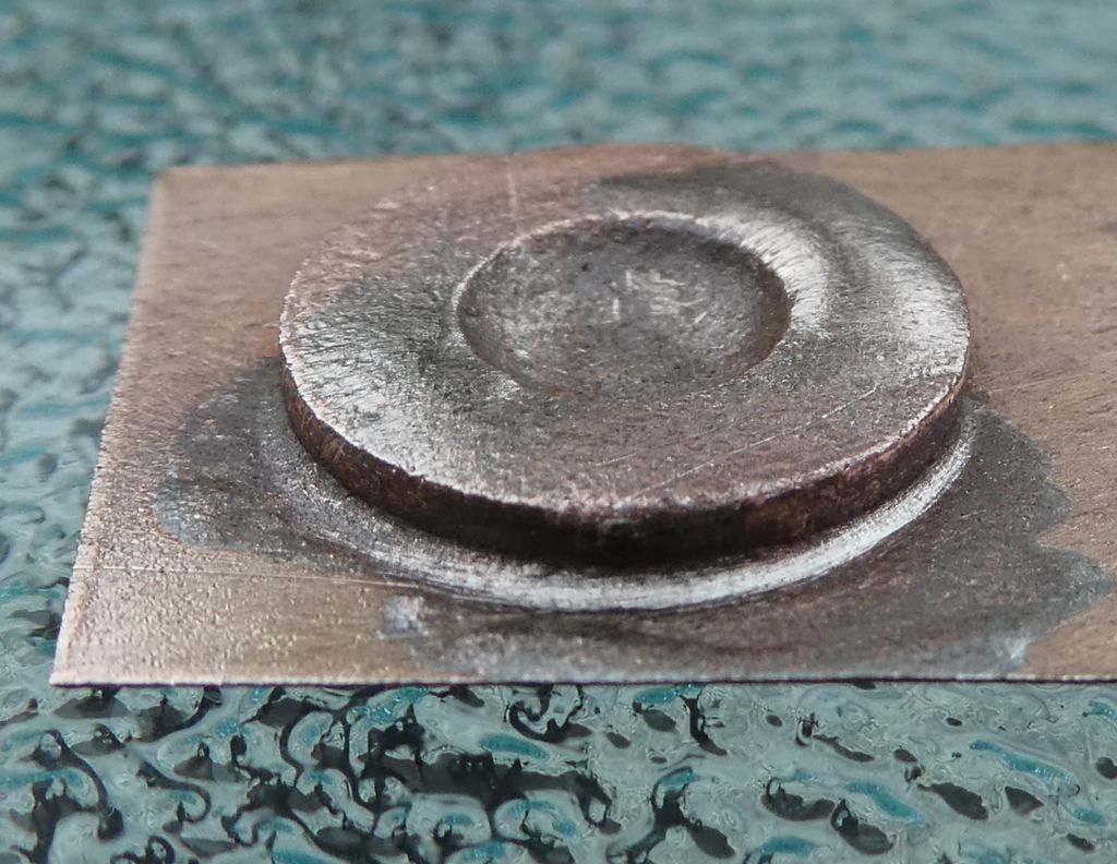

        I have acquired a bundle of what appears to be silver solder rods that I know came out of an elderly ( dead actually) toolmakers toolbox. Given the tarnishing I'd guess they had been in his toolbox for a long time.
        I have my doubts though that these rods are bog standard silver solder but I'd like to know exactly what they were intended for.
        They are all 3/32" diameter and 18" long. I have done a rough and ready melt test compared to a piece of known Easy-Flo N0.2. The Easy-Flo melts more readily than the mystery rod but the mystery rod melts with a nice silver glob just like silver solder should. The test was done using a standard chefs blowlamp filled with fag lighter gas.
        Finally, each rod has been colour coded on the end with a dab of yellow paint and what to me seems very strange is that unlike Easi-Flo solder the ends of these rods shatter when struck with a hammer……very odd!
        Any ideas?

              If the rod melts close to Easy-flo temperature then it might be a Sil-phos alloy. Self fluxing on copper, but of limited use for other metals. AFAIK, Sil-phos tends to be brittle and the small amout I've purchased, a long time ago, was a rather dull colour.
              Just a guess really!

                          Clive Brown 1 – your info interesting and helpful, thank you. I did another test, and attempted to solder a small copper washer to a thin strip of copper. As you can see it worked a treat – no external flux was used.
                          Jewellers and bullion dealers not required – it stays in my toolbox!

                            Thanks for feed-back Rik. Due to it being an easily used, fluxless joining agent for copper, Sil-phos has, from time to time, been suggested for silver soldering boilers. However, I understand that it's not acceptable for this purpose as it's suffers from corrosion by sulphurous flue gases.
