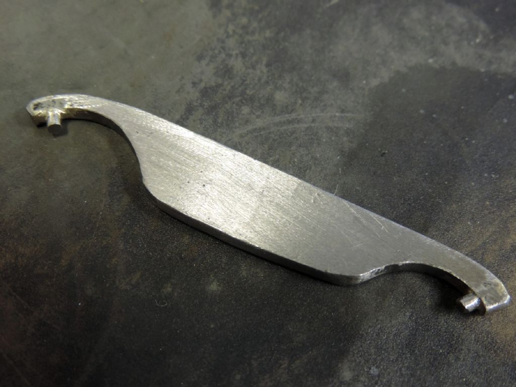

                    Cut out the body of the spanner and fit metal pegs that are just a TINY bit smaller than the body, silver soldered in place. The round bits were cut out with a step drill and then filed to shape by eye.
