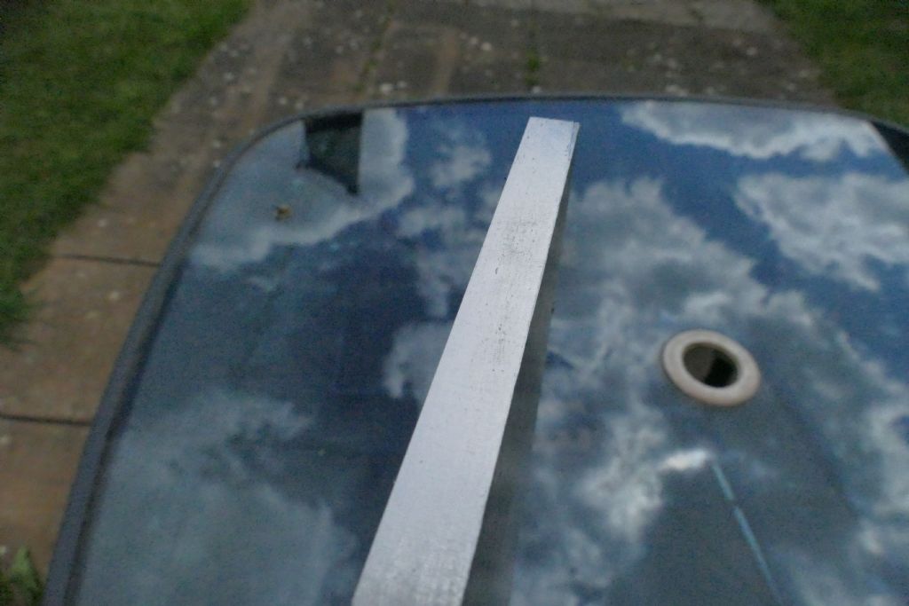

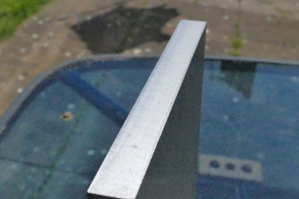

                      This is the maximum runout on the inside taper of the ER25 collet holder (not the spindle):
                      Call it 0.02mm?
                      Again, I tried side milling. This is the setup – everything tapped down and tightened:
                      Again, the result of a 0.1mm cut is akin to a very loud tuning fork. The vibration/chatter results in a swirly pattern on the workpiece (not too obvious here TBH):
                      This sample was marked "unhardened tool steel", and was fine for face milling, drilling, fly cutting etc.
                      Anything deeper than 0.1mm is unbearable – at least for anyone with a shred of mechanical sympathy.
                      Anything less than 0.1mm and I might as well use sandaper.
                      I'm wondering now if I've somehow changed the resonant frequency of the column by shimming it. To be fair, the shims are pretty narrow, and some are just in the corners. The deflection under hand load doesn't seem excessive compared with what other folks have said though. Then again I'm running out of ideas.

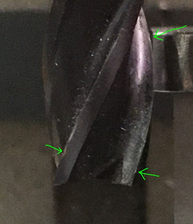

                          I very much doubt the problem is anything to do with resonance. Chatter is all to do with the cutting process, not the resonant frequencies of the machine tool. Chatter does not imply resonance of the tool or workpiece, but unstable cutting conditions.
                          I'd agree with JasonB. The cutter looks blunt to me. A shallow cut with conventional milling on unknown material with a blunt cutter will almost certainly lead to rubbing and then cutting, and back to rubbing. A slow feedrate will make matters worse.

                            Posted by Dr_GMJN on 14/05/2020 22:42:34:
                            So, just to be clear: The set-up in the first picture produced the result in the second picture
                            … isthat correct ?
                            If so [and noting Andrew’s expert comment on the standard cutting behaviour], I agree that flexibility of the column mounting could be a contributing factor … in addition to cutter sharpness & quality, speed & feed, and many more.

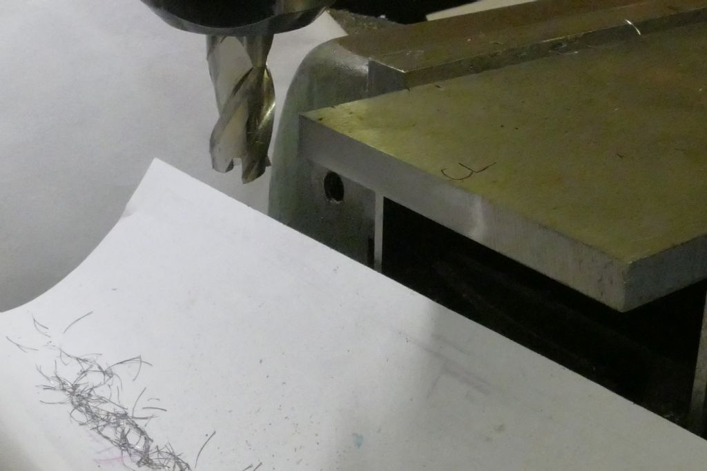

                              If the debris on the table is what is coming off when cutting then you are feeding far too slowly. You should be getting long shavings from each flute on each revolution of the cutter. At about 0.125mm per flute with a 4 flute cutter that is 0.5mm per revolution. For 50mm of travel that is only 100 revolutions. At 1000rpm that works out at 6 seconds to travel 50mm to give the correct feed to cut not rub. These figures are picked for simple numbers for an example but should give some indication of how fast to turn the wheels to get a cutting action.
                              Shallow cuts with conventional milling are also problematic, you are trying to remove material with a starting depth of cut of zero. The chip also snaps off at the end of the cut and as a result can damage the cutting edge. This is guaranteed to start each cut with a rubbing rather than a cutting action which is why climb milling often gives a better finish and is always kinder to the cutting edge. Climb milling starts with a cut and ends with the zero thickness.
                              So trying to do a shallow edge cut with too slow a feed on a machine which may not be easy to do climb milling on leaves you in a dilemma. I would try pinching the gibs not enough to lock the machine but enough to give resistance to movement whilst still allowing you to turn the handwheel and try a cut using climb milling with a suitable feed rate and a small depth of cut, maybe 0.1mm.

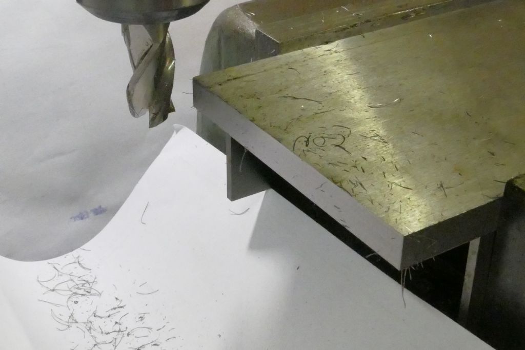

                                    Tried again with the suggested changes.
                                    No change though in noise and vibration. If anything the ploughed field effect is slightly worse.
                                    I'm increasingly thinking it's a stiffness issue, so I will remove my column shims and repeat the test.
                                    BTW it's a 12mm diameter cutter.

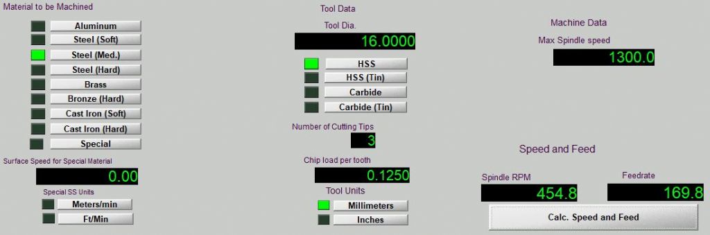

                                      The chips are looking as they should.
                                      I have done a quick experiment to see if I could see any difference between climb and conventional milling. This was done on a piece of 10x100mm gauge plate using a 16mm 3 flute M42 cutter with no name but says made in England on it. I used the Mach3 Mill speeds and feeds wizard to get recommended speeds and feeds. Depth of cut was 0.1mm and tooth load was 0.125mm. The result was that there is no real visible difference but the conventional milling finish was a bit rough as in it felt torn. It also had a slightly bigger burr on the top edge. The roughness felt like it would come off with a bit of rubbing with Scotchbrite.
                                      Milling wizard page.
                                      Climb milling in progress
                                      Climb milling result
                                      Conventional milling in progress
                                      Conventional milling result
                                      The swarf slivers are about 15mm long. The mill is a CNC mod on a round column RF45 type machine. You have to look closely to see the machined surface. The work took about 35 seconds to complete each pass.

                                        Taking Martin's cutting speed that would equate to approx 630rpm for your 12mm cutter which would be worth trying as it looks like you have th emachine set at around 1200rpm.

                                            Dr_GMJN
                                              @dr_gmjn
                                              This is with the lower spindle speed – it was worse than with the higher speed:

                                                      I'd also suggest a sharp cutter, that one has several chips out of the edges
