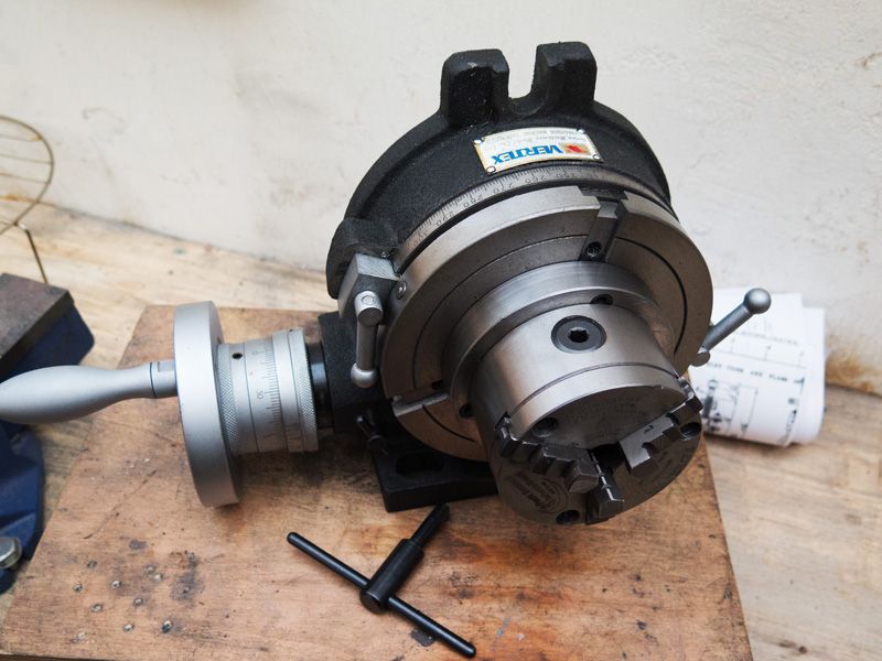

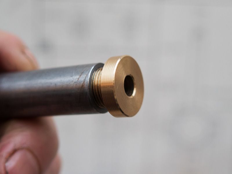

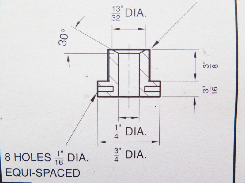

      I have to make the following part.
      I have done so without issue and made a little threaded mandrill to hold it.
      But I now have to (as per the drawing) drill 8 1/16th holes in the rascal around the outside of it's flange.

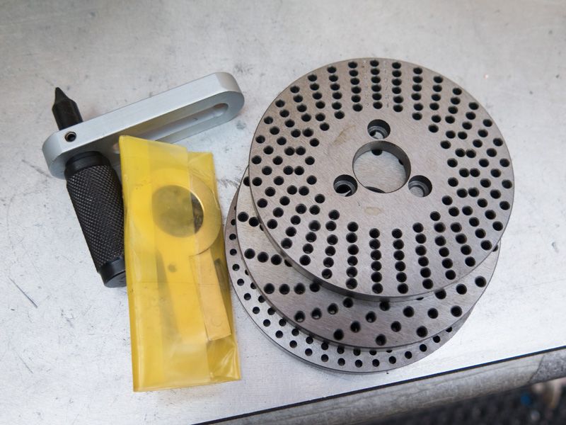

      I have a rotary table that I bought a few months ago and have fitted a spare chuck to it.
      At the same time I bought the rotary table I also ordered a set of indexing plates.
      So all should be good and what's his problem I hear you cry. laugh
      The problem is I have no idea how to use the plates, which plate and number of holes and the maths involved. blush
      I do realise that the angle between each hole is 45 degs and I could simply use the graduations on the table. Especially in this case as it's non-critical. But I would like to know how to use the kit.

              Nick,
              This is a very simple indexing job not really requiring the use of division plates. Just note the first hole position ( zero if you can arrange it) and then turn the table handle through 45 degrees for each successive hole, remembering the lock the table each time before drilling.

                            Your Rotary Table looks like my Vertex HV6.
                            The Handbook that comes with it contains a parts list, and brief instructions on how to use it for dividing, and a table, (Inside the back cover), giving the Plates to use and the number of turns and holes, for each set of divisions, upto 99.
                            But not all division numbers are available (such as 28,51,52,53,59,61,64,67,68,71,73,76,77, 79,83,84,85,88,89,91,92,and 97)
                            Mine has a 90:1 worm/wheel ratio, so for 8 equally spaced holes the table gives
                            ' A' plate, 20 hole circle, (The outermost one in this case) 11 turns and 2 holes of the crank handle, between each drilled hole.
                            If you have not got the "Operation and Service Manual" for the table, send me a PM, and I'll see what I can do to help.
                            Are you UK based, if so, whereabouts?
                            A recent tip was to make up two pegs to be a good fit in the holes, and short enough to be clear of the peg in the handle, as it rotates, to fit BEHIND the fingers, so that if you catch the fingers while turning the handle, they do not move to lose your starting position. As you need to move the fingers round, the pegs are moved to retain their position. (Obviously, make sure that the screw clamping the two fingers together is tight)
                            I've just done this, and it is useful.
                            Howard
