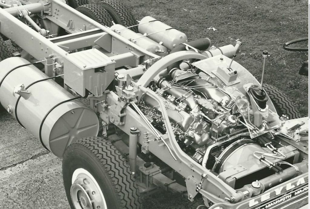

                An AEC V8 mammoth major 6, already started on the engine and thanks to a generous member on here i have the material for the camshaft safely tucked away.
                The drawings are ongoing as will be seen as i go through my list of 'how do i do this?''

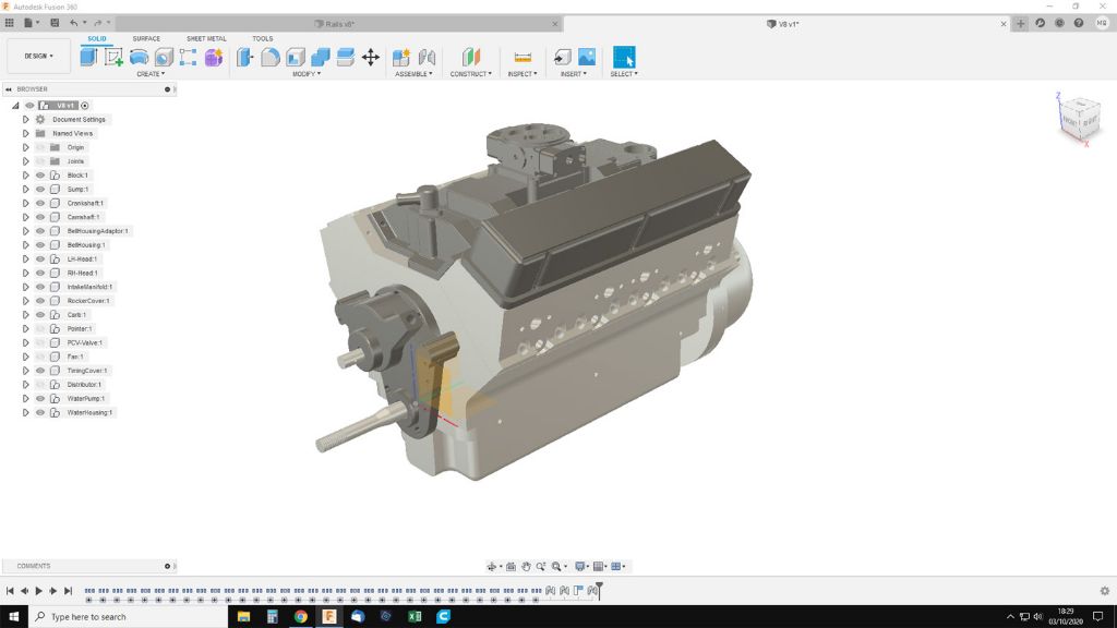

                        This morning in case, i printed a v8 engine block with a view to using it as a template for preparation of the chassis position etc for engine mounts, trouble is, in my haste to get the pva out i put too hot water on it and it warped. It now sits in the bin and off we go to set another on its way.

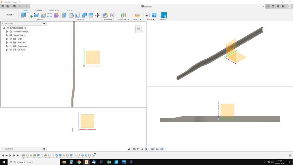

                                          Jon, i want to start with a chassis frame, this way i can add to the main part, trouble is if i get the dimensions wrong of this then the rest will never fit
                                          It seemed a simple part until i found the layout of it. I dont suppose it will do no harm to start here
                                          Picture of my drawing and the other picture with permission of Richard Staines brochure collection.
                                          The rail i was originally going to use Ali channel, but now i am thinking Steel but its the profile making that i need to get around as mentioned a bit earlier

                                            Delighted to see you speak Fusion360 Bernie!
                                            Just to get the ball rolling because I'm no expert:
                                            Is the problem making the U channel, putting the crank in it and/or working out how long the unbent channel needs to be?
                                            • If not available from the plan, I'd get the length of the unbent channel by bending a bit of thickish copper wire to fit the plan, then straighten it out and measure it, scaling as necessary.
                                            • I'd mill the straight U channel from solid mild-steel. (Full size would have been rolled, but that's too hard.)
                                            • Mild steel can be bent, I'm on thin ice here but in the absence of better advice I suggest making a jig consisting of suitably hefty removable pins let into a strong plate. Mild steel bends easily at red-heat, so the straight channel is warmed at the bend point, then plonked into the jig and worked around each pin in turn until the crank is done. I'd notch the channel edges so they don't buckle at the bends. Body fill the notches if strength doesn't matter at all, silver solder is good for strong models, safety critical should be welded.
                                            If you have Fusion, the whole bus could be modelled and assembled in CAD to confirm dimensions, holes and joints etc. Not necessary to model every little detail because most designs have a limited number of key points that have to be accurate, then everything else relates to them. Be great if a loco modeller would describe how they do this sort of work rather than me mislead you by guessing.

                                              Two thoughts on chassis rails making for vehicle models:
                                              1. for smaller scale frame rails a flat rail shape could be cut out and strips welded or soldered on to form the rail
                                              2. for larger scale frame rails, a "buck" or form could be cut out of heavy steel to the inside dimension of the rail, then oversize sheet steel / brass / copper clamped to it and formed down into rails with hammering by dead blow or rawhide hammers. The sheet would need to be annealed several times to be formed without cracking. Afterward the rail height could be filed back or round back with a Dremel type rotary tool. This method is like the process used for steam boiler flanged plates.
                                              There are some books by a guy called Mr Gerald Wingrove that show the best car modeling and techniques I have ever seen. Well worth a look if you can find them. There used to be a website, worth a Google.
                                              Just food for thought. Cut some metal, have a go. It is a great way to relax no matter if the results that day are great or go in the bin.

                                                Yes as a treat i purchased the 3 yr offer, its only fair i have had it free for years and i want to produce the model start to end with Fusion.
                                                The engine is a steve hucks v8 and i am 3d printing practise parts to ensure they fit as an assembly
                                                i have the materials to start your method and i find it very interest approach.
                                                I also like Jeffs approach and may tackle this method and especially as i have the 2 Gerald Wingrove books to refer to now i shall indeed have something to study tonight.
