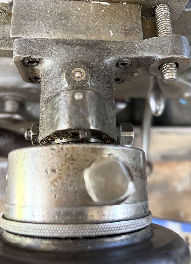

I like the system fitted to my P&W Model B 12 x 30. Basically the cross slide dial and feed screw thrust bearings carrier connects to the slide proper via a short, very coarse, male thread. Turning the whole boss through 90° gives plenty of movement to clear any normal thread depth. Form memory approaching 1/4″. Bound to be two start thread. But it’s big lathe. Probably rather less movement would do on a smaller machine so a single start thread could work. In principle easily made. Needs some form of lock to hold the moving boss in the forward position for normal work.
The P&W also has provision for a threaded rod on the cross-slide to act as a forward travel stop using a pair of setting nuts. Essentially same idea as the SouthBend threading stop but operate over the full cross slide travel range. handy if you have number of components to do.
I’ll take some pictures tomorrow.

Pictures of the P&W system as promised.
Normal turning set up, note the stop on the main dial collar engaging with the stop on the slide assembly.

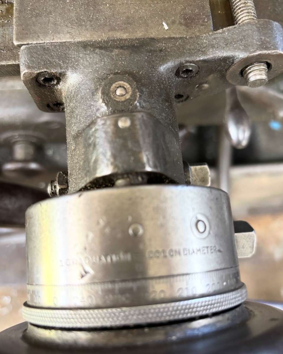

Retracted
Approximately 90° rotation giving approaching 0.2 inches retraction, less at first due to backlash. So the quick screw is 2.5 TPI. I reckon anything up to around 3/4 of a turn is acceptable with this form of retractor. So 5 TPI (ish) would be fine on a smaller machine.
The stop on the collar is now out of sight having rotated away from the stop on the slide assembly.
Square headed bolt on the slide assembly locks the retraction device, Square headed bolt on the feed system collar locks the feed screw preventing inadvertent alteration of the feed setting when retracting.
The threaded rod for the stop adjustments can also be seen. There is a locking device on the moving part of the ross slide that can be released to pull out or push in the rod to roughly set things. Add a locked pair of nuts as appropriate to make the settings by contacting the casting around the hole. Normally teh rod is left fully retracted to keep it put of the way.
A single tooth dog clutch retains feed position on disengagement and re-engagement but you still have to do retraction manually before reversing. The P&W has a big lever on the carriage to select feed direction and adjustable stops to set disengagement position in both directions. Frankly I never use the tailstock end stop. Easier to just haul the lever when the tool is clear. The P&W is a bit idiosyncratic in that teh whole operating philosophy is built around the single tooth clutch.
