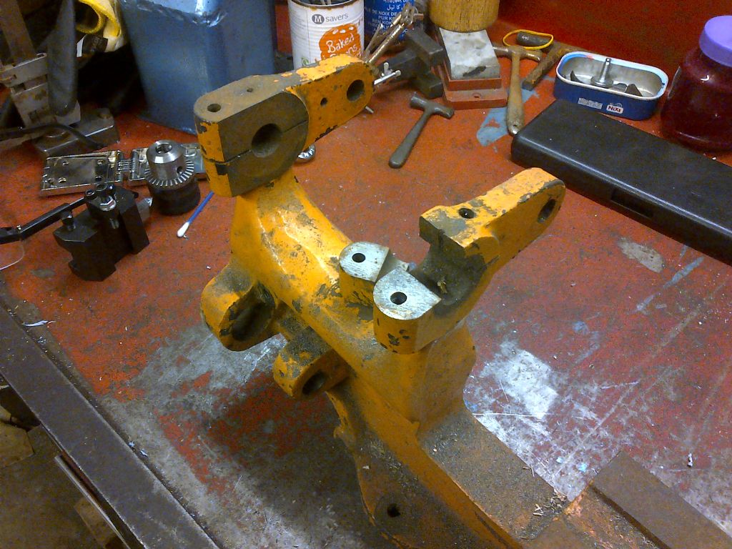

      been given box of bits of what appears to be a portass clone screwcutting lathe.
      headstock casting is broken.
      i have 2 options.
      1 repair it and get it bored so spindle ( which is missing ) runs true.
      2 box it up until more skilled at machining and then mill full headstock
      area flat and scratchbuild new headstock.
      after reading post on building adept size lathe i like option 2.
      there is no rush to do it as got several dozen projects on go.
      your thoughts and suggestions please.

          Hi naughtyboy,
          If it were me I would try to repair it so as to keep it as original as possible, that is if the broken off piece can be welded / brazed back on. Rebuilding a new headstock would be a much bigger project I think.
          Ed.

            I would bolt on an inverted u piece and rebore the bearings.

                I have an almost identical Portass Model "S". And interestingly(?) it also has the same fracture. Unless I have a special Rolls-Royce version(??) the headstock spindle sits in split bronze bushes (single slit, similar to the headstock) and as they wear, you tighten up the clamp until it breaks….
                The solution on my machine was simply to fit a steel strap across the fracture to hold the broken piece in place. The previous owner had done this very carefully using 4 (square headed!) bolts. I saw no need to try to improve on that.
                Presumably you will be making brand new bushes for this. Obviously, as the bush wear was the root cause of the problem, you will need to. However, even having worn the original bush out, my spindle is still original and un-reground.
                It would be possible to regrind the spindle but then the pulley and bull gear would need to be bushed out which would cause the scope of work to balloon. As it's a split bush, you can still persuade it onto the spindle with care and keep the work to a minimum.
                The repair I described worked fine for my Portass. The clamp still adjusts the bearing adequately and there is sufficient strength in the bush itself to cope.

                  Headstock casting cracking of just this sort was a common fate of Myford M1 to ML4 lathes which had headstock edjustment of similar type with a single split to the bearing housings at each end of the spindle..
                  The risk can be reduced a lot by closing the gap down onto a suitable thickness of washer, trapped in the slit, so that when the bolt is tightened it closes down onto a 'solid' surface.
                  Brazing the broken casting withh SIF Bronze is the way ahead and for a big lump like that, it will be best accomplished by two torches, one to provide a level of pre-heat to warm up the whole headstock end and the second, with a more intense flame to run the braze into the break. Bolt the broken piece in position with a suitable packer to hold it in place while the brazing goes ahead.
                  Slow cooling afterwards should help stress relieve it all and prevent cracking elsewhere.

                    Provided the break in the cast iron is clean and not damaged it is possible to pull the two halves back together by using a pair of long socket screws positioned horizontally, the broken part has to be positioned accurately and the drilling carried out very accurately on a milling machine. This method is the same as the the big end of con rods in some modern engines are made and assembled, the con rod cap is deliberately broken ,during manufacture ,.the joint kept clean and undamaged the shell bearings are assembled the cap fitted and the big end bolts tightened. The "broken " joint between cap and conrod fits very closely and forms a very positive joint . I repaired a broken bearing cap on a vintage open crank engine by this method and it has held together and worked very well for 30 years.

                        My only reservation in this salvage would be from flexing of the joint later across the two bolts since that section will be in cantilever.
                        Maybe a belt and braces approach might be better here with brazing into a vee groove on three sides around the break edges, using the two horizontal bolts to clamp everything together in register for the brazing. The joint faces will be newly made and any corrosion on the broken faces may be safely ignored

                              I presume you would drill in from the broken piece to the main casting horizontally or at an angle and use high tensile hex bolts
                              Don't forget that if you can find a decent welder, welding may be an option

                                      How about packing the adjustment gap to the correct height and pinning and epoxying both sides of the broken piece to the main casting. Instead of plain pins you could deep drill, tap and counterbore the holes for a number of small cap screws then epoxy or Loctite the screws in place. I would turn up a temporary plug (well waxed) to keep everything aligned while the epoxy and Loctite cured.
                                      Clearly there is no means of adjustment after solid pinning, If you turned up a nice tapered bore flanged bronze bushing and set that in the hole together with your newly made spindle with a taper to match you would have a better setup than original and it would be hidden from view. I would fill the set screw counterbores with body filler and paint over them.

                                        I'd go with Nigel McBurneys idea of two cap screws, properly placed the bearing housing will I think be stronger than the original. With some bearing housings like this, it is normal to pack the slot with shim brass sheets soldered together, and if you require to adjust the bearing, you take out the shims and tear one off, put the rest back in and tighten it up.
