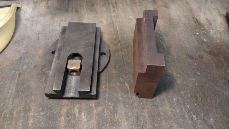

                    #281837
                    PaulR
                      @paulr
                      Here are the two bits but I'm not sure if the rusty fellow is actually a machine part – someone has filed a little bit off a corner, I'm guessing to see whether it's cast iron or steel. The one with the bit of brass attached is for a Clarke machine, it was sent to me in error when I ordered a mini-lathe part and they told me to keep it to avoid the cost of return post!
                      #283993
                      Tony Willis 1
                        @tonywillis1
                        You could turn the left one into a nice machine vice.

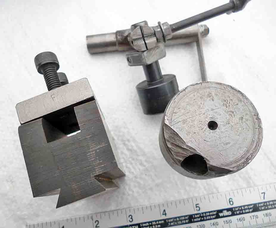

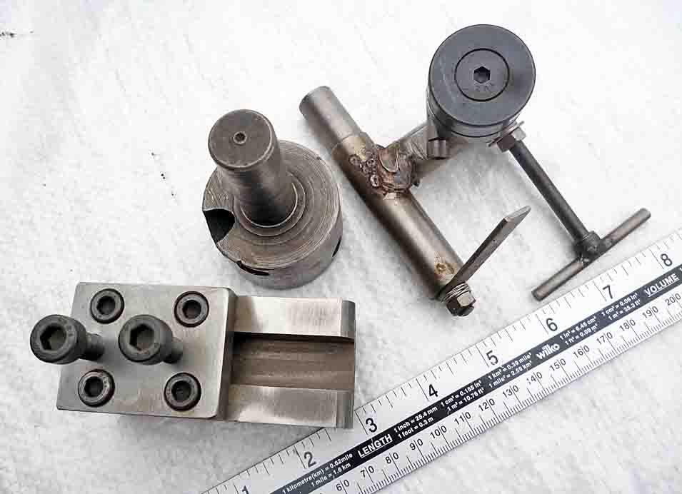

                        #284005
                        Martin King 2
                          @martinking2
                          Hi,
                          Got this small dovetaily thingy in one of my crates, might do for someone? PM if of interest.

                          #284041
                          PaulR
                            @paulr
                            Posted by Tony Willis 1 on 13/02/2017 16:43:02:
                            That would be nice but I don't have the equipment to make a mating part – can't see me milling that in the vertical slide laugh
