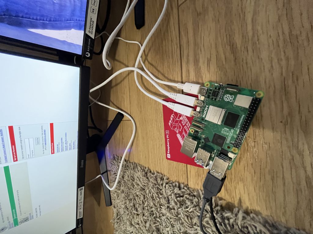

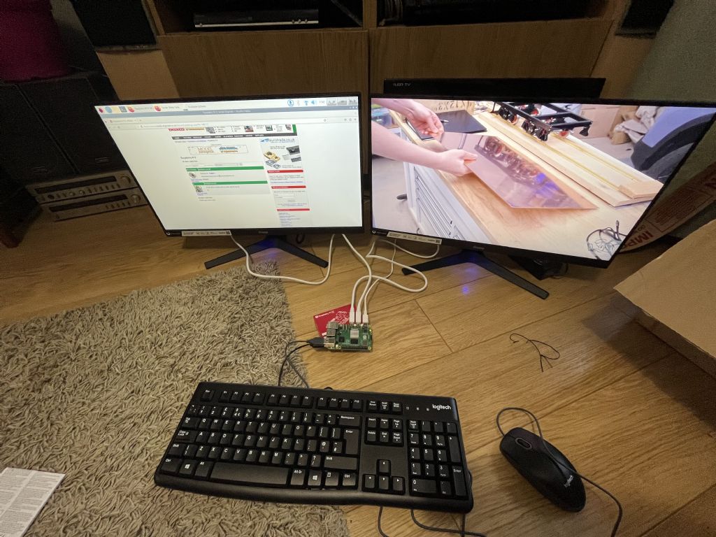

          It could almost compete with my twelve year old lap top.
          JA
          #661934
          Dave S
            @daves59043
            Its more like a 5 year old laptop really…
            Totally usable as a 'normal' computer.
            Also not many old laptops can do 2 screens at 4k/60, have 2 cameras and GPIO.
            I think this one is going to end up as the CNC controller for my CNC build.

                    Its the best Pi yet.
                    Would recommend getting the cooler or the dedicated case with fan in it – the CPU runs quite a bit hotter than the 4 – not dangerously so, but hot enough that I'll be adding a cooler once I get round to it.
                    It can also peak a lot of current from the PSU, so whilst the 3A supply for a Pi4 is fine (that's what I'm currently using) if you don't have a lot of things hanging off the USB etc the new supply is designed to support maximum performance. I will be buying (with my own money) one of those when they become available.
                    Seeing it run with a pair of cameras and 2 4k screens was impressive – I can see it being the basis for a Projector + cameras shape measurement system at 'fairly' low cost. (I used to do precision high speed large volume optical metrology at a previous job).
                    The PCIe connector is going to open up some interesting possibilities…
                    Interestingly the feature the Pi team seemed most pleased with was the power button…
