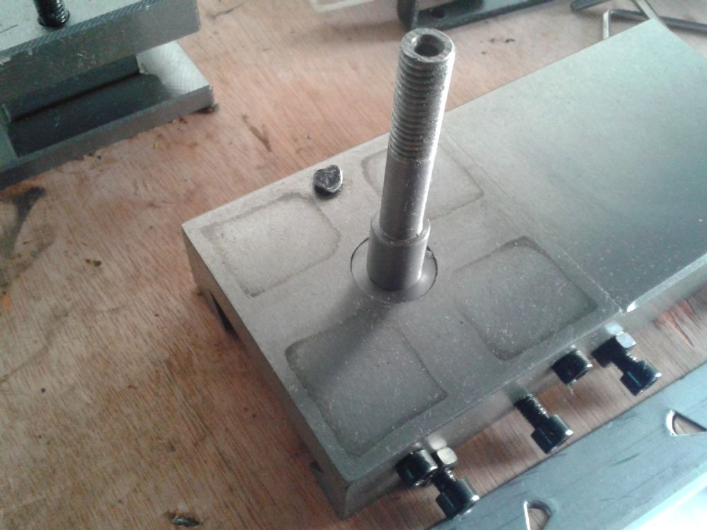

            I had read somewhere that to fit a qctp to the lathe you have to machine either the tool post or the top slide. I would prefer something which fits straight in. Machining the toolpost might be difficult if it's hardened and I'd rather not modify the slide in an irreversible way. I emailed ARC to ask if their qctp fits the warco wm280, but they have not tried on one, so they cannot say…Any ideas?

              I modified the slide by reducing the boss at the bottom of the threaded stud to fit my existing slightly too small (Dickson) tool post. Did it using a boring head on the external dia in the mill.
              You could ask someone like Chronos what size the counter bore in the bottom of their Boxford size dickson clone is and that is the bit that matters sizewise.

                I'm afraid I'll invalidate the warranty if I had to machine the boss off….is there a way to take the stud off the slide? I took the tool post off and it looks like the stud and boss are one part, but I can't take it off, for sure its not threaded in the slide as it won't budge. Maybe it's got a nut on the bottom side of the top slide?
                If I could take it off I could then either machine a new stud of use the one which comes with the QCTP (like ARC's wedge type has)
                Edited By ChrisB on 11/05/2017 13:50:38

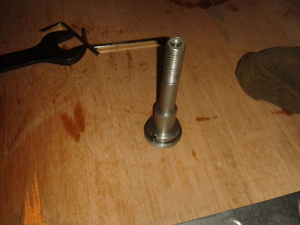

                  Chris, have a look here to see my version of fitting a QCTP to a WM250 I turned down the boss but there may be other ways of doing it. Some people have just machined the boss off on the mill.
                  Edit: the stud is pressed in with a roll pin to prevent it turning, it is only a light press fit so can be easity pushed out. There is a picture on the above link (No 26 on the second page) just shows the stud not the getting it out which is in the text.
                  Edited By Journeyman on 11/05/2017 14:09:19
                  #297632
                    To remove the slid eyou undo the two cap head screws either side of the handwheel and slide it towards the headstock
                    The boss is part of the casting, the pin knocks out easily enough with a copper hammer, you can see where I have reduced the dia of the top of the boss.

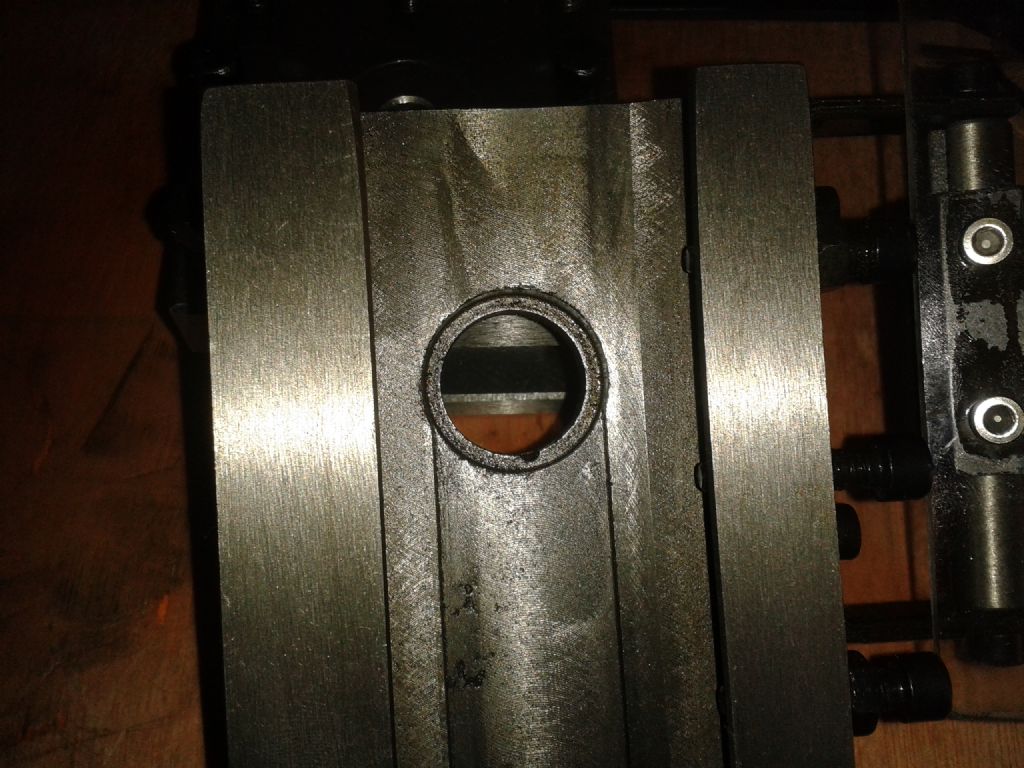

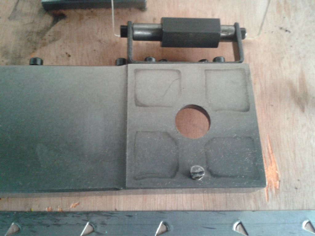

                      Thanks John and Jason, that was very helpful…so I took off the top slide (the pics came handy) and tapped the stud out, but it's not exactly as in the last pic. It came off with the boss and all and left a large hole. It's like a three stepped stud.
                      Will get some pic to explain myself better

                        That sounds promising if all you have left is a hole and a flat top to the top-slide, sounds like all you need to do is make a new stud to fit both the top-slide and the tool-post that you choosesmiley

                          This is what it looks like. So I guess it should be relatively easy to fit the tool-post. Probably will go for this **LINK**

                            I think you might need the larger model 100 version, check centre heights and maximum tool size etc. I have the model 100 on my WM 250 and your lathe is a bit bigger than mine. Also consider not getting the set, not all the tool holders are useful. Better just to buy the post and a load of standard holders. Ketan might do you a deal!
