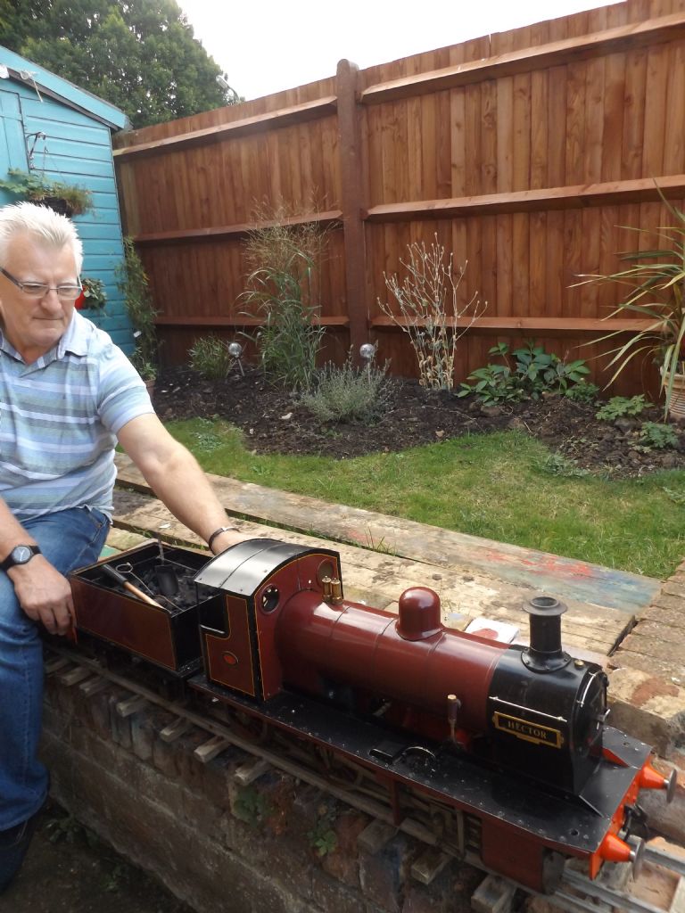

                                Ray Wood 3
                                  @raywood3
                                  Hi Greg
                                  I have an Ajax built by my uncle around 1970 it did good service back then its on its second boiler in 1993 now and extended into a 0-6-0 with a Railmotor tender. It was designed by Dick Simmonds from Erith and built and bits supplied by Fred Stone, long gone now but a popular design, simple workhorse, the Welling & District MES still have one for a club loco, the only critism of the boiler was its relatively deep fire box and can clinker up, but a good rake now and then stops that ! We still steam for the grandchildrens rides in the garden. In my view a good choice to build.
                                  Regards Ray

                                      #287951
                                      Ray Wood 3
                                        @raywood3
                                        Hi Greg
                                        This is the Ajax my uncle built in 1970, he then extended the frames plus an extra pair of drivers to create 0-6-0 and re-named the loco Hector to keep the theme. As you can see us happily steaming in the garden couple of other shots in the album. Regards Rayhector & kids oct 16 008.jpg
                                        #288195
                                        Greg H
                                          @gregh
                                          Hi Ray, that is different to what I was expecting. One thing about a free lance design is you can do it however you like.
                                          It must be nice to have a bit of track in the backyard.
                                          Greg
