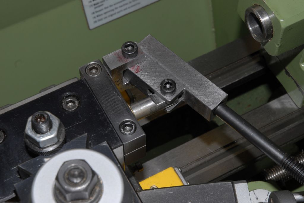

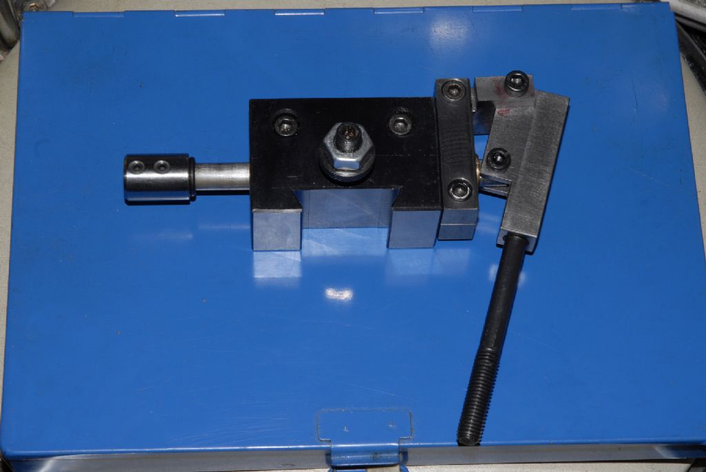

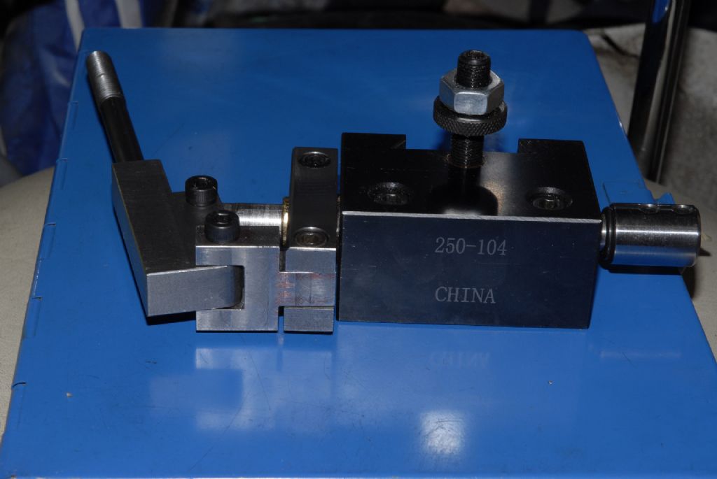

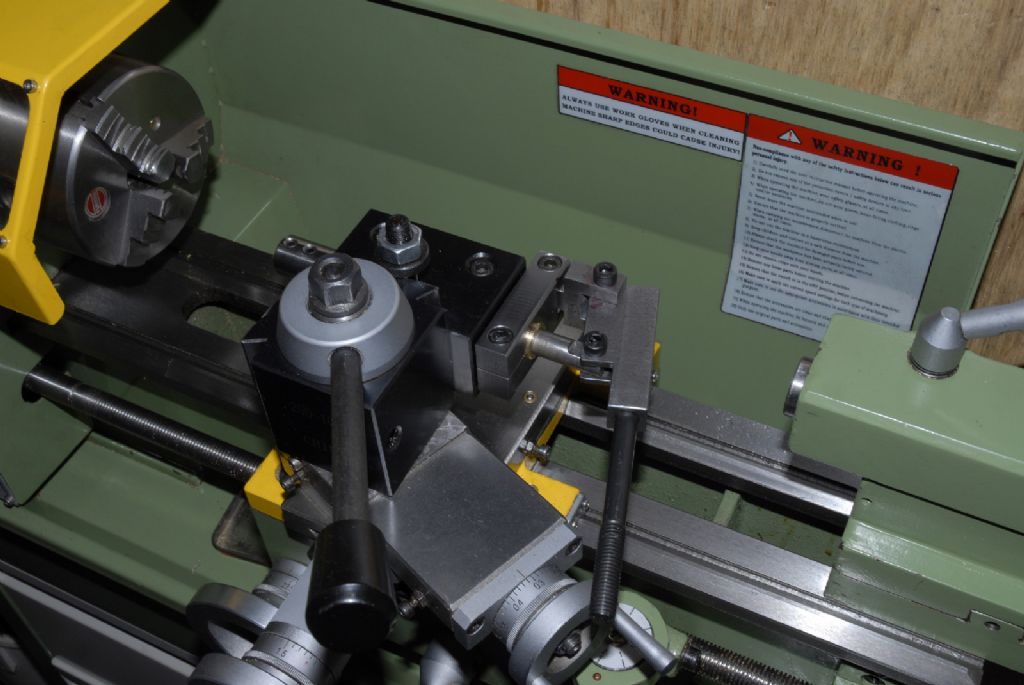

        The need for the tool came about because I am currently making some brass control knobs, each requiring an 18 tooth internal broached pattern. I have already cut a few of these with a hand ground cutting tool secured in a standard tool holder for the QCTP. This broaching method required winding the carriage handle on my WM-180 lathe back and fore several times per cut. Each cut is advanced about 0.05mm to a depth of 0.6mm. This was a lot of winding and I wanted a better way to do the broaching without inflicting excessive wear and tear on the lathe bed, rack and carriage winding shafts. Commercially available rotary broaches are very expensive!
        I have seen examples on the internet of a design fitted to lathe tailstocks using a lever for drilling operations and it occurred to me that I might be able to adapt an unused boring bar tool holder to do the same. The holder came with a QCTP set, model 250-100 purchased from ARC. The tool-post was adapted to fit the lathe and is not a standard item.
        So I needed to think of a way to attach a lever to the boring bar holder without drilling any holes into it and have some kind of shaft passing through it with a way to secure a tool bit in the end. A brass sleeve was turned to 20mm OD x 93mm long to pass through the main body of the boring bar holder and drilled through, initially 10mm but was not quite concentric for some reason so I had to increase the ID a little using an imperial drill. I have no reamers or a boring bar long enough, so a drilled hole is the best I can achieve for the moment.
        The sleeve was made long enough so that a combined clamp and integral pivot link could be secured onto it. This clamp link provides the first part of three linkages used to hold a lever and the tool-bit shaft passing through the brass sleeve. The tool-bit shaft was then turned to a very close sliding fit to the sleeve and brought to final dimension by polishing with emery paper.
        All linkages were milled and drilled on my milling machine. The linkages use standard M6 cap-head screws as pivots and work ok for the time being. The handle shaft is one of the T-slot hold down bolts used on my milling machine. I want to try out some of the different lengths of these bolts before making a final piece from bar stock.
        Here are some photos of the broaching tool which still requires some clean up and a handle:
