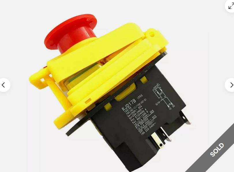

              #819973
                It does sound very much like a faulty NVR switch. I had to replace mine (WM280) earlier this year after 17yrs service. It started out by switching off while making a cut then eventually the green button would not hold in. Taking it apart showed overheating coil that had melted some of the surroundings and softened the springs.
                If you look at the sides or back of the old one it should have a part number, put that into google and ebay and you should find a direct replacement so the wires you have will all have somewhere to go.
                nvr
                As far as I am aware the old ones did not light up, if your new one has an indicator light then that may need sone different wiring which could be complicating the issue.

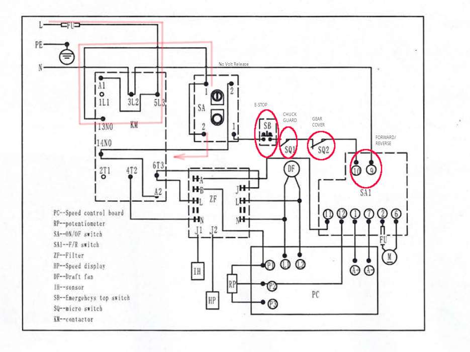

                    #819991
                      A couple of circuit diagrams may help.
                      1) From the manual.  I’ve marked the current flow and components to be checked in red.  Note these may not exactly match your lathe – they vary a bit,
                      w250circuit
                      Simplified:
                      w250safety
                      The fuse must be OK because the lathe runs when the NVR is pressed.
                      Pressing the NVR connects power to a relay inside the switch via the e-stop, chuck guard, gear cover interlocks and the Forward Reverse switch,
                      Not unusual for the NVR switch to fail, faulty relay coil or contacts.  Replace it, (already done)
                      Make sure the e-stop is released.  They usually lock when pressed, and are reactivated by turning the mushroom.  It has arrows on top.
                      The lathe won’t operate if the gear cover is off.  Not a switch in the ordinary sense.  A blade enters a slot,
                      I had trouble with my chuck guard switch.  Came loose and twisted so that moving the cover didn’t operate the switch.  Fixed by putting the switch back in place and re tightening.
                      Check all the wires are connected; they can vibrate loose.
                      If that doesn’t work, buy a multimeter and trace the circuit continuity end to end.  The lathe won’t start unless all the safety switches are close open, or if a wire isn’t connected.  The symptoms are as described.
                      It will be easy enough to fix once the fault is identified.  Judging by the lack of complaints, unlikely to be the F/R switch.

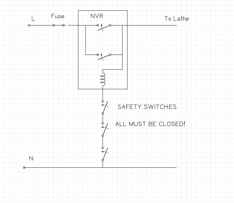

                          #820023
                          Robert Atkinson 2
                            @robertatkinson2
                            SOD.
                            In your simplified sketch you have two normally open contacts in parallel in the NVR. I think one (the stop) should be normally closed and in series with the coil.
                            Robert.

                                May not matter much, because the NVR has already been replaced, and a new one is unlikely to be faulty.  We hope!   So the exactly  how the relay is wired to latch power-on is irrelevant to Joner1.
                                As fitting a new NVR didn’t help, the issue is more likely to be in the chain of safety switches, which is much the same in this family of lathes whether fitted with DC Motors or 3-phase/VFD.
                                Would be useful for Robert to post the alternative NVR circuit though.
                                Since the lathe runs when the NVR is held down manually, we know the fuse, contactor, motor and electronic speed controller are all OK.  So the fault is most likely in the easy to fix switches and wiring, not the costly parts.
                                Be nice if Joner found the problem was simply the e-stop locked down, waiting to be manually released:  still catches me out occasionally and I have a bad habit of assuming any fault must be the worst possible.   Have to stop myself turning on a soldering iron and replacing all the mosfets!  Last time my lathe wouldn’t start, I did my ‘don’t assume anything’ routine and found it was switched off at the workbench.   As the workshop has a master-switch I never turn-off at the bench… Except I must have, blush.

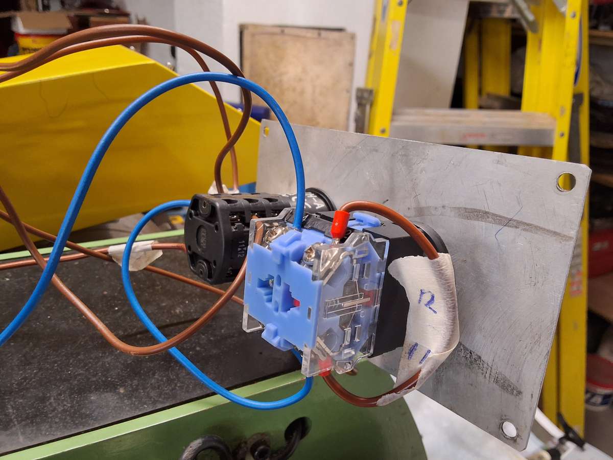

                                      #820273
                                      joner 1
                                        @joner-1
                                        20251012_135717
                                        #820275
                                        joner 1
                                          @joner-1
                                          Hi I can’t seem to upload the picture of the old switch but they are different.the One in the picture is New the old one has no clear sides on it . Machine is 2017 if this helps got to slitly different diagrams for electrics 😕

                                            Is that an exact replacement for what was there?
                                            Make sure you have the latching version of the switch not momentary as a quick google suggests you can get them in either option.

                                                    #820366
                                                    joner 1
                                                      @joner-1
                                                      HI All it as in the forum site keeps saying the pic file is to big yet I took the pic one after the other. ill keep trying to post the old switch. But in the mean time I spoke  to werco seem to be trying to help a bit ??
                                                      They said that this is the new type replacement switch ,I asked does it need to be wired different or the same.
                                                      Later on werco called me back and suggested to wire the switch the other way round ? so I did the lathe runs after I twisted the stop button out and I never pressed any buttons . but I had to hold the red button in to stop the lathe .
