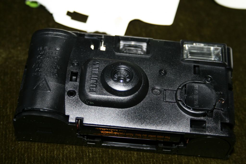

            surprise Would you believe what's sitting right next to me?laugh How freaky is that?
            I think it came out of a disposable camera…? I've got some more too in the attic I think !

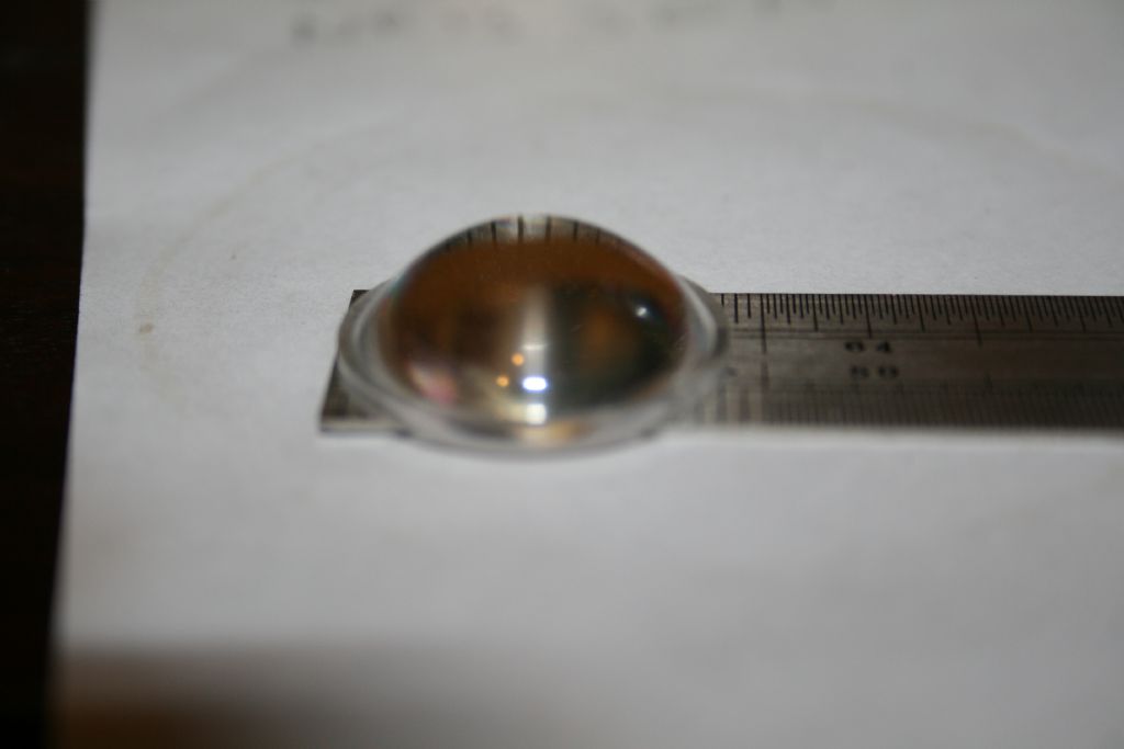

              #267466
                I have used the Acrylic rod and tube that Noggin End sell to make various bits. Machines easily and will polish up to glass clear with Micro-Mesh.
                The couple of lenses in the last two posts look far too domed, should really only be a slight crown more like a magnifying glass.
                I assume you are not using a naked flame as the light sourcesurprise

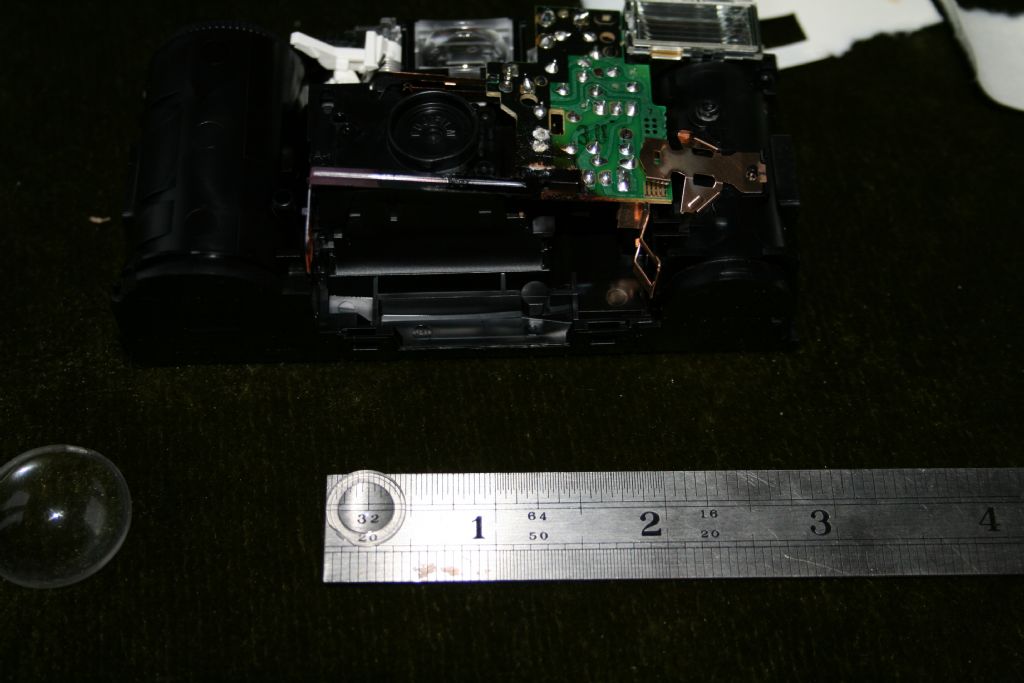

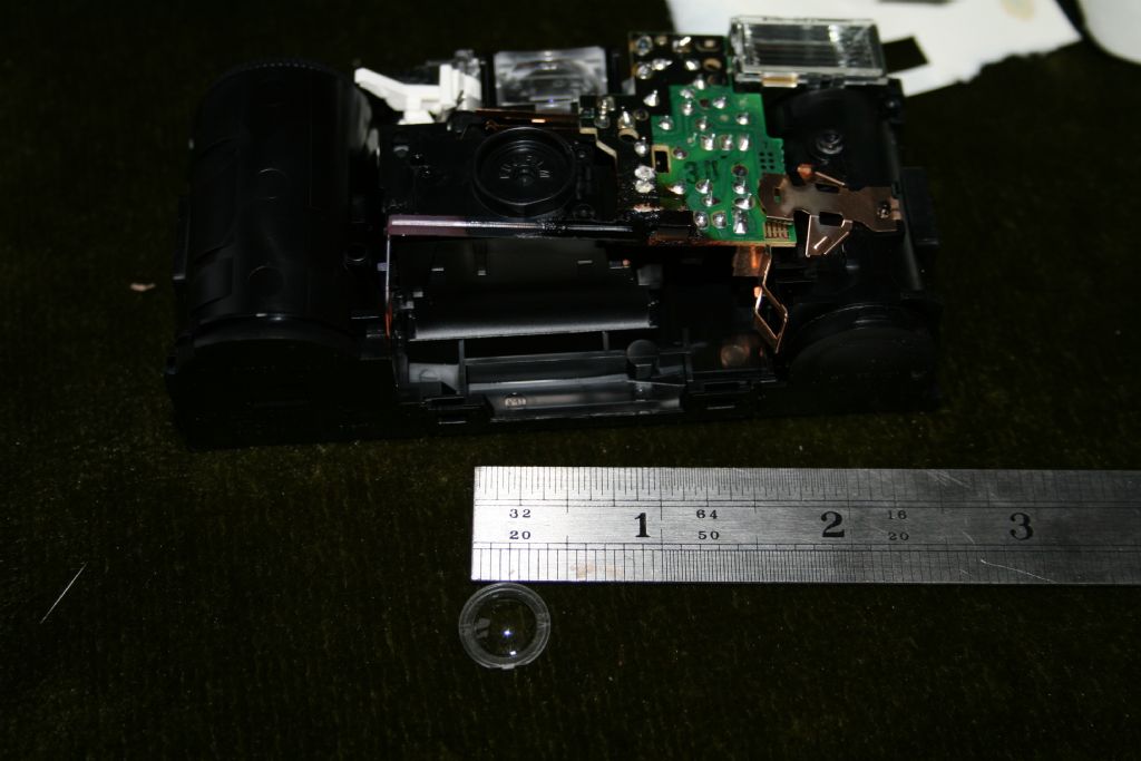

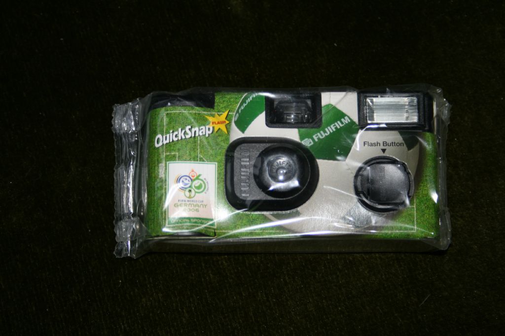

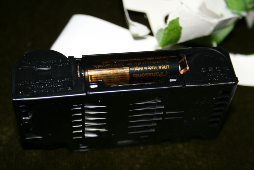

                #267474
                Hacksaw
                  @hacksaw
                  Bad news RRMBK sad
                  Only one camera left…but lets dissect it anyway..laugh
                  Reaps a free AA battery !
                  Oh dear ,the lens is not from a camera !!
                  Cripes , that capacitor gives you belt ….surprise
                  Sorry i don't know ,and nor does the family, where the bigger lens came from…maybe an LED torch that broke.
                  Edited By Hacksaw on 20/11/2016 10:14:51
