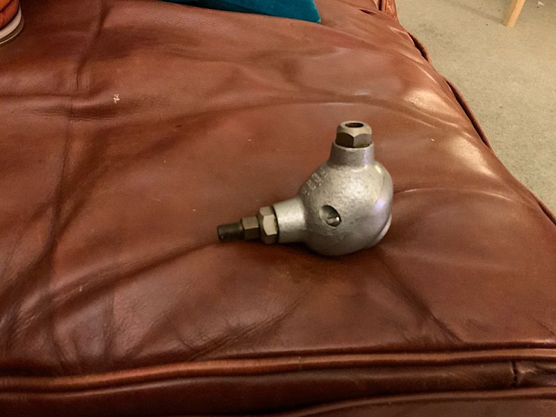

        What would you use these for?
        its a 2:1 or 1;2 depending on which end you drive…

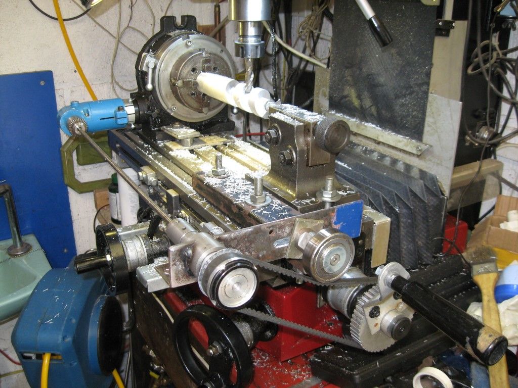

          They are useful for drilling in confined spaces such as drilling up into a studded wall from under the floorboards. I have also use a similar one as part of a setup to cut a helix on my milling machine.
          Les.
