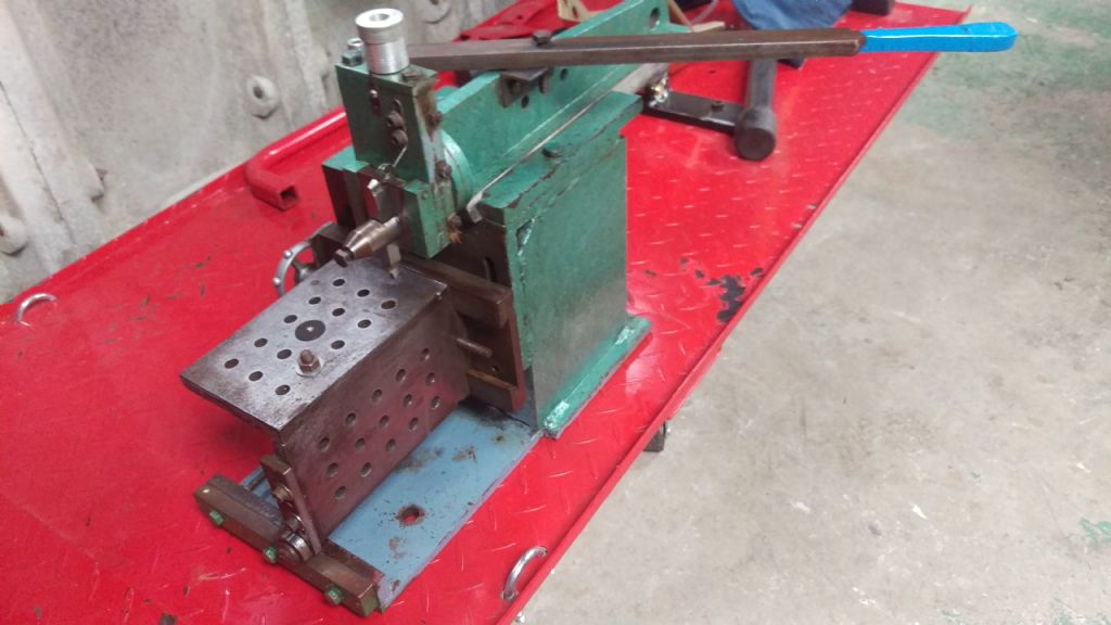

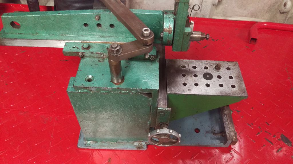

                                Here are a couple of pics:
                                Courtesy of Google, it might not be a perfect at all? Also is the limited lateral travel likely to be a pain?
                                #320328
                                  You can do a lot more with that than you might expect, it deserves the small space it will occupy for the day you need to do a difficult dovetail, gear or keyway.
                                  #320334
                                  Clive Brown 1
                                    @clivebrown1
                                    That doesn't look like a Perfecto machine. A feature of them was the gear quadrant and rack drive to the ram.
                                    Unusually, the major components appear to be fabricated, still, as said by others, should be a handy deviceI don't think the limited cross-travel will be a major drawback.

                                        NOT a Perfecto, but still worth hanging onto. The fixing points on the table will be very worthwhile.
                                        rgds
                                        Bill
