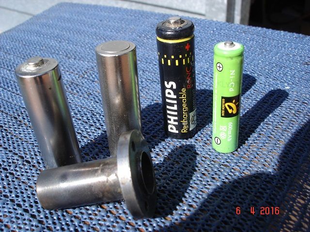

              Ian S C
                @iansc
                Also note Verdranger sehr feine Stahlwolle translates to steel wool, this is the displacer/regenerator. You don't have to use a test tube for the hot cap, this is best made from stainless steel, but ordinary mild steel will work. If you are lucky you might find that the steel case of a dead Nicad battery might fill the bill. The casing on the left is from an alkaline battery, the + tit is on the case.

                    Dave, I don't build to plans, but it should go, especially if proper bearings are used, I don't think these things are designed by anyone with engineering knowledge.
                    Apart from the fact that you can see the displacer moving, I'm not over fussed with the hot cap being made from a test tube. Also I prefer a hollow cylindrical displacer, I'v tried the steel wool, and find it more trouble than it's worth.
                    Rule one, minimum friction, and two, minimum leaks. It then should go.
