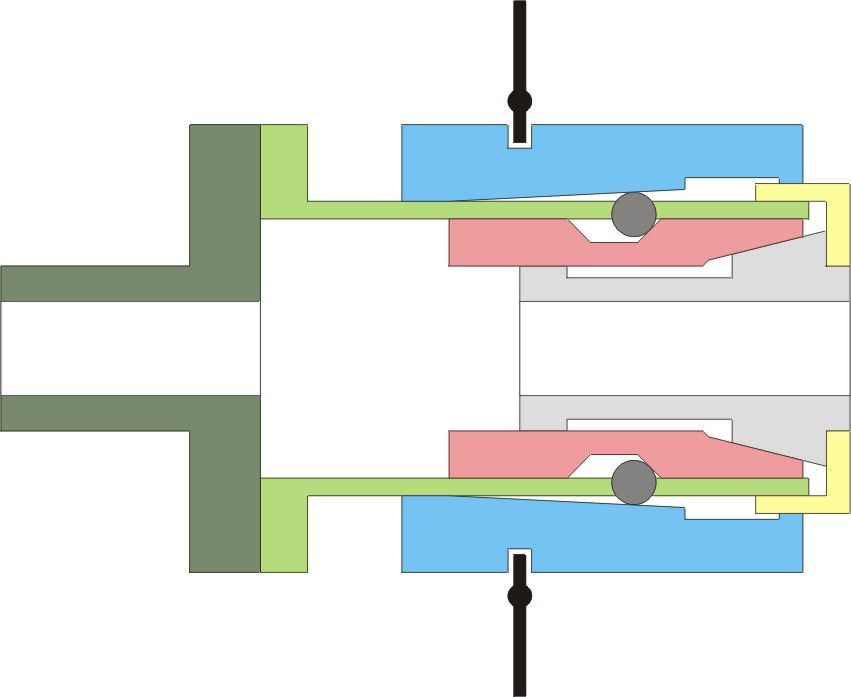

                                #619854
                                Chris Pearson 1
                                  @chrispearson1
                                  Posted by Andrew Johnston on 31/10/2022 21:23:07:
                                  The 163E series collets are dead length collets so intended for operation where speed of operation is paramount. As old mart says it should be lever one way clamps the work in the collet, lever the other way releases the work from the collet. During operation the collet should not move axially. It should be possible to clamp work, machine, release work and insert next workpiece without stopping the spindle.
                                  If the above isn't true then either something is missing, is misadjusted or is damaged.
                                  Thank you to everybody for your contributions – it has been a busy week and I did not expect so many after the lack of interest in my original posting.
                                  I am not sure how much use photographs would be because they do not show the innards. However, if push comes to shove, I could disassemble again.
                                  Instead of photos, here is a diagram, which is certainly not to scale, but I think does show the operation of the chuck.
                                  The dark green is the spindle and the light green is the fixed portion of the chuck. The collet (grey) is held in position by the closer (yellow) and if it is not moved, then clearly the collet remains in the same position. Operation of the lever (black) moves the blue sleeve to the right and the taper pushes the balls (6) inwards. This in turn moves the red sleeve to the right. 1 inch of movement in the blue sleeve results in about 50 thou of movement in the red sleeve, and perhaps 10 thou radially of the collet. So as the red sleeve is moved rightwards, the collet grips the workpiece.
                                  When the lever is moved to the left, the pressure on the balls is removed and the red sleeve is free to move to the left and release the workpiece. However, it seems fairly obvious, due to the taper, that springiness of the collet will not exert much force on the sleeve. Moreover, the red sleeve is a push fit in the light green one so there would have to be some positive force to move it to the left.
                                  I cannot see how the chuck could have been assembled wrongly and I do not see how anything could have gone missing. Whilst there are witness marks to show the force of the balls to the right, there are none to the left.
                                  Further contributions will be much appreciated.

                                  #619870
                                  Alan Donovan
                                    @alandonovan54394
                                    Hi. Chris.
                                    My request for a photo only needed to be an outside view, but your sectional view gives me the information that I need.
                                    I still feel that you are over tightening the closer. If the closer (yellow) is over tightened it pushes the collet (grey) further in to the collet housing (red) thus closing down the collet. Try slakening off the closer (say one eight of a turn at a time) and then closing, and then opening, the collet with the handle mechanism.
                                    I feel fairly confident you will come to a position where you can open and close the collet to load and unload your component without having to further adjust (unscrew) the closer to release the component. The handle mechanism will / should take up the additional slack in the collet and should still provide the necessary force to grip the component for machining.
                                    I hope this helps. Please let us know if this solves the problem.
                                    Best regards. Alan.
                                    #619936
                                    Chris Pearson 1
                                      @chrispearson1
                                      Alan, thank you. I have tried your suggestion, but unfortunately, it did not help.
                                      If the closer (which isn't really the closer) is too loose, the red sleeve will reach the end of its travel to the right without closing the collet. If it is too tight, the red and blue sleeves are pushed back to the limit of their travel to the left and the lever becomes fixed.
                                      The chuck works nicely for gripping the workpiece, but I can still not see any means of moving the red sleeve to the left.
                                      This is v. frustrating, but I was only using it to obtain the best possible concentricity for a grinding wheel arbor, so I think that I can live with it.
                                      I cannot even find operating instructions for any similar chuck. Surely there must be something out there!
                                      Edited By Chris Pearson 1 on 06/11/2022 12:43:28

                                        #620660
                                        Alan Donovan
                                          @alandonovan54394
                                          Hi Chris.
                                          Your collet chuck problem has been bugging me, so I am back with another possibility (maybe ? ?).
                                          You say the internal sleeve, that holds the collet (red in your diagram) ….. is a very firm push fit in the body. Is it possible that the internal sleeve has a couple on 'bruises' on the OD that is causing this tightness. I feel this should be very close fitting but a 'free sliding fit' in the main body. If there is slight bruise present causing tightness, this may be a contributory factor.
                                          Secondly, is there a circlip groove, in the bore at the nose end of the main body (green). If 'yes', then it may be a circlip has been lost / ommited. This circlip limits the forward movement of the internal sleeve and may make it possible to adjust the clamp / open setting of the collet correctly. If you look at the arrangement drawing of the Myford Collet assembly – as provided by Swarf, Mostly – there is a circlip fitted in this area to limit the movement of the internal sleeve.
                                          That's it. Alan.
                                          #622052
                                          Chris Pearson 1
                                            @chrispearson1
                                            Posted by Alan Donovan on 11/11/2022 16:17:49:
                                            Alan, thank you for giving the matter further thought. I was beginning to think upon similar lines so when I have some spare time, I shall strip it down again and try measuring with a micrometer. I rather doubt, however, that an ordinary micrometer would be precise enough, but we shall see.
                                            IIRC, there is no circlip groove.
