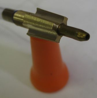

                I am another one of those trying to make a 'fogless' coolant dispenser… Not sure why, but am nevertheless persevering..
                And have spent 4 fruitless days with frustrating pump interludes.

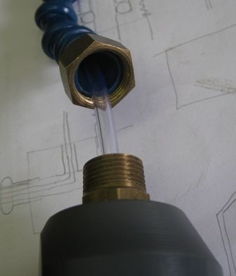

                PART-1 – the coolant applicator head – a magnetic base mount LOC-LINE head, fed with compressed air and coolant
                This is the base port with the coolant inlet fitted. the second hole take an identical fitting with air pressure. The brass fitting on the right is the loc-line mounting to the applicator nozzle.
                :base port -coolant inlet.jpg
                A burnt out JBL Tweeter was butchered for its rare-earth magnet – makes a very nice magnetic base mount.
                Magnetic base in place.
                The coolant inner flow tube ending at the nozzle.
                Coolant tube ending in the nozzle. The nozzle is a 1mm diameter orifice in a 3mm bras tube, connected to the feed hose. Surrounding the bras tube is a air bypass nozzle, allowing the compressed air to pass by, and carry the low-flow coolant to the job.

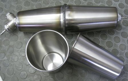

                  Part 2 – The Air Powered Coolant applicator..
                  The Saga continues-

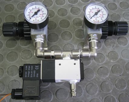

                  I started with a fully compressed air powered system. Main shop air feeds two air regulators, one set at about 3 to 5 bar, the other at around 1.5bar. The latter pressurises a coolant tank, which then pushes coolant out via a flow control needle valve, into a tube that is coaxially located inside a loc-line magnetic base assembly on the lathe carriage. The loc-line surrounding the coolant tube carries the higher pressure air flow, and mixes with the coolant at the nozzle, carrying droplets of coolant to the tool.
                  The coolant tank is made from 2 stainless steel camping tumblers, each about 500ml, tig welded together at their rims. At each end ( tumbler bottoms)  a threaded insert was silver soldered in to fit a pipe fitting at the bottom for coolant outlet, and at the top for air pressure inlet, and tank refilling.
                  A 12volt solenoid valve feeds both air regulators, cutting air to the the system, stopping the coolant flow
                  The coolant pressure tank
                  The solenoid valve and pressure regulators
                  The complete assembly – 100% proof obtainable from this when fired up!
                  It works very well, but is a real pain to stabilize. the coolant 'flow' rate is very sensitive to pressure, and the regulators do OK, but are just not good enough.  it is just simply to finicky – does not maintain the same coolant feed rate over 1 or 2 hours .

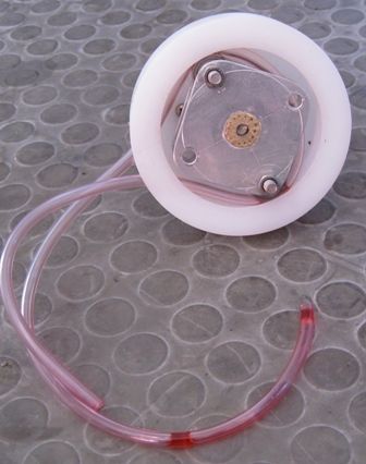

                    Part 3 – Peristaltic Pumps and others…
                    Since the problem lies with the control of coolant liquid feed, I felt a Peristaltic pump might work better.
                    An HDPE housing with 4 wide ball bearings attached to a crude holder were made.
                    This worked very well, but the hose is a problem. The one used is far to stiff and thick walled – silicon, readily available to me in various sizes, does not work with cutting oils, tygon is only available to me in thicker tubing, unsuitable for this application. It is difficult to get Butyl, Viton, etc tubing in Namibia, and purchasing abroad is equally difficult as I would like a half dozen varieties to try…Not sure what to do here…

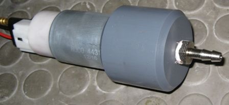

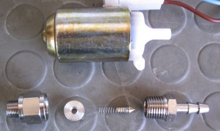

                    Then I lost my head and decide to try other pumps – a petrol fuel injection pump, for example.
                    I was able to get very low flow rates at about 2 volts, and a 10cm long stream at 5 volts. At low flow rates, since this was not a positive displacement pump, the flow would still vary hugely with pump or nozzle orientation.
                    Another useless exercise…
                    I tried a windscreen washer pump as well – I did expect this to be the worst since is has very poor flow performance, etc. A further issue is that the fuel flows back so freely through it that it syphons back to the holding tank, and the when you turn on coolant again, it takes forever for the coolant to exit the nozzle at the low flow rates
                    I even made up a non-return valve to prevent the syphon process – worked fine, but still has all the same problems of flow rate changing with nozzle height, ie, pump head affects the flow impossibly.
                    I still think the peristaltic pump is the answer, but the tubing…
                    And NO, I do not want to use a coolant sodden paint-brush, or a squirty bottle, or whatever..and I hate flooding-
                    I like the idea of a sort of no-fog lubricator, with variable compressed air to blow chips out of the way, but all the commercial systems I have played with have warts – flow rate is not deterministic at all, and I do not want to lose concentration of a fine machining job, trying to adjust the coolant flow because suddenly it is obscuring the job, or there is no coolant at a critical instant, etc.
