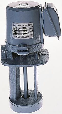

        #279331
        David George 1
          @davidgeorge1
          Hi this is the type of coolant pump which I would recommend but you would need to have a tank with lid to support said pump. They are available in various sizes depending on tank depth and volume you need to pump and they come in single and three phase electricity supply. they work regardless for many years with little attention. I personally wouldn't run a pump from a spindle motor as it is not good to run coolant at the same time if anything goes wrong i.e. forgot to turn the coolant tap off it would take your concentration off the spindle work which could be dangerous and you could get wet with coolant. You would also need a control circuit with a no volt safety built it to the circuit.

              #279811
              Mark Eisen
                @markeisen61287
                I am going to a washing machine pump, seen some good set ups on an Aussie forum.

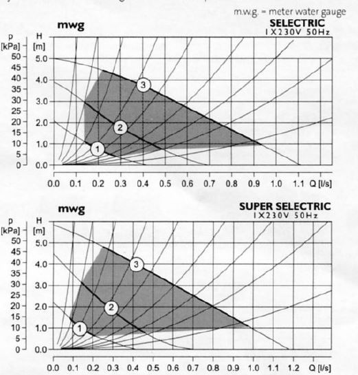

                                      #281851
                                      Muzzer
                                        @muzzer
                                        Central heating pumps are pretty rugged and silent, and can develop a fine pressure head (~5m) and a decent flow rate. They are also very simple centrifugal pumps and don't cost a lot, particularly if you find a used one. The main problem is that they don't self prime, so you need to mount them below the fluid level.
                                        This is a typical (Grundfos) performance characteristic:
                                              But CH pump motors have sleeve bearings that are lubricated by the pumped liquid, so would require pretty good inlet filtration to give reasonable bearing life.

                                                Muzzer
                                                  @muzzer
                                                  Posted by Nigel B on 02/02/2017 07:40:23:
                                                  Nigel B
                                                  You'd have to define "reasonable" for a pump that typically pumps rust and hot gritty sludge around a heating system on a near continual basis for years on end vs a hobby application that may only see a couple of hours a year. Most of the swarf and particles drop out into the tank quite rapidly. Other suggestions appear to have gears and seals that may not stand up very well. Gears in particular would seize up with little provocation.
                                                  Unless you want to buy the proper coolant pump, there are downsides to most of the alternatives. In the case of washing machine motors, they aren't generally enclosed mechanically or electrically.
