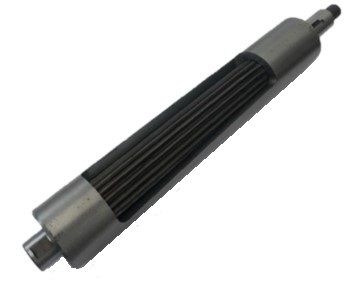

      Sadly whilst moving my super 7 it toppled over onto the gear box selector and broke the lever. I'm now struggling on how to remove it for replacement. I've taken the box of the lathe, the shaft is free but because the gear on the lever sits in the machined slot it won't come out. I can see a taper pin in the gear, but how do you get to it to either tap out or drill out. I've also removed the top selector gears to give more access but a loss. Help please.

            Thanks for your response, I do have both user guides, but although the diagrams show the components no explanation as to how to remove them sadly and Myford were no help. I'll willing add pictures, just not sure how, so any guidance taken.
            The only way I can see this pin could have gone in was with the shaft and gear in place, many, many years ago

                    Worked out , these show the broken selector and the pin from both ends

                              The taper pin seems to be in a through hole, not a blind one, so why can't you drift it out from the small end? Maybe take out the gear cluster shaft with the long key in it from the right hand end to get some more room. They put it together, so it must come apart!

                                Downside with that approach is there is a dam taper pin in that cluster as well and I so don't want to do that one as well. The challenge is holding the lever and the gear still whilst using my third hand to hit the drift with the hammer. Id love to know how Myford put them together.

                                    I'm wary of making a 'couldn't you just…' suggestion, but couldn't you just slide out the big shaft that the selector lever pivots on, and lift out the lever complete with that gear still attached?

                                      Ah, when i started the whole process I thought that was the plan, the bit that's not seen is the bottom of the sleeve is open, the shaft that goes through it is splined, the gear from the lever then meshes, the trouble is the gear overlaps the slot. Oh bugger was a couple of the words mentioned,

                                        These gearboxes are so beautifully made that I don't think any part needs much force to dismantle. Put the inner shaft with the long spline back and refit the input gear and use that gear to stop the pinned gear rotating. I think the pin In the gear cluster shaft will knock out easily.

                                          Does the pin align with the drain plug hole at all, to give clearance to knock it out?

                                            Hadn't thought of that, no need for 3 hands. I knew someone would have the answer. Ill keep you posted. Thanks

                                                  I've attached a picture I'd the shaft and the cut out from the myford site so you can understand the missing part of the removal challenge.

                                                      This the picture in the tube showing the challenge with the gear on the selector.
