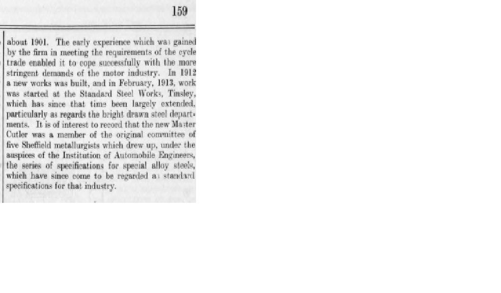

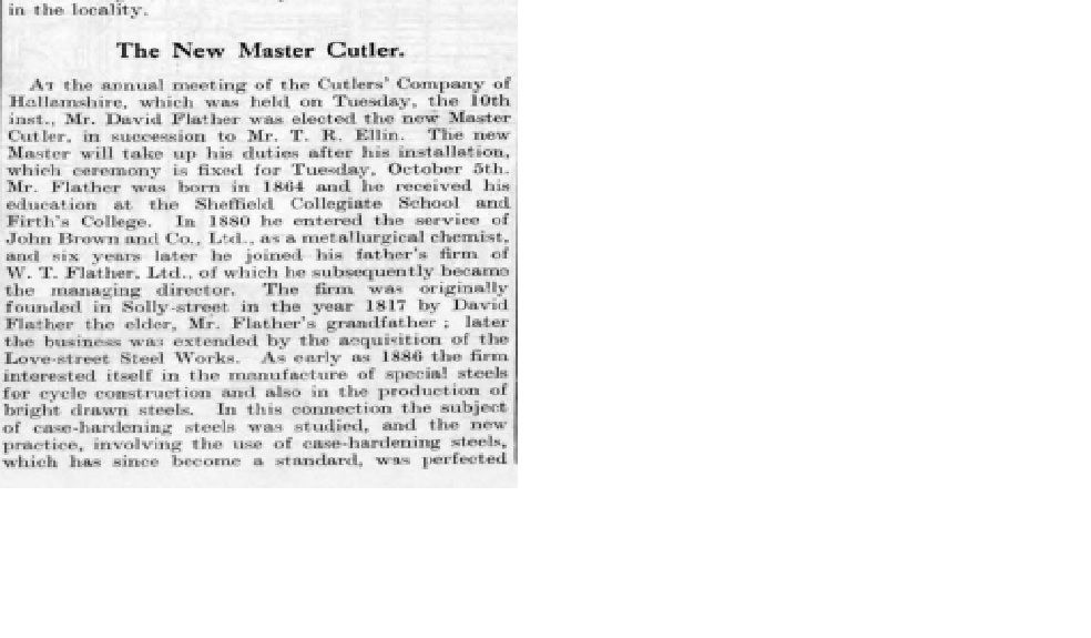

            I went down the silicon steel rabbit hole but ended up with this from Graces Guide:
            Looks like Silkase is a free machining case hardenable steel. EN1A would probably be OK but I would avoid leaded steel for case hardening. EN3B won't have such a nice surface finish but may be more reliable, not having the additions for free maching. You can work on the surface finish for a one off.

            Ady1
              @ady1
              Couldn't find a sausage in 200GB of text searching
              Had more luck with Flather
              Looks like they were sheffield alchemists connected with the bike trade
