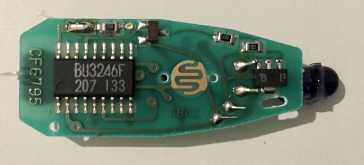

      This should have been easy … but I have failed to identify a small IC
      It is very clearly marked, and I know that the gadget is a little remote trigger for an Olympus camera … but my searches have failed to find a data-sheet for what I presume to be the code generator.
      The only reference I have found to BU3246F was a four-pin device !
      IMG_8992

        If you drop the ‘f’ (always worth trying as a last letter can be a batch or variant code) and search for BU3246 you get a tiny handful of results for online sellers…
        It’s available for sale:
        http://www.o2xygen.com/parts/BU3246.htm
        I’ve asked on the ‘I take pictures of electronic components’ Facebook group.

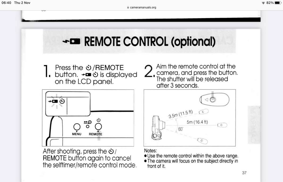

                        Just to put the thing in context:
                        http://t.hacquard.free.fr/site1/superzoom_en.html
                        Edit: __ and, with thanks to that nice Mr Butkus
                        https://www.cameramanuals.org/olympus_pdf/olympus_superzoom_3000.pdf

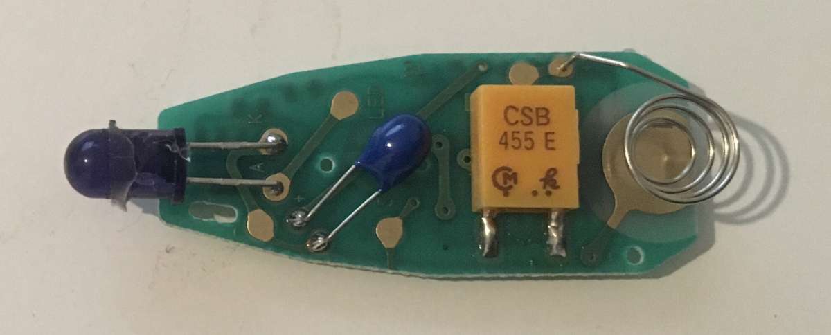

                              P.S. _ for anyone “remotely” interested … here’s the other side of the board, just prior to me inserting two new CR1220 cells.
                              IMG_9004

                                I have come across chips in the past where the output is simply coded by a set number of pins, with some fixed high or low to make up a simple binary number , e.g. 01001101 for 8 of the pins.
                                It’s a double sided circuit board, so it might be interesting to  see if some of the pins are just tied high/low.
                                I guess it could do with some sort of a spectrum analyser to read the embedded code in the IR light beam.

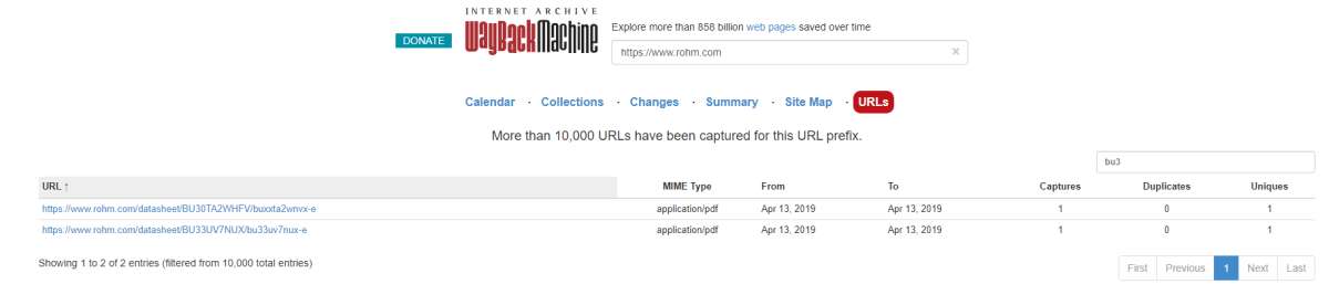

                                p.s. at least one link suggests that the chip was made by ROHM semiconductors so it might be worth dropping them a query
                                Also, I did try Arcgive.org, but out of 10K plus hits for Rohm, only two contained documents containing BU3, and neither were the right series of chips
