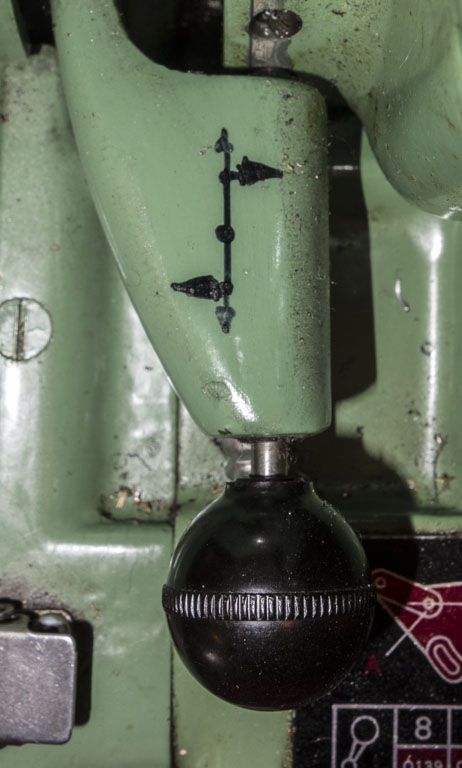

      Hi all Help Have recently obtained a Myford super 7 with power cross feed. Whilst on my first play to get used to the controls, I pulled out the round knob on the apron to engage PCF and the slide comes towards me rather than in towards the work. What I have done wrong?

            Yep Dudley
            Move the lever at the LEFT side of the headstock from the central ( feed disengaged) to the upper position. this will give saddle feeds towards the tailstock by engaging the lever on the apron or crossfeed inwards by pulling out the knob on the apron. ( Conversely moving the lever on the LEFT of the headstock to the lower position gives apron feed towards the headstock and crossfeed outwards. ( I made a little diagram with a marker next to the knob to remind me !)
            (nb The similar lever at the RIGHT of the headstock is to engage the backgear and you must first move the little lever at the right hand end of of the drive pulleys to disengage the direct drive.)
            Hope this is helpful and hope you enjoy your lathe – I certainly like mine!
            Regards
            Norman
            Edited By NJH on 25/05/2014 21:38:43

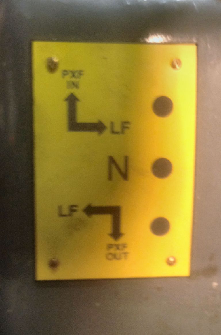

              Hope your enjoying your super 7, when I when I had my s7 had the same problem so purchased one of these from a guy on ebay. Have not seem them on few a few weeks but if your interested and I'll send you his ebay contact details

              NJH
                @njh
                Harry
                That is very elegant ….. my solution though may be a bit cheaper!
                Norman

                Harry Wilkes
                  @harrywilkes58467
                  smiley can't beat free ! but to be fair think I paid about three quid for mine .
