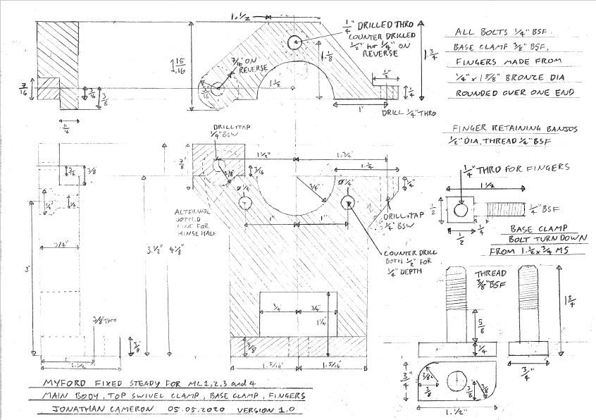

              Luke, the first reply I posted detailed the bed. Mine measured 25mm between the ways and is raw cast. 75mm over the bed ways.

                  Howard the original fixed steady for the ML1,2,3&4, has a flat soleplate, and a 1/8" plate, to a 3/8" BSF bolt which pulled the steady into the ways. It should be possible to build one up (although not as ornate) from 20x100mm plate, around 150mm off, some 5 or 6mm x 40mm plate, around and some 1/2" steel round. Either bolted or preferably welded before been machined down. The ML10 and M-type lathe both utilised the dovetail ways to locate onto the bed.
                  Luke is the second person now owning an ML4 that wishes to have a fixed steady, so would be practical for me to measure and do a set of drawings so they could be used to fabricated up.

                                    Luke you'll be pleased to hear that I have just finished the drawings tonight for the fixed steady. So will take into work tomorrow and scan them before posting. There is an error on the hinge, but follow guidance of the dotted line and you'll not go far wrong. These have taken the best part of 8hours to draw up so I wasn't going to start again, just point out the error of my ways. The hardest part was trying to fit all the drawings onto a single A4 sheet, without missing any information/measurement, Plus it had to be legible.

                                            Well i've no idea how to load a PDF to the forum. So here's a snip of the PDF from my screen instead. Feel free to PM me with your email and ill happily send the PDF to you. The steady can be built up using 20x100mm Mild Steel flat, and 10mm Mild steel flat, 6mm and 12mm round stock. The threads can also be changed within reason to suit yourself. Its drawn in imperial as that's what bolts most old myfords use so made sense. The critical dimensions are the centre height and bore. all others can be played with easily. It can also be adapted for the 3.1/8" centre height lathes by simply reducing the centre height and then work dimensions from around the bore. The main lower body can be welded or even bolted together.
                                            Please note the dotted line on the lower hinge part needs to be followed. I'm afraid I wasn't going to start again, If anyone notices any other issues with the drawing let me know. If there's a few ill redraw it. It dawned on me that not only would it not close if built as drawn it wouldn't even go together. Also should have written on the drawing to check clamp bolt for length from job, but you already knew that.
                                            Luke I hope this is of great help to you. Ill Look at the travelling steady next week.

                                              I will certainly do that, Jon … it looks a nice adaptable design
                                              I’m also happy to convert your PDF to JPG and re-post it here, if that’s O.K.

                                                Many thanks for taking the time to measure and draft that blueprint. I'm sure it will be very helpful to others, as well as to myself. Whilst I'm not in a position to fabricate one at the moment (no welder, limited workshop) I'll be giving it a go whenever the lockdown is eased as I can use a friend's.
                                                If it's not too much of a hassle, I would also be interested in the travelling steady. I've noticed considerable flex in the work when turning longer stock and I feel that the addition of a travelling steady would be very useful for combating it. At present I'm simply taking much lighter cuts – but I'm sure it's added hours to my tinkering time!

                                                  That may be clearer than the windows snipping tool I used for the image posted above.
                                                  Ive replied to your PM and email sent. It could be utilised on other lathes with a slotted gap and even on an ML7 for smaller work, though I think the base should be increased to help with ridgidity in that case. Also the clamp bolt would need lengthening to allow a good contact with under the bed. I know the Alomco milling attachment needed to have smaller clamps (by 1/4" length I think) to clear the casting under the bed.
