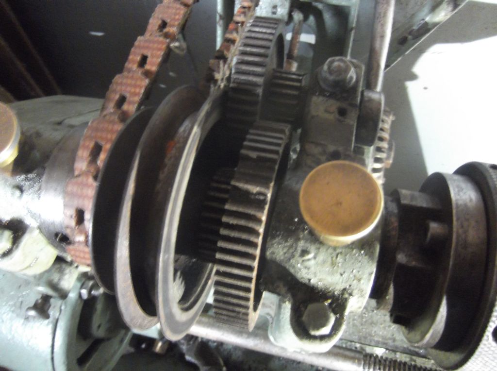

                          Since removing the spindle I have cleaned up the spindle gear and I’ve left the thrust bearing in some acetone to degrease it. It looks as though there are a few flats on the ball bearings and so I will be replacing it. I’ll take some measurements later today and find the appropriate part. I’ve also deburred the spindle using a fine file and a stone so hopefully I will not damage the bearings when I refit them – it was a nerve wracking experience but I think a successful one. We shall see.
                          I will take a look at the 25T gear too and take a photograph. I’ve not noticed anything that would indicate a crash – the change gears all seem to work and fit well and the lead screw is in good condition (although there is a bit of a flex in it, I’d chalked that up to the thickness/length). Perhaps the crack is nothing more than a scratch that is full of old swarfy oil.

                            I dug the thrust bearing out of the acetone – it's partially cleaned up the muck inside it but it will need a bit longer, and possibly some agitation. Here are a couple of photographs in which you can just see the flat spots. The flats on the ball bearing at 8 o'clock and 4 o'clock in the second photo are particularly obvious.
                            As for the 25T gear, it was indeed cracked. It's strange as the teeth of the gear look in very good condition. It looks as though my changegear set has been taken from an ML7 as each gear has a keyway cut into it. See the photograph below.

                              Here are another photo of the cracked gear (I posted my previous message in a hurry as I was late for an online chat with a friend). I couldn't discern any noticeable difference in material between the 25T gear and the larger sizes – as you can see in the second photo they all look very similar (and are in remarkably good condition, to my eye).

                                I suspect the bearing has been skidding. You did say some while back that the screwed collar was slack so there would have been no pre-load on it. It was also lubricated with grease which would tend to hold the balls in position as the grease dried out and it got stiff, adding further to the problem. Buy a new one, it should be realistically priced
                                The cracked gear
                                I was right it seems, this was NOT original supply, Keyways were introduced in ML7 change wheels, not for the ML4. Starting from the stress raiser in the keyway corner it must still have been given a substantial shock to have cracked. However, it will salvage well. I suggest you drill out down the centre of the crack at the tip to remove the stress raiser there in particular so that you can get braze metal all the way through onto clean metal and anneal it by very slow cooling after the brazing with it buried in vermiculite

                                      I've had another look at your cracked gear, this time in the second picture. I can't be sure, but isn't there a darker line in the root of the gear that might indicate that the crack has propagated right through? There is also, to my mind, something very odd about the path taken by the crack, it is shown well in the first picture. It doesn't actually start from the corner of the keyway as I would have expected, it is very straight and at right angles to the keyway.
                                      In my experience, such a crack would not be ruler straight and would run at some angle nearer 30 degrees or so away from the sharp corner.
                                      Just to satisfy my curiosity would you mind scrubbing it with acetone and get a lens on it to look closely at it? There is another line at about 9 o'clock which is obviously scored, the similarity is marked.

                                        I'm sorry that the photos are not very clear. You're correct – the crack does propagate all the way through and, indeed, continues down the other side of the gear. It's as if the gear has been loaded sideways and split.
                                        I will try and clean it up properly and take some well-lit photographs with my camera (I used a phone for the others) at some point.

                                          There is no need to apologise, you have the component and can study it from all angles, it is not a luxury available from a photo.
                                          It might well be that there was a sulphide inclusion in the bar from which this gear was made that would have led to a one sided weakness in the finished gear. They tend to align themselves in a linear fashion, especially so if the bar has been drawn down to size, and of course will form a plane of weakness leading to fracture later.
                                          I will amend my salvage instruction accordingly if I may and suggest you saw down the path of the crack with a Junior hacksaw blade to leave clean metal on each side and braze that up. You do need to give the braze a chance to wet the joint, something it will fail to do at the moment.
                                          I had a half shaft failure on our old Landrover arising from just such a source. It propagated as a fatigue crack in a spiral path over a 6 inch length until the final fracture point which came as I was reversing up the ramp into the garage. That little piece still holding the shaft together was about 1/8 inch in diameter!
