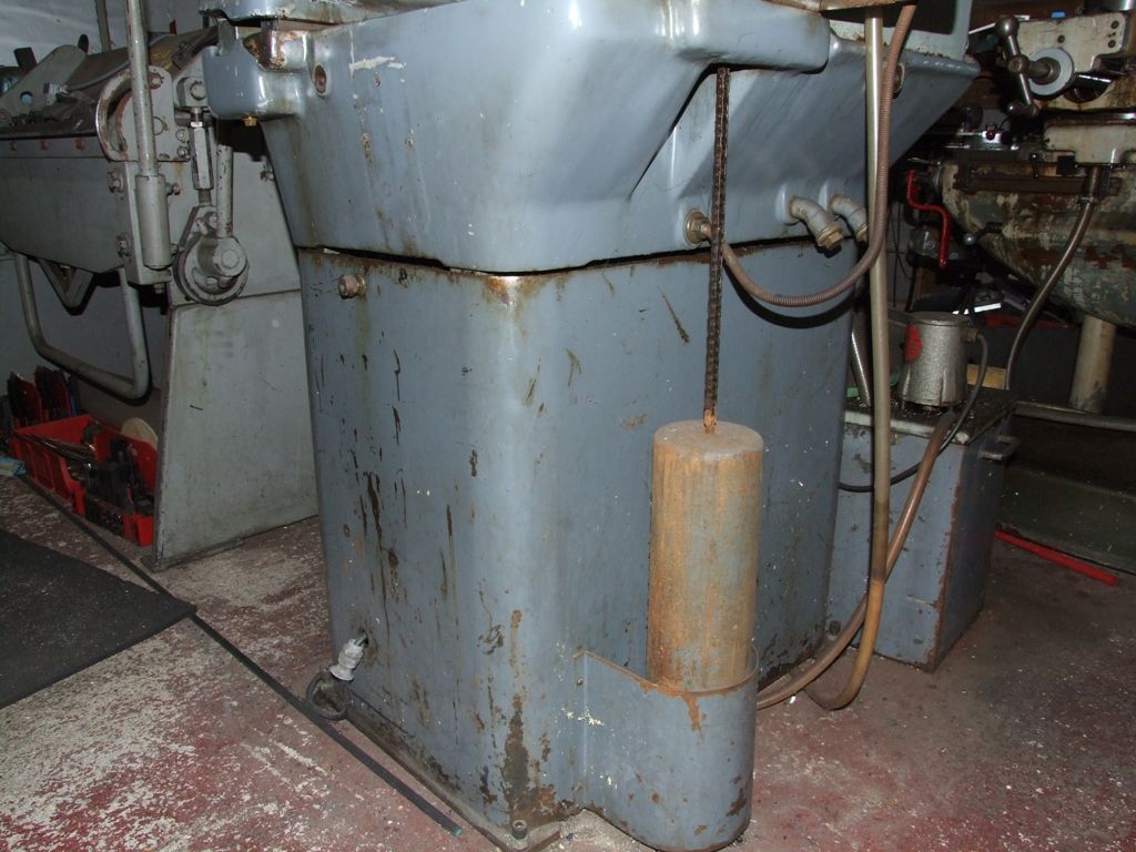

      Here's a better picture of the wheelhead weight on my MG12:
      The MG9 seems to have a coolant tank at the back, looking at the newly refurbished casting. Does it have a separate coolant tank and pump as seen on tbe right in the above picture. On the MG12 the tank at the back of the machine is divided into 2 compartments, and is basically a settling tank. The two bent plugs top right are for draining the settling tank.
      Andrew

        Thanks for the photo Andrew it helps me a lot. The MG9 has a single small sump and it was bothering me that it had such a small capacity and scant room for a pump. Mine also has an outlet in the rear wall mid-height which stuck out about 3" with an elbow on it. Then I saw this flyer which seems to show a separate coolant tank on the floor behind the machine.
        I guess the outlet is a gravity drain to the separate suds tank.

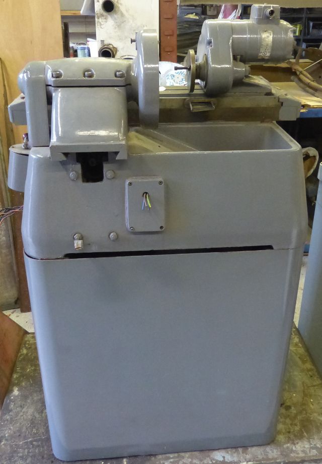

          So, I saw this photo from the web which is a good rear shot of another machine.
          Clearly there is no counter-weight on the MG9. The four holes appear to be motor mount holes which means that the original 3 phase motor must have been inside the base casting. Mine has a large frame single phase motor fitted to a shelf in the cabinet. I believe that the two holes cut in the top of the cabinet are not original (and the access panel in the rear on mine is certainly not), and were put in to facilitate the fitting of the single phase motor (the capacitor pokes up through the larger square hole, the belt passes through the smaller).
          It''s very neatly done, and a very good quality motor, just not original fitment. I am undecided as to which way I will go with this. I could fit a 3-phase motor back in the original position and use a VFD, or I could persevere with the single-phase one.
          Another question I can't answer is whether the original drive used a single vee pulley or a two-step pulley. My spindle has a 2-step pulley fitted, the motor a single-step pulley.
          The three holes in the end of my slide also appear very faintly in the pic above. They seem to have been filled and painted over. I can only assume they were retaining a way cover of some sort.
