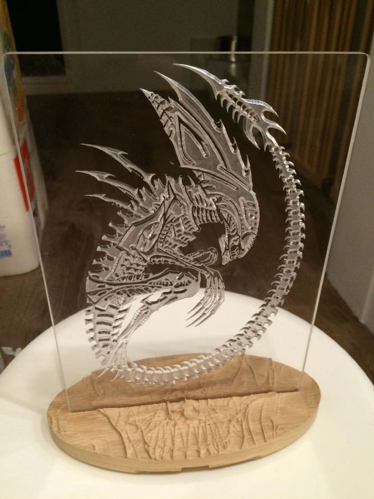

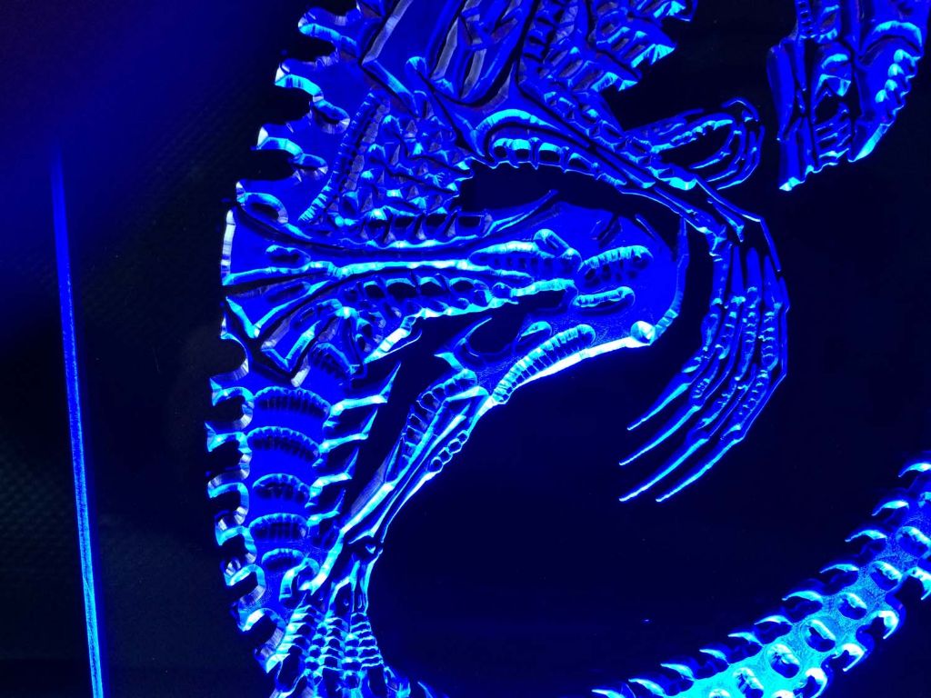

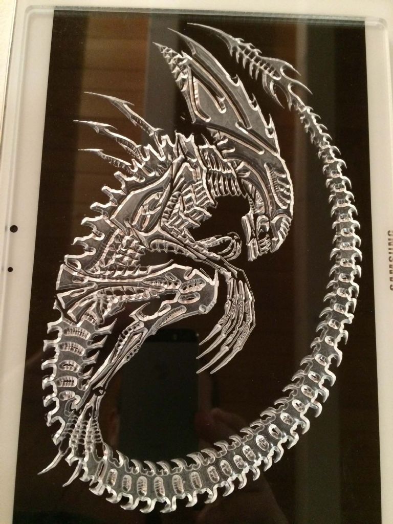

      A new project with my badog CNC ,it's an edge lit in plastic of an Xenomorph the alien creature of the movie franchise Alien ,it took me 5 hours tole finish it, with a 0.1 stepover et and a 0.3mm mill.

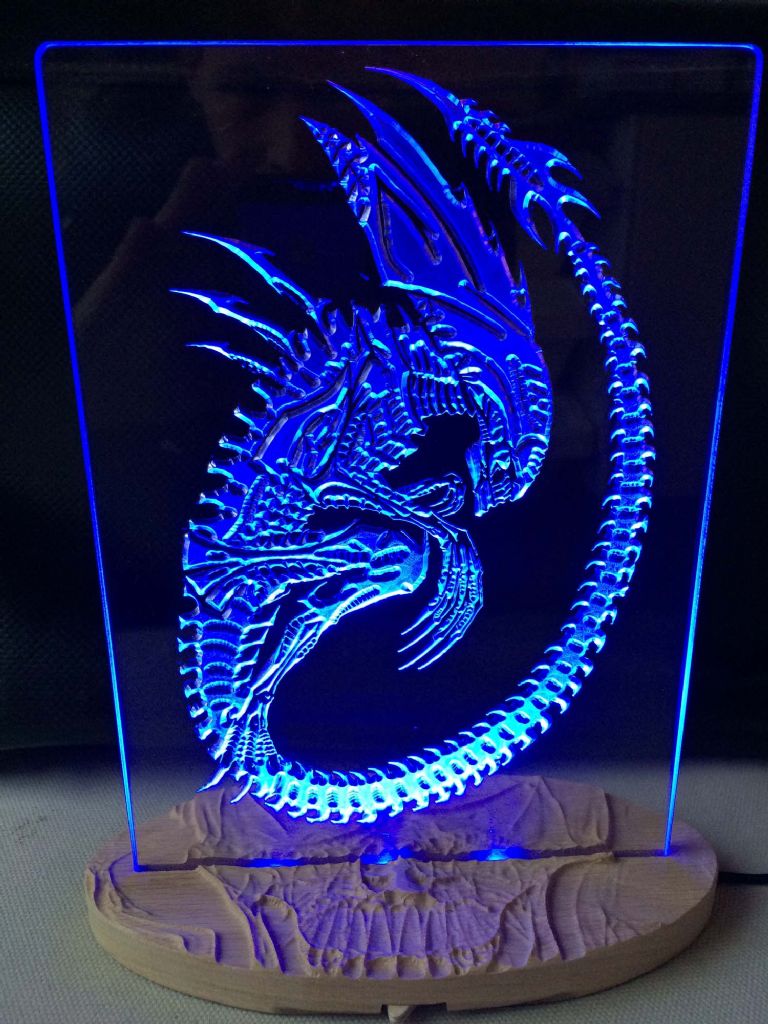

          How about putting up a photo of the whole panel in the lit up state (please).

                              Sure,sorry i thought i uploaded it ,here you go

                                    more of the time of the step over then feed rate. used a 0.1mm stepover and the stl was just an image in grayscale that i transformed into a heightmap with BMP2CNC software.
