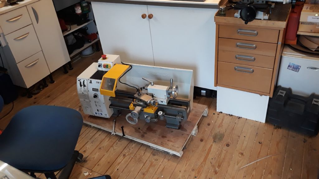

                Well 320 kg is a challenge. I recived yesterday my DB8VS, I have the advantage of a stepless garden path to my shed and could convince the driver to move the box on his pallet trolley down the garden. So step one was easily done. Step 2 was a bit harder. I removed everything heavy like chuck and tailstock and then it was muscle power. My son and I grabbed the machine and lifted it up to the workbench. After my weight removal action it had probably 100kg. Felt heavy enough for me even I was on the light side (tailstock side).
                DB8 on the floor before weight removal actions
                and finally reasonable cleaned and screwed on in its final position.

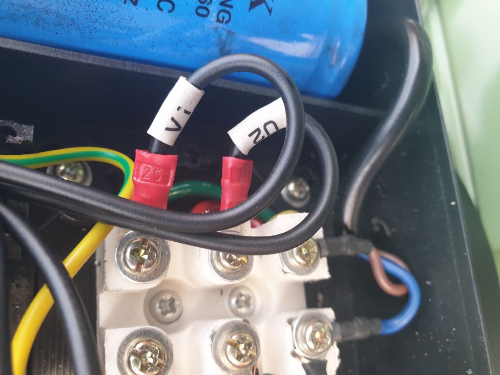

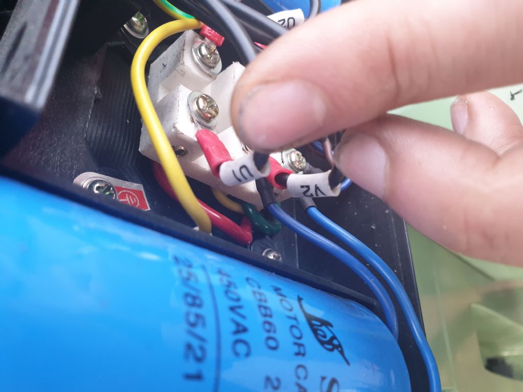

                            20210318_174324.jpgAlas, its in situ but DOES NOT RUN. the green power light is on, but when I hit forward or reverse it does nothing. The only thing I can think is that the motor is wired wrong, but I rewired it according to the photos I took before dismantling so unless it was wired wrong to start with, then it shouldn't be that. Heres some photos and across them you can see the wire names. These were taken before disassembly. Any ideas? I'm very very disappointed after cleaning it all down and assembling it after all that graft to get it to the shop.
                            just to confirm – top left = U1, top right = V1, bottom left = V2, bottom right = U2. V2 is also has another wire on it, a blue one. 20210318_174345.jpg20210318_174304.jpg

                              Have you got the guards/covers etc back in place as they have interlocks which will stop the machine running.
                              Always best to test run a macine before you take it apart then you and th esupplier know where you stand.

                                @swarfmaker85383
                                Remember that the chuck guard must be down and operating its safety switch. Gear/belt cover also needs to be in place?

                                  I didnt realise there was a safety switch on the chuck guard…..let's hope that is it. I'm gonna go check right blooming now.
                                  #535315
                                  Jak2g
                                    @jak2g
                                    Hallelujah!! Flipped the guard hinge and it worked!! Relief!!
                                    And, yes, it is always a good idea to check machines when they arrive.. that was a silly oversight due to eagerness.
