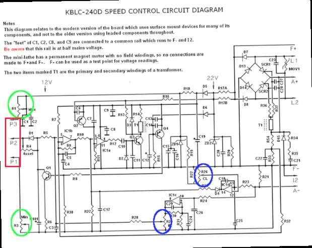

                                On John Hinkley Said:
                                Dave,
                                I would tend to agree with you, but the manual specifically says to turn the speed pot down to minimum before starting the lathe, suggesting that dire consequences will result if these instructions are not followed.
                                We may have got ourselves cross-threaded!
                                Setting the speed pot to minimum is recommended because. on starting, motors briefly draw a heavy inrush current which might damage the electronics.   Turning the pot down reduces the risk of making magic smoke.   How high the risk of producing magic smoke is depends on the design of the controller: an expensive industrial unit is likely to be well-protected, whilst a cost cutting hobby lathe isn’t.
                                But that wasn’t my point!  I’m saying it’s not a good idea to start a lathe motor from zero RPM because doing so risks the controller not starting the motor, and the absence of a back-EMF means a high current could flow in the motor long enough to cook the windings.  A stalled motor takes much higher current than a rotating one.
                                The KBLC-240D motor controller is a popular replacement for a burnt out Chinese control board.  The circuit diagram is arranged to stop the operator from setting the speed either too high or too low.
                                speedboard
                                The red square shows the 3 terminals  P1, P2, and P3 to which the exterior speed control pot is connected.   However, the motor’s speed range is controlled by this and two other pre-set pots in series located ‘nichtgerfingerpoken’ on the board inside the box.
                                R3 (lower Green ellipse) is labelled ‘Min’ and it sets the motor’s minimum speed which generally isn’t zero.   The upper green pot, labelled ‘Max’ sets the maximum speed.     The Min pot could be adjusted so the motor does start from zero RPM, but I wouldn’t cos’ I’m a cowardly cat!
                                If you want to try, see if a Min pot can be identified on your board.  With luck the pots are obviously labelled but not always so, making it necessary to reverse engineer the board to make sure.
                                Don’t guess! The KBLC-240D circuit shows 5 pre-set pots, and I’m not sure what the two marked in Blue are for.  I think that the one on the far right sets over-current protection, and is needed to save the electronics if the owner overloads the lathe.   The other probably works with R4 (next to P2 red box on left) to manage Acceleration and deceleration, protecting the machine from a user who turns the speed up and down over enthusiastically.
                                The KBLC-240D board is just an example – other motor controllers may be significantly different.
                                #715939
                                Anonymous
                                  Rather more than that! The original thread title refers to brushless DC motors whereas the schematic shown by SoD is a basic PWM controller for a brushed DC motor.
                                  A DC motor controller contains a 3-phase bridge identical to the core of a VFD, but driven in a different way. In general running a motor at zero rpm but full torque is a rare requirement. An exception can be electric vehicles, where it is the equivalent of holding on a hill by slipping the clutch.
                                  In theory a brushless DC motor needs a position sensor so that the timing of the three phases can be output correctly. More recent controllers are sensorless. simply starting at a random point and looking at the back emf on the unpowered phases to determine rotor position and then adjusting the drive as needed.
                                  At zero rpm, with a DC signal applied to one phase clearly there will be no back emf to measure.
                                  Andrew
