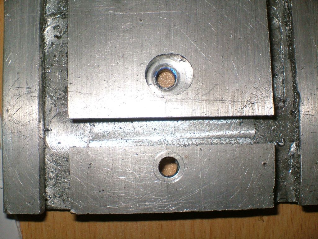

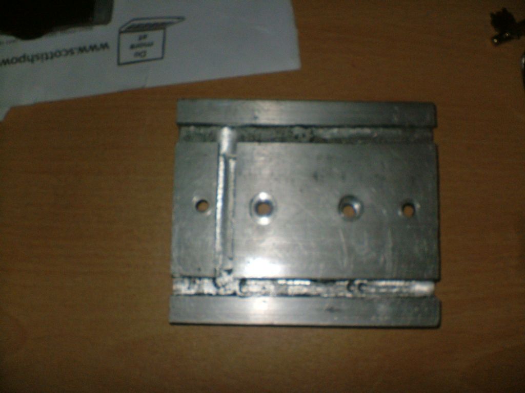

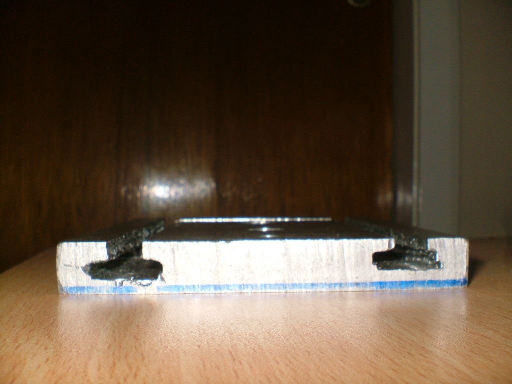

                                                #81304
                                                Ady1
                                                  @ady1
                                                  This is an old unimat milling table project of mine.
                                                  A first attempt by an amateur at cutting t-slots straight through a solid 12.5mm aluminium plate
                                                  The upper and lower t-slots are rough because they were done at higher speeds and had heat issues, vibration marks, sticky swarf and needed lubricating.
                                                  Non stop hassle which needed constant care and attention.
                                                  The lower slot was done on a unimat…lol, silly me, took about 3 days.
                                                  the upper was on the Drummond and was more controlled but still had the usual high speed issues which plague working with aluminium.
                                                  So I employed the family braincell and tried a different approach
                                                  The t-slot right through the middle of the plate on the left hand side was a complete doddle, done in a single pass with no lubrication on the backgear, and the finish was luvvly.
                                                  At amateur levels I find that stiffness and torque are far more user friendly, especially for longer jobs if the machine is doing a lot of work and heat becomes a major factor.
                                                  Edited By Ady1 on 05/01/2012 09:38:42
                                                  #81305
                                                  Ady1
                                                    @ady1
                                                    Here’s a more detailed photo, showing the incredible skills of an amateur.
                                                    I stopped at that point, having finally sussed the major hurdle of overcoming those high speed heat problems
                                                    Major heat issues on the right with the “high speed” unimat (1000rpm? and oh boy was that a nightmare job)
                                                    Moderate heat issues on the left with the drummond on “high speed”(4-500rpm)
                                                    Both attempts also needed lots of messy lubrication and there was a lot of stop/start procedures when the heat buildup got too high, jammed cutter issues etc.
                                                    Zero heat problems in the middle with the backgear and no messy lubrication required, only some milling marks(50 rpm), and the entire job was all done in a single easy peasy pass.
                                                    Sussed at last. phew!
