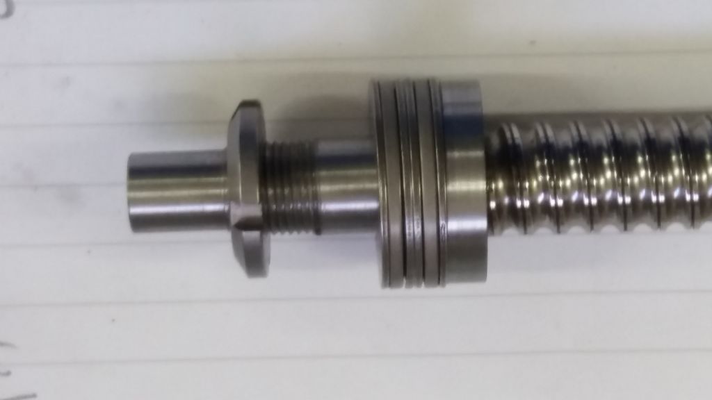

      Hi
      Sorry for this basic question but I have only cut 1 thread in a lathe and now need to do something fairly important.
      I know how to set the tool the cross slide etc but my problem is more to do with lack of knowledge of threads.
      Am I correct in saying that to cut a 12x1mm thread I have to turn the bar down to 11.8mm? I'm asking because in The Model Engineers Handbook by Tubal Cain he shows a drawing and I can just about see it says 0.1P for the amount of thread crest that is taken off.
      Is it better to take this off the diameter before I start or does it not matter? I am thinking I should take it off before or I will end up not knowing if I should cut the thread deeper or take some of the diameter to get the nut to fit! Some advice would be great.
      One last question, How do I work out how deep I need to cut in order to get the thread properly formed. Is it simply 0.86mm as he seems to show what looks like 0.86P. Or does it have something to do with the Minor Core diameter that is listed in the tables, which in this case is shown as 10.77mm
      Sorry if this seems basic but I have always stayed well away from threading in the lathe through lack of knowledge but now I need to start doing some.
      Thanks for any help you can give
      Rich

          Hi Richard, firstly welcome to the forum.
          Turning the bar before threading will ensure you have a better chance of a straight thread.
          I am not certain about the .2mm undersize but the author was far wiser than me so you could follow his advice before threading, although you may find the OD has grown during the threading process.
          If you are threading to use a nut then best have that to hand and trial fit when approaching the depth of thread, it's easy to go to deep.
          For the depth of thread use the table provided but note that if the threading tool does not have the stated nose radius you may have to adjust the depth of cut to suit.

              When screwcutting in the real world (ie home workshop) it is best not to try to hold exactly to the ISO thread form drawings such as those you refer too. They are far too exacting for practical home use.
              For practical work at home, yes make the outside diameter a few thou undersize so as to allow clearance on the thread tips. For a 12mm thread, I would turn the OD about .005" or 0.1mm undersize, or a little bit more. So 11.8mm is ok too. Yes, machine it down before you cut the thread.
              For thread depth I always use the classic formula for a 60 degree thread form (metric, UN etc) of .6134 X Pitch.
              For 55 degree thread such as BSW, the formula is .6403 x Pitch.
              Run a file down the top of the thread groove to remove the burr and round off the crest a bit. The corner of a common flat file works well for this.
              As said already, final sizing is by trial fitting a nut of known quality. (Cheap hardware store nuts are a notoriously loose fit so you might want to make your own test piece using a tap if needed.)

                    The major diameter for an external metric thread is nominally the diameter of the thread minus a fundamental deviation, and also a machining tolerance, both dependent upon the class of fit. You do not take off the truncation of the thread form, that is already built in. Incidentally the height of the crest truncation is H/8, where H is the theoretical sharp thread depth.
                    For example take a 12×1.25 thread. The nominal OD is 12mm and the fundamental deviation for a 6g fit is -0.028 giving a maximum major diameter of 11.972mm. There is then a machining tolerance of a maximum of -0.212mm. A 12×1 thread is not standard, so you'll have to work out the numbers yourself.
                    That's the theory. In practice I start with the work at the nominal diameter or very slightly above, in this case 12mm. I then cut to the calculated thread depth and check final fit with a mating thread. I find that one needs to cut a thou or two deeper than the theory in most cases. For standard thread forms I use full form threading inserts. That way all the crest and root shapes are taken care of.
                    Andrew

                        Look again at the book and you will see as Andrew points out the "Major Diameter" is to the crest not the projected point that is "taken off". The 0.108P or H/8 is over and above the Major Diameter.
                        If using aground tool or partial profile you may need to run a file down the crests as you get close to remove burrs so that they do not contact the nut first and give a false sense of a good fit. Also depth of cut will depend on the type of cutter as a pointed one will need to go in further than one with the correct radius on the end.

                                        What's meant by 'fairly important' is the elephant in the room. It decides whether Andrew's answer is more appropriate than Hopper's.
                                        In my workshop, I'm usually with Hopper. I mostly make threads where the only requirement is they have to fit together. The threads don't have to maximise strength or to minimise backlash. I don't bother reducing the rod slightly below nominal size, I use an ordinary 60 degree cutter, and I don't worry about getting the thread form perfect. I cut down towards theoretical depth and then test with a nut, only going deeper if the nut won't go on or jams. I usually run a file over the crests to flatten them and remove any excess diameter that may have squeezed up during cutting. Rough work in terms of precision and accuracy but plenty good enough for 95% of what I do.
                                        Occasionally I need a better fit. My preferred approach is to rough out about 60% of the thread with a lathe and then finish off with a die. The die puts a more accurate finish and profile on the thread. If I don't have a die of the right size, and the thread needs to be a good fit for strength or backlash, then I use carbide index thread tools and take much more care with dimensions and finish. This is much more like Andrew's approach. As I'm not skilful and have poor concentration, about 1 in 4 of my 'best effort' carbide cut threads are rejects due to small flaws.
                                        Where thread strength and fit are both paramount – like the bolts that hold aircraft wings on – it's unlikely that a high-end fastener would be made by a cutting process. Rolled threads are considerably stronger that cut threads. Most commercial fasteners are rolled for cheapness, but the posh ones are made more carefully from better metal, finished by grinding, and inspected.
                                        If 'fairly important' only means it has to fit together with moderate strength (60-70% of theortetical), Hopper is plenty good enough. But if the thread must be strong and/or a tight smooth fit best proceed as Andrew, or compromise with a die. Finally, if the part is safety critical – essential to holding a car's brakes together – then I'd recommend buying the right commercial part.
                                        If it's important because the thread has to be cut on an existing part that can't be replaced, practice on something else until you get good results!

                                            Success!
                                            Just kept trying it as I got close until I got a nice fit. When I said fairly important it was a ball screw for converting my SX3 to CNC.

                                                Last time I bought a m12 x 1 nut for a ballscrew it was left hand thread. Glad you didn't find that out after making one.
