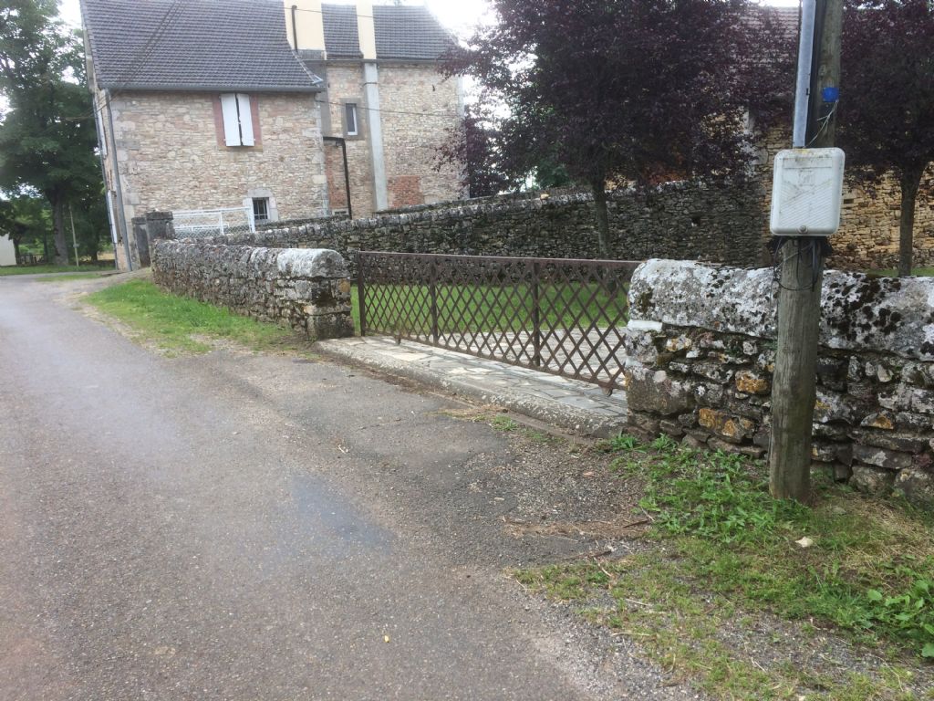

      I am looking for a supplier of mild steel band (Black or bright) about 30mm wide by 1mm thick and 60 meters in length total. This is for lattice work on a gate which will be about 3.5meters wide.
      When cut to length, each piece will be about 1.24 meters long with each end cut at 45 degrees. I can find suppliers who will guillotine the strips, but charge for each cut and can't guarantee that the strips will be "flatish".
      I have had a look on the internet, but not been successful yet. Those of us who are old enough can remember iron beds with similar lattice work!

                      Speedy Builder5
                        @speedybuilder5
                        30 x 1 is what seems to be used over here. Rust is not a problem and some of these gates are more than 50 years old. From the photo (30 x 1) you see that the steel is left in its natural state for a couple of years to get the rusty patina, then if you can be bothered, treat with RUSTOIL which is a mix of varnish and Jenolite probably with a bit of linseed oil for good measure. One coat is sufficient for 20 odd years as a bit more patina wouldn't matter.
                        Buying lengths of steel gives a lot of wastage unless you weld odd bits together. Older gates were riveted at each end of the strip to the framework of 35mm x3mm steel tube (older gates were solid and forge welded at the joints). with a few rivets every 4th joint. I was going to rose weld the ends and spot weld every 4th joint. The gate in the leading photo is rose welded.
                        Using galvanise strip would look out of character and not be so good for welding.
                        I am not trying to re-invent the wheel here, just following tradition to fit in with the countryside. I did think that if I could find a 'Hooper' that they may know of a source of strip (Hoopers made the hoops for the coopers who made barrels and kegs etc), but havn't found one yet but they MUST be local as we are in wine country – probably made in China these days !

                          Gordon W
                            @gordonw
                            It has just dawned on me that the strips are probably wrought iron, not mild steel. Lack of corrosion and age, also riveted construction. Good luck finding any, only place I've found in UK is re-rolled stuff, and not cheap. Just a guess.

                              Ian S C
                                @iansc
                                The barrel hoops are probably wrought iron, or similar very low carbon material, and wont rust much after the firs colouring/weathering. Wrought iron is no use for ordinary welding, OK forge welds, rivets would be the way to go, just like the barrel hoops.
