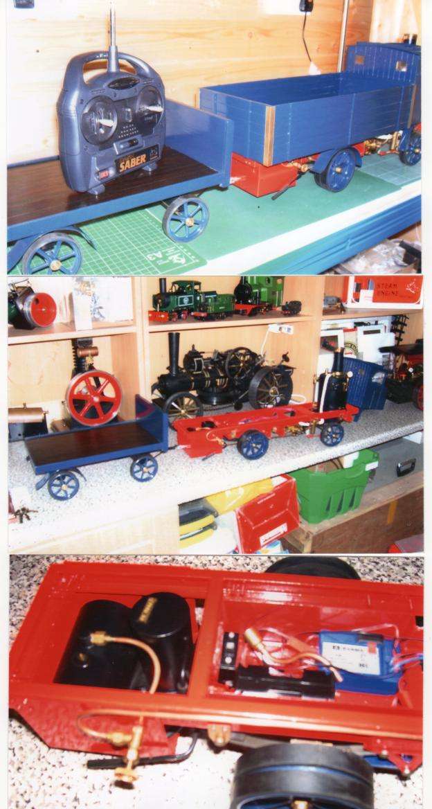

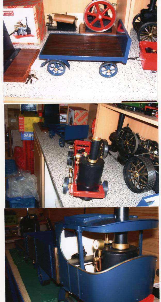

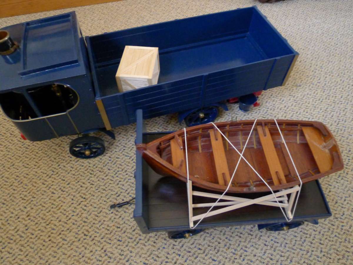

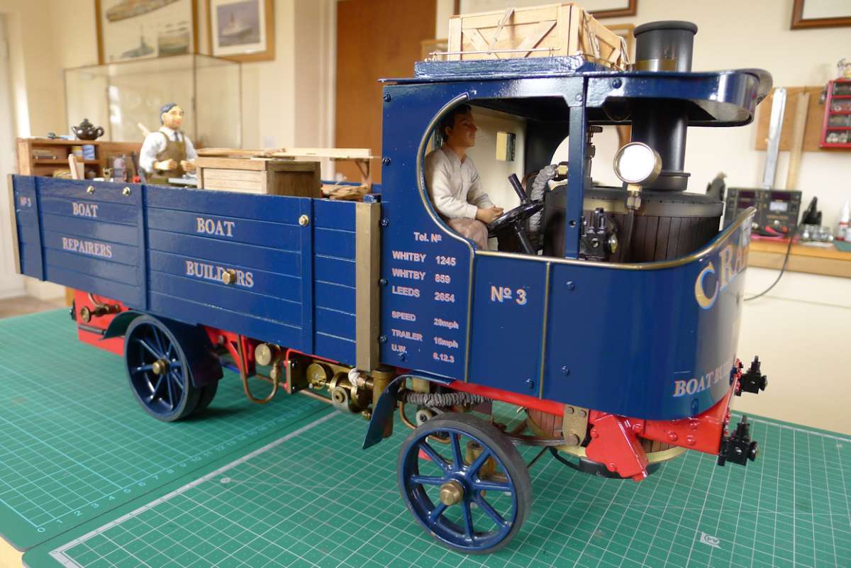

      Another project that I have just completed is again detined for the Yeller Belly steam toy show at Horncastle in November.  This project was the upgrading and enhancement of a Maxitrak Atkinson steam lorry.  Interestingly it is fitted with a Cheddar marine boiler and a slightly modified Puffin engine, found in many model boats.  It has been fitted with a attenuator valve to conserve gas.  It doesn’t do too well on any sort of textured surface but it runs around quite happily on a very smooth surface, such as the polished wooden floor of the drill hall where the steam toy show is held.  I wanted to make the lorry into a mobile boat repair shop, that would typically travel around the local boat yards completing repairs and maintenance on the boats.
      This is the lorry I bought, again over twenty years ago:
      010d27qbnxbxlppuqrn75djgdwsu5lts
      arby1fclcfgy6cmmxc53xa79u70zk39i
      6hjff98fyjy7jlabwc5rvmisszylpcjv
      x7tldxvgnnm2t5pc18a94xi3ior78qmj
      The lorry came with the trailer but I added the boat, which was got me into thinking of the idea of a boat repair lorry.

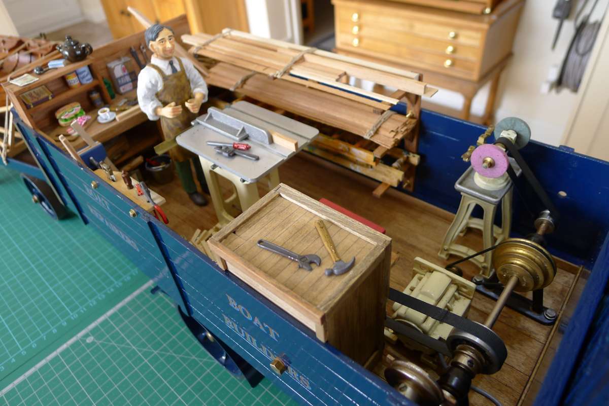

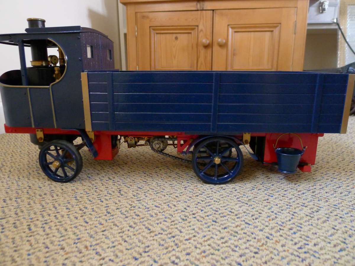

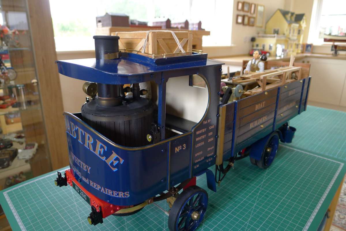

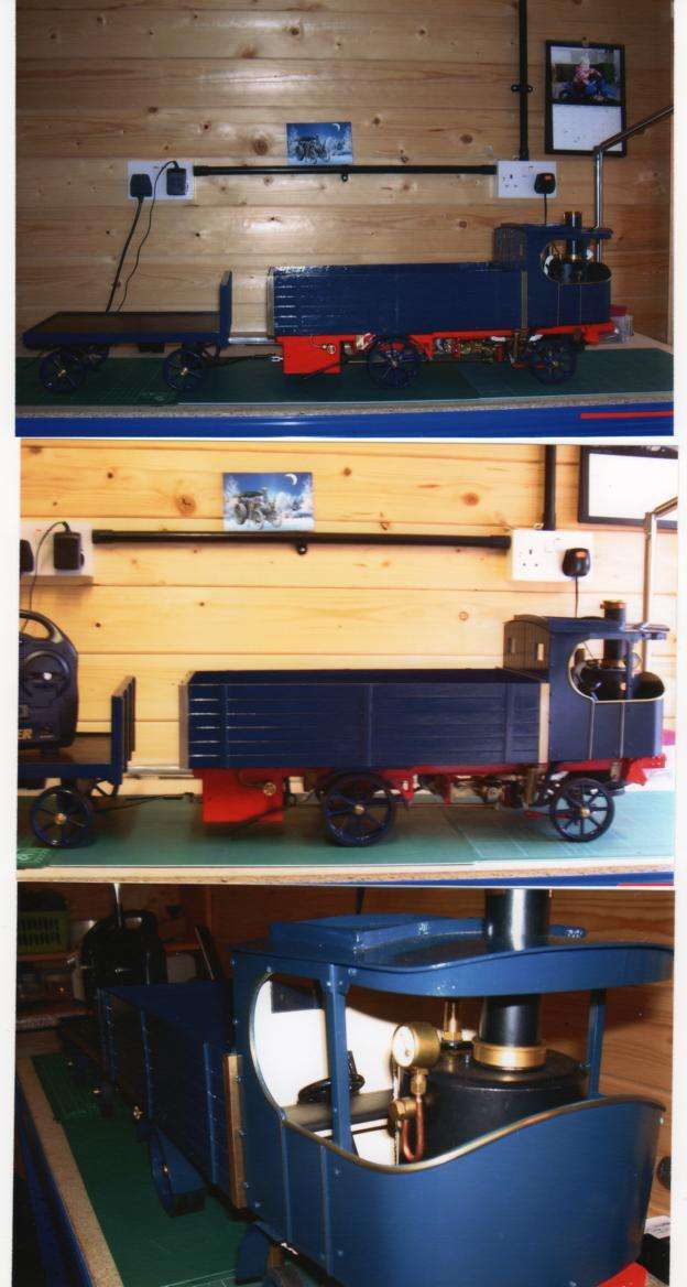

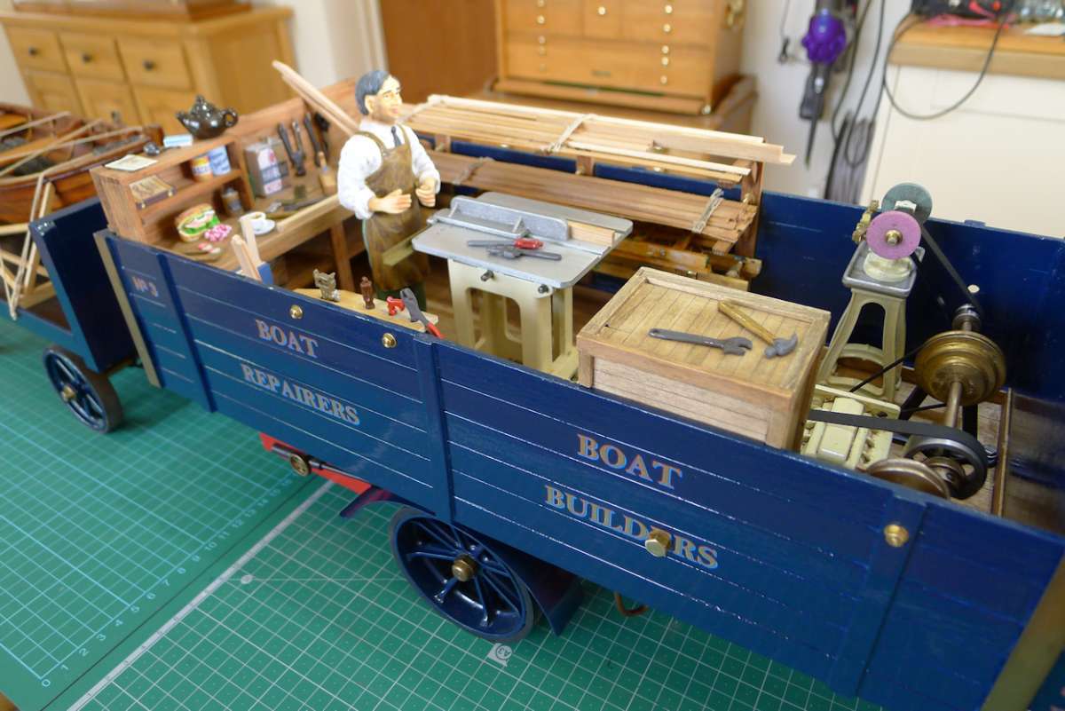

        After a lot of work this is what I ended up with.  In this case the lorry is supposed to be around 1/16th scale but I bent the rules slightly and went for 1/12th scale doll’s house figures and accessories.
        on98avqgfobzmhwo47dwklzsexx07cnw

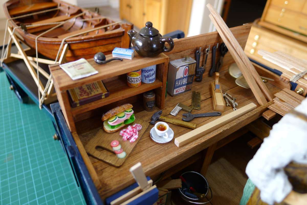

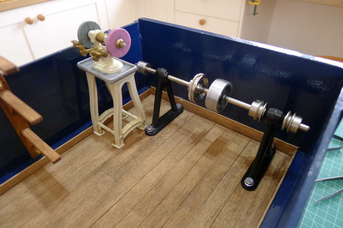

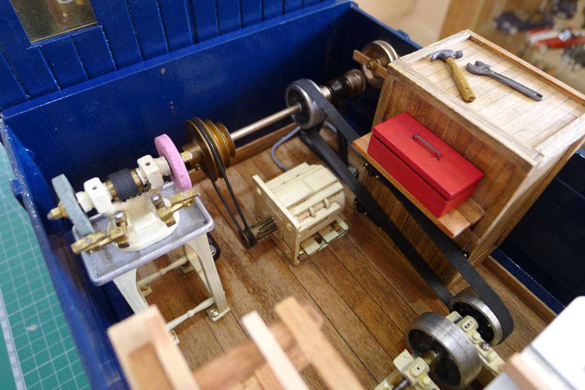

        The scratch built workbench is mainly fitted out with doll’s house bits and pieces but I scratch made the finishing plane.  The floorboards are also doll’s house wooden flooring, given an enamel wash and distressed with a pan scourer.
        x3i2q926sstr
        The grinding wheel and the table saw are both powered via the drive shaft which is turned by the Meccano motor.  The battery pack is inside the wooden cabinet with the on off switch being turned on by moving the tool box.
        y3gmd64umnkh2wu49btiat6qtdwhrudp

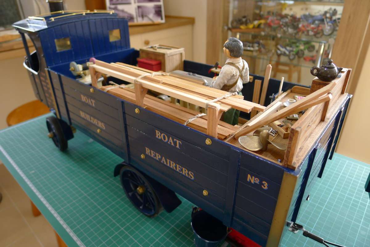

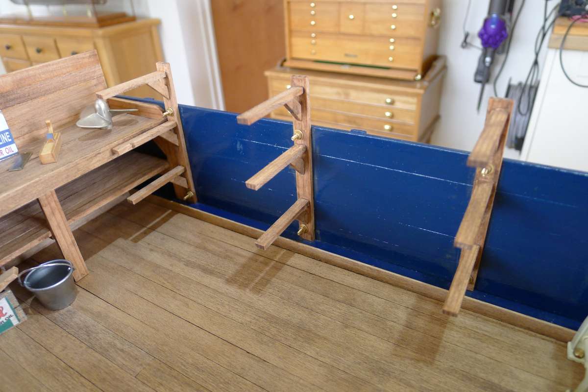

        The rack contains stock wood and a ladder at the bottom so our workman can get in and out of the back.
        0yai687zgcfe4u3h6rr663e9bkpgpebi
        The transfers were all printed for me by a specialist company after I created the original design in Microsoft Word.
        4rq5w9vodikf87s305tq

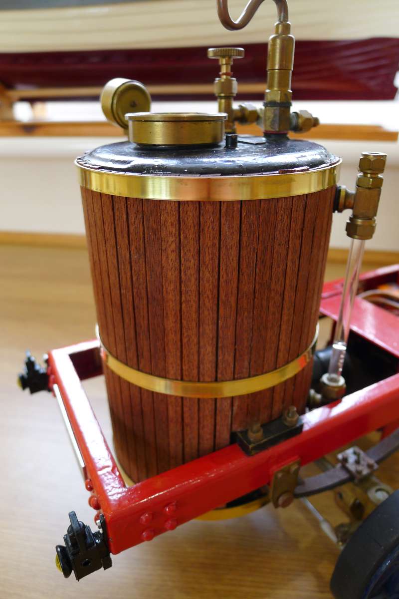

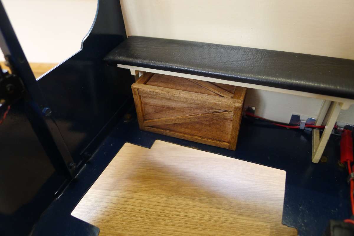

        The boiler was clad and then weathered and the lamps are all operational.  The ones on the chassis from the receiver power pack and the ones on the cab from another battery pack under the driver’s seat.
        ii8fdsqro1yejp1ok24e89squ15gybd6

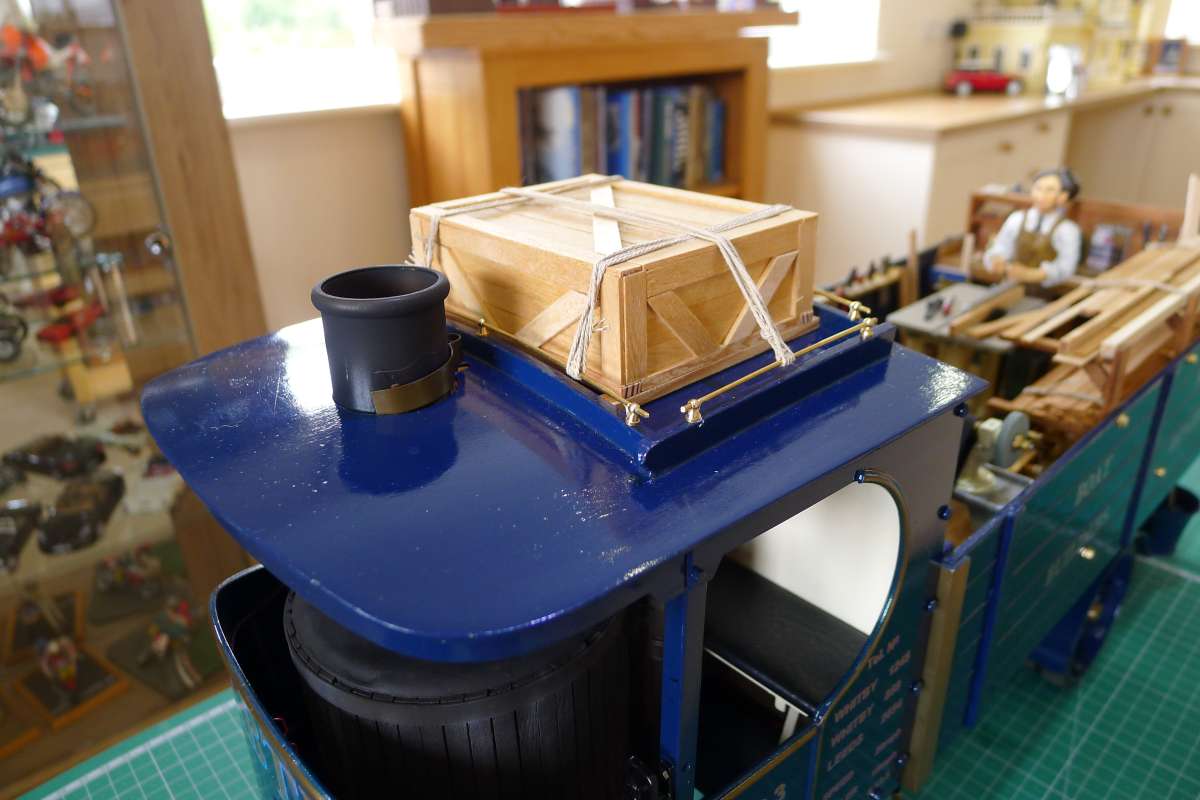

        Figures are doll’s house resin figures but repainted.  The roof rack was fitted with tie down rails and the chest on the roof rack is scratch built from coffee stirrers.
        inn1nd6dxv3xix

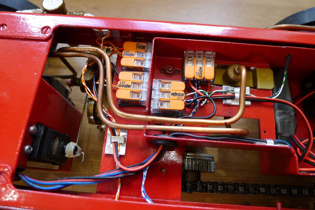

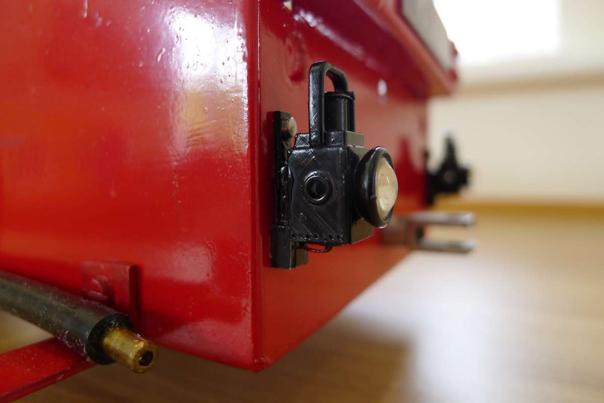

          First installing the lights, first the chassis lights, powered from the receiver battery:
          P1110563
          P1110562

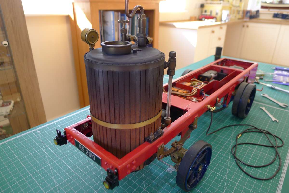

          Then cladding the boiler:
          P1110566

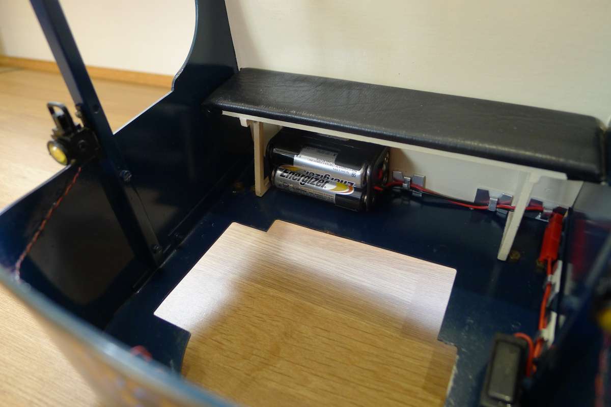

          Then the lighting in the cab.  This was seperately powered so the cab could still be lifted off to access the boiler:
          P1110573
          The cable doesn’t need covering because it can’t be seen from outside the cab when it is assembled.
          P1110574

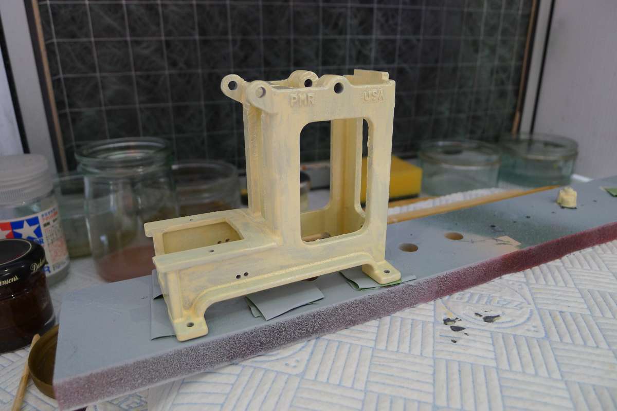

            Then the PM Research items in the back were stripped down, cleaned up and painted and made to run smoothly.  The paint is Craftmaster Coach enamel and this is the first of three coats:

            The drive shaft is a combination of Meccano motor and battery case and Wilesco shaft unit;
            P1110589

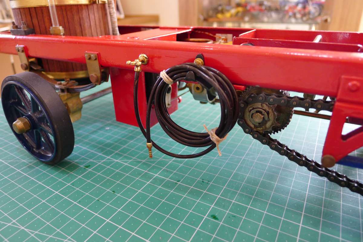

            The water hose was a doll’s house item but the hose was replaced with some nice soft floppy silicone tubing:
            P1110663
