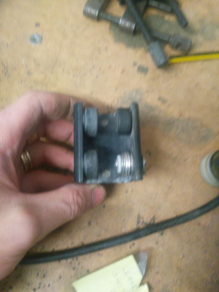

      Dear all,
      In the attached picture you can see the mainsheet truck for my father's Rustler Yacht.
      While he was off on a long voyage one of the wheels split and so he affected a temporary fix with stainless steel washers. I would like some opinions of what the wheels could be made from so I can machine another. They function like the outer race of a ball bearing so it should be a simple enough job. The plastic needs to be hard wearing and needs to resist high loads without deforming. Any ideas?

          My first 'port of call' would probably be PEEK : **LINK**
          http://www.bpf.co.uk/plastipedia/polymers/PEEK.aspx
          … It's not inexpensive, but has excellent properties.

            PEEK or PEK. Both high temperature polymers that machine well, look at the carbon fibre (CF) and PTFE filled bearing grades/varieties. Perhaps also partially glass fibre (GF) reinforced
            Failing that UHMWPE, used for low friction applications.
            Where did the original come from?

              I am very sure that the original rollers from the boatyard would not be PEEK , due to its' very very high cost, although it would probably do the job fine.
              I would not recommend any sort of PE or PP, UHMW or otherwise, as the loads on a mast truck can be quite high. It is not up to this sort of job.
              You might try acetal resin, 10% glass filled + PTFE filled if you can get it. One brand is Delrin. It is an engineering resin and will carry high loads especially if glass filled, has low friction, is easy to machine, is commonly available all over the world, and costs far less than PEEK although slightly more costly than PE or PP. Acetal is not hygroscopic , despite what some people think, and is great for marine use. Nylon is hygroscopic and not best for marine use, as it absorbs water over time and will lose strength, possibly cracking in time.
              When you make a replacement set, make an extra set the sailor can stow in a ziploc bag in the rigging locker just in case. It's only a few extra minutes once you are set up, and could make a big difference on a bad day at sea.
              To ID the original rollers' resin, try some solvent glue / plastic cement / ABS glue on a small area. If the dried glue will not stick at all, the resin is probably acetal. If it sticks a little, it might be a plain or glass filled nylon. You can also do a melt test on a piece of the roller sitting on a steel plate with a thermocouple next to it. Heat from below, gently, with a small gas torch or lighter. If the sample melts at about 180 deg C it may be nylon or acetal. If it melts at over 320 deg C it may be PEEK or other exotic high temp resin, possibly PPS or PVDF.

                Thanks for those replies! I was going to try delrin, simply because I had heard of it but I have never actually used it so I was unsure if it was applicable. The original was Lewmar and when my father contacted them about a spare, of course they told him it was discontinued and he would have to get a whole new mainsheet slide/truck assembly… We thought this was a cheaper, easier and more environmentally friendly option all round! I will purchase some delrin probably, and maybe look at PEEK, I am not paying for it so we'll see how deep my father's pockets are feeling! Any suggestions on where to get it?

                    For better creep resistance, I would go along with filled polyacetal … BUT … machining glass-filled materials can give rise to issues where micro-fragments of glass can break away from the resin component and get under slideways.
                    While machining a bar of glass bead filled something or other, in an instant, my ML7 (Myford) saddle locked solid when glass beads found their way under it.
                    It required a total strip down and a thorough cleaning of the saddle and lathe bed.
                    Given the choice of colour, black usually offers more UV protection.
                    Although I'm like the idea of plastics, why not stainless steel?
                    Sam
                    As an after thought: wouldn't 'exposed' glass in the machined bore chew into the shaft?

                        For a sailing-boat application, I'd consider Tufnol rod. Widely used for marine fittings, pulleys, rollers etc. Tough, weather resistant, easily machined and not too expensive.
                        Clive.

                          I made a set for my Squib mainsheet track using Oilon. Has lasted 2 seasons OK. Obviously much lighter load but as I had the oilon anyway I used it.Cheap & easy to machine.Purchased from Plastics Direct online who have a spec sheet there about that & the other materials already mentioned
                          I also made some oilon bearings for the wheels on our sailing club rescue boat trailer & they get sand & sea water every weekend. carry the weight of a RIB. They have lasted a season with no visible wear whatsoever so I have been asked to do the other 4 trailers this winter.

                                Regarding plastic identification – Delrin (acetal) burns with an INVISIBLE flame.
                                Regarding Tufnol – a good material but you need to get the right grade. Fabric reinforced rather than paper and with the grain going the right way for the application.

                                                I'm assuming this is part of the mainsheet traveller, loads are pretty high, but if nylon was unsuitable for such rollers then it wouldn't be used.
                                                Some digging suggests plain Nylon 6 might be best. Glass-filled nylon suffers brittle failure, while plain nylon requires extreme elongation before failing completely.
                                                Why not ask Rustker yachts where they source the original – possibly worth replacing the whole unit if not just the wheels.

                                                    Wow, I never expected all these responses! Thanks for the great suggestions. The originals are not nylon, as far as I can tell. They are extremely hard and don't have the 'slippery' sort of texture I associate with plain Nylon. they could of course be glass filled or something similar. From what I gathered of the failure, the wheel split and cracked in two so it suggests it was brittle. However, the whole boat and fittings are over 30 years old so failure is not surprising. A new track is possible, but they are not cheap and you have to make more holes in the deck, not to mention it is a very awkward area to reach to fit new bolts. I did wonder about stainless wheels but it is running on an aluminium track so I thought it might lead to excessive wear. However, the one Neil suggested does seem to use exactly that system. I will probably buy some lengths of different plastics and see which is most like the original, though I might just make four new wheels so as to reduce the risk of future failure if they are reaching the end of their lifespan. Anything I don't use will find a place in the 'bits box' for later!
                                                    Neil, I don't think the plain nylon wheel will manage to rotate sufficiently freely under the load of the sail. it needs the ball bearings to reduce the friction… Though, the replacement washers did work alright for a short space of time!
