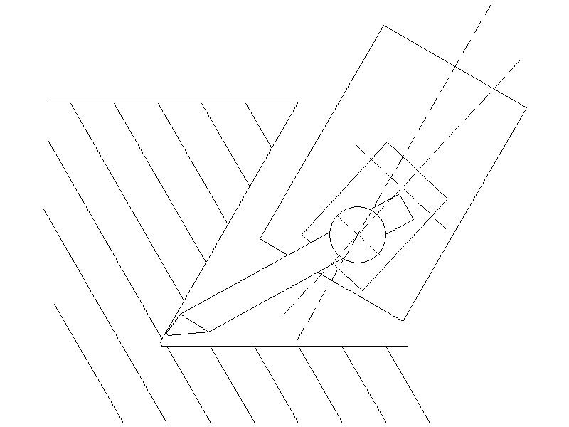

                  is there any way to lock the clapper so that it dosnt flap on a 10" royal shaper alan

                    Posted by ALAN EARL on 17/03/2013 14:16:45:
                    Why would you want to Alan? The clapper being free to lift is what keeps the tool clear of the workpiece on the return stroke
                    #114703
                    Sub Mandrel
                      @submandrel
                      I've never had a shaper but I understand the clapper box lifting can be fatal if one is trying to machine a dovetail.
                      #114704
                      John Coates
                        @johncoates48577
                        Posted by Stub Mandrel on 18/03/2013 20:02:58:
                        Cheers Neil. You learn something new every day. Logical when you think about it. Have only used my shaper for plane surfaces

                                In answer to Neil: Yes, if the clapper box is not rotated slightly relative to the angle of the rotatable topslide then the tool is liable to dig into the work on the return stroke. In my experience looking at the set up will tell you in which direction to advance the angle of the clapper box relative the angle of the topslide. This then results in the tool swinging away from the machined face.
                                Unless I am mistaken, it is exactly the same issue when machining a slot except that in that case the topslide is vertical. If in that case the clapper box is tilted in the wrong direction it wil cause the tool to dig into the side of the slot.
                                Clive.
                                Edited By Clive Barker on 19/03/2013 17:36:53
                                #114789
                                Sub Mandrel
                                  @submandrel
                                  HI Clive,
                                  I can imagine it may be possible, but is there still the risk of fouling teh bottom of the slot?
                                  #114809

                                          Hi Neil! Sorry for the late reply.
                                          I don't think there is any risk of fouling the bottom of the dovertail so long as the angle of the clapper box relative to the angle of the dovertail is small to moderate – small enough to guarantee movement away from the angled face, but not so great that it interferes with the lifting action of the clapper box.
                                          See schematic below (someone might prove me wrong, but my own experience seems to confirm this is correct).
                                          Clive.
