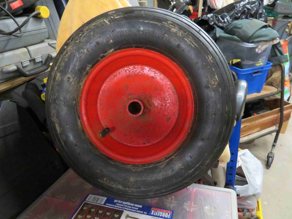

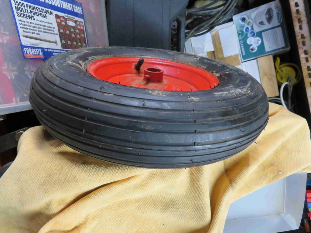

                                  Norman – I have 4 off pneumatic tyred wheels, solid disc type which are (I think) about the size you are considering. I'll let you know the actual size tomorrow – too cold to venture out tonight!!

                                      Norman – apologies for the delay. Have checked the wheels and memory was at fault ; they are, in fact, 15" diameter and 4" wide – photos attached. However, if the 10" diameter is essential, have you considered these? https://www.ebay.co.uk/p/4-X-10-Black-Heavy-Duty-Pneumatic-Wheel-Tyre-With-Rim-Cart-Trolley-Wheelbarrow/675595437?iid=371892404805.
                                      rgds
                                      Bill
