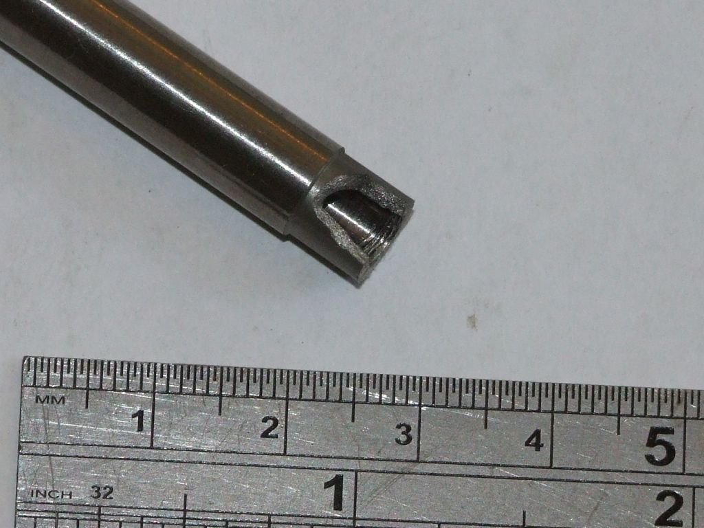

      As a precursor to making heavy half balls (for a Pickering governor) I bought a short length of 8mm diameter pure tungsten from Ebay recently. I've had a go at machining it this afternoon.
      Turning with an insert intended for aluminium was fine. Swarf came off as particles, like cast iron. The finish was smooth, but dull. I suspect that to get a shiny finish one would need to grind. Drilling and tapping was another matter. Trying a HSS centre drill resulted in the end of the bar fracturing. Another attempt with a HSS spot drill resulted in the drill fracturing. sad
      'Drilling' with a 4mm centre cutting carbide endmill was fine. But when I tried to tap 2BA the tungsten fractured again:
      I shouldn't be surprised; it's pretty much what the books say. Tungsten alloys machine well, albeit rather abrasive, but pure tungsten is tricky as it is brittle.
      I can buy the required size of pure tungsten on Ebay, but it's $300. On this showing I think it's going to be a nightmare machining job. So I'll probably revert to an alloy. Most likely tungsten/copper as I can get it on Ebay. If possible I'll buy a sample before committing large dollars for the required size.

          Yes , Pure tungsten is a bit of a swine to machine,. My friends big Tesla coil uses tungsten rods as electrodes in the rotary spark gap. Fine to face the electrodes up with a TC tip, but forget anything else. The Tungsten /Copper alloy is a much better bet for machining, but unfortunately the copper evaporates from the alloy in a rotary spark gap (60 amps at 11,000V AC)! It makes a right mess!

            Another result; the tungsten was easily marked with a file, although hardness seems to be around 50Rc.

                          Your material was either a matrix including tungsten or a tungsten alloy, usually with copper. They both machine with consummate ease. Pure tungsten can be machined with tungsten carbide or with greater difficulty HSS. In my experience you need plenty of coolant.
                          As for drilling or tapping it with normal kit, forget it, you will find that it will usually shatter, or break the tooling. Maybe a tungsten carbide drill might work, but I don't know if tungsten carbide taps are available!

                                                    Exactly my experience. crying 2 Professional sources state carbide drills but HSS cobalt taps. Certainly I 'drilled' the tungsten with no problem using a carbide endmill. Time to move onto another material.
                                                    Iridium is denser than platinum, and both are cheaper than gold. But at about $1000 per ounce that'd be $12000 for the two engines. And then some scumbag would nick 'em. No idea about machining platinum or irdium, but I would expect gold to be poor, much too malleable.
                                                    A futher search on Ebay has located a 87WNiFe alloy from Israel and W80Cu20 from China. Both are over £100, which is a bit risky if they don't machine as well as expected. I'll see if I can get a smaller sample to try.
