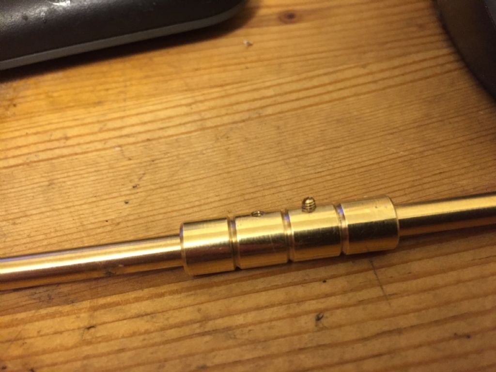

                                Robin Graham
                                  @robingraham42208
                                  Thanks Clive. I eventually found some M2 x 3 brass screws on eBay, but they're still going to need shortening:
                                  It's going to be a challenge – the screws are so tiny! Unsurprisingly one has already been sucked into the vortex of the workshop floor.
                                  The part is a balance weight. In principle, when it's in the right place on the beam it should just stay there, so I could use shaft retainer. But that would be too easy – and I like to make things adjustable when possible.
                                  Robin.
                                  Edited By Robin Graham on 03/02/2021 23:18:22

                                        DC31k – I had thought about making the balance weight fatter – but my pesky aesthetic sensibilities! It wouldn't look right. I've got a bit of a 'thing' about old brass / hardwood instruments. Back in the day they made things that worked and looked good – I'll never achieve that level of craft, but plan to die trying.
                                        John. Doh! I've got 2mm gauge plate. Thanks.
                                        Robin.
                                        #526778
                                        Robin Graham
                                          @robingraham42208
                                          Double Doh! I got too focused on dimensions. Eventually I realised I could just screw in the screw then run a reamer down the bore to chop off the excess. That's worked fine. Screws are now probably about 1.5 mm long, which is OK for purpose, but I wouldn't want to try to find them again if I took them out!
