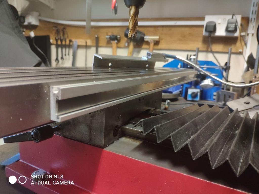

      I am in the process of installing an M-DRO setup onto my SIEG SX2.7 mill. I have managed to get the X axis on but am struggling a bit with the Y axis installation. Does anyone have any pics of their Y axis installation on an SX2.7

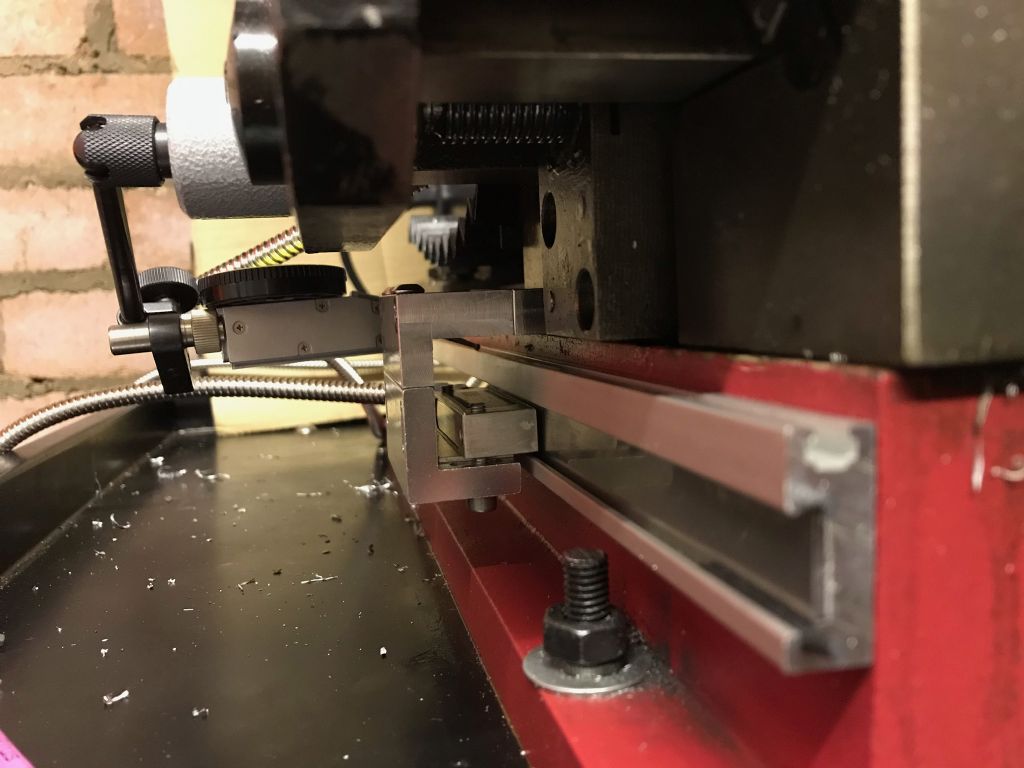

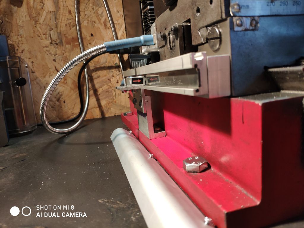

          I mounted the scale on the base drilling and tapping a hole for each end (the only new holes made for the Y axis). Wedge shaped spacers make the scale vertical. A length of aluminium angle replaces the thin metal strip which fixes the Y axis bellows in place. One of the supplied agle plates carried the reader below the the scale.

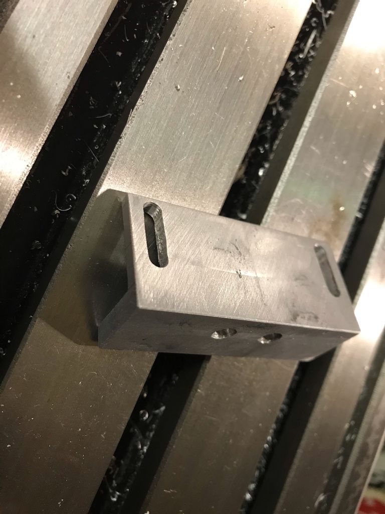

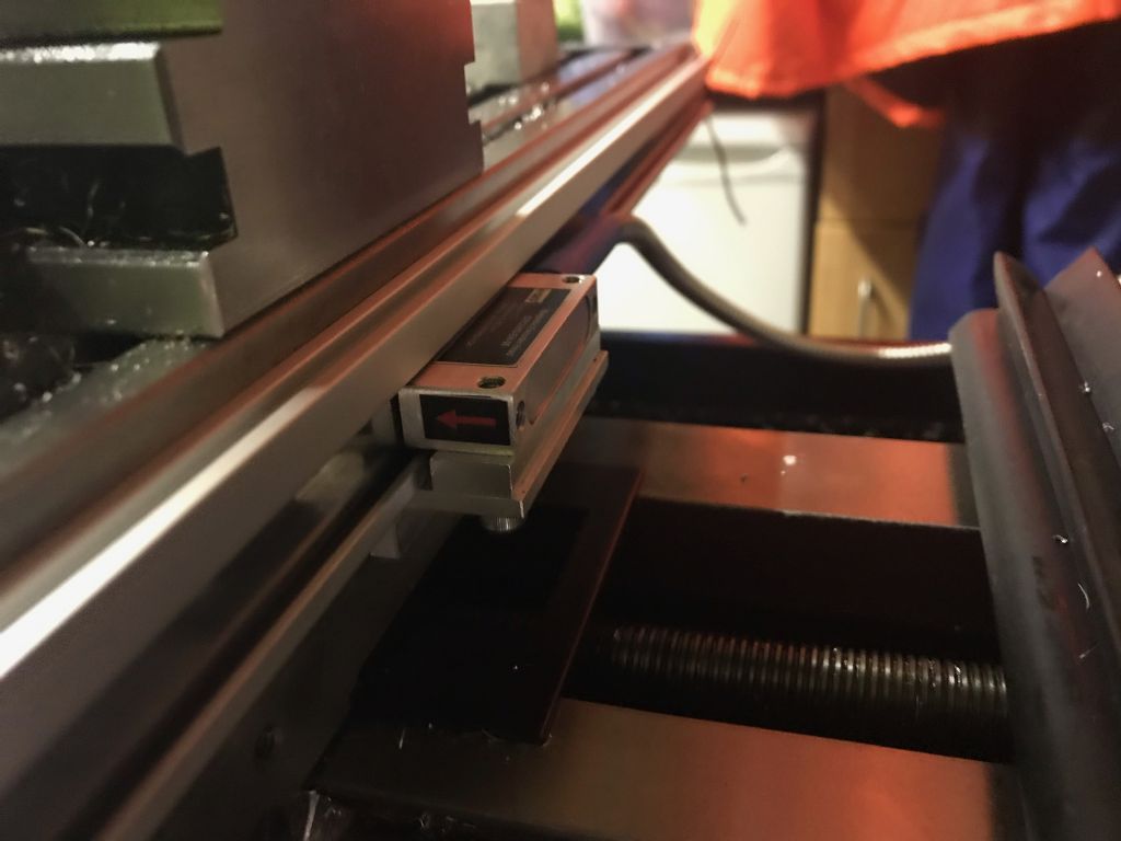

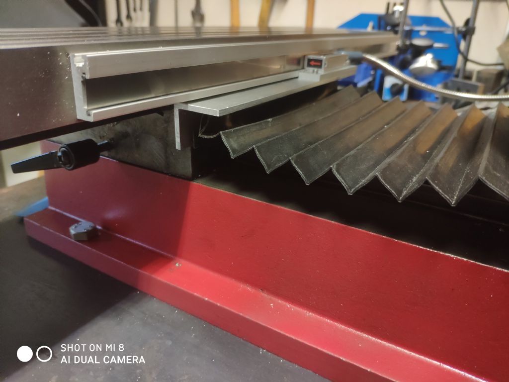

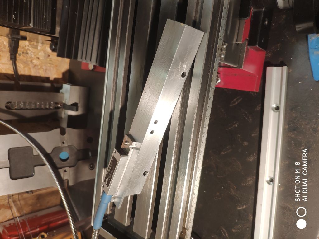

                        I used one of the supplied plates to support the reader head. This was then mounted on a piece of angle that fits to the existing swarf guard mounting holes. I will mount the Y axis this week.
                        I have some pics but dont know how to add them at the moment. once I find out how I will post them.

                          Sorry for the pics on the side. Anyone know how to rotate?
                          img_20201219_141710.jpgimg_20201219_141717.jpgimg_20201219_141756.jpgimg_20201219_142017.jpg

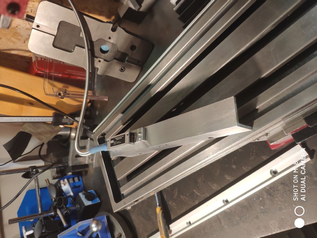

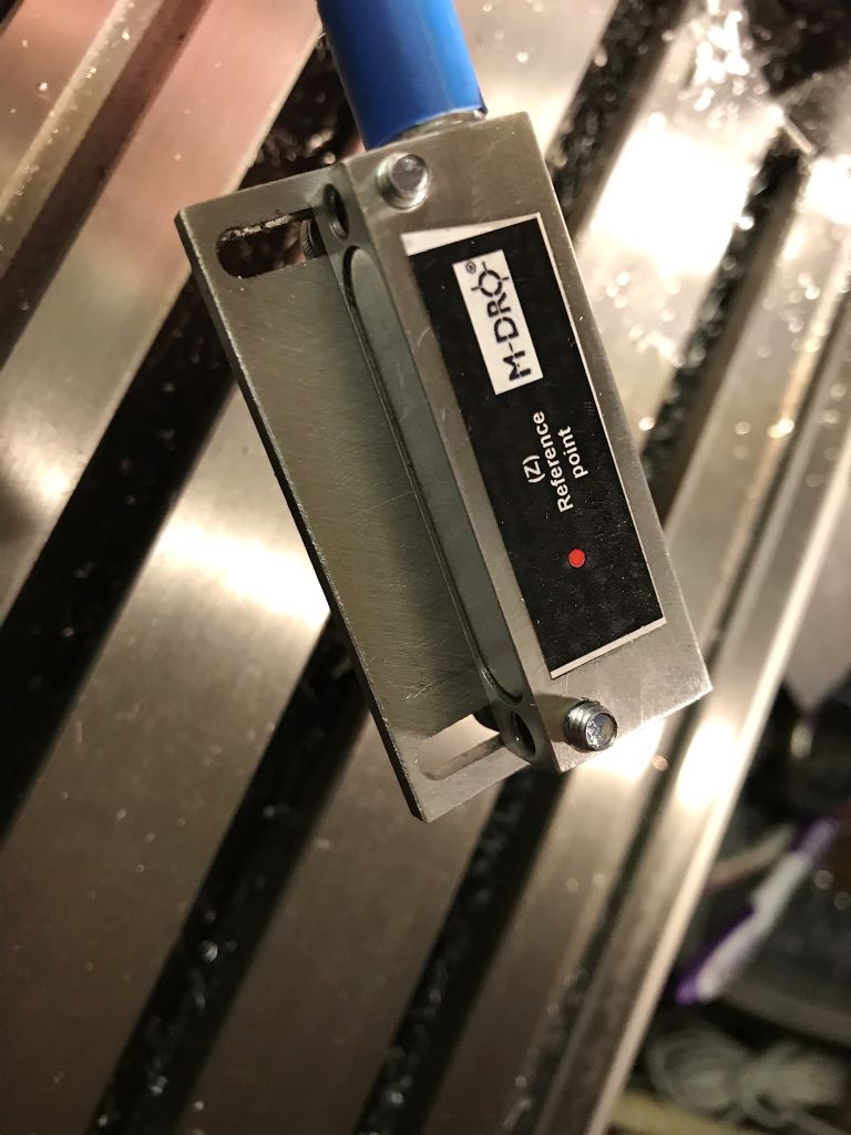

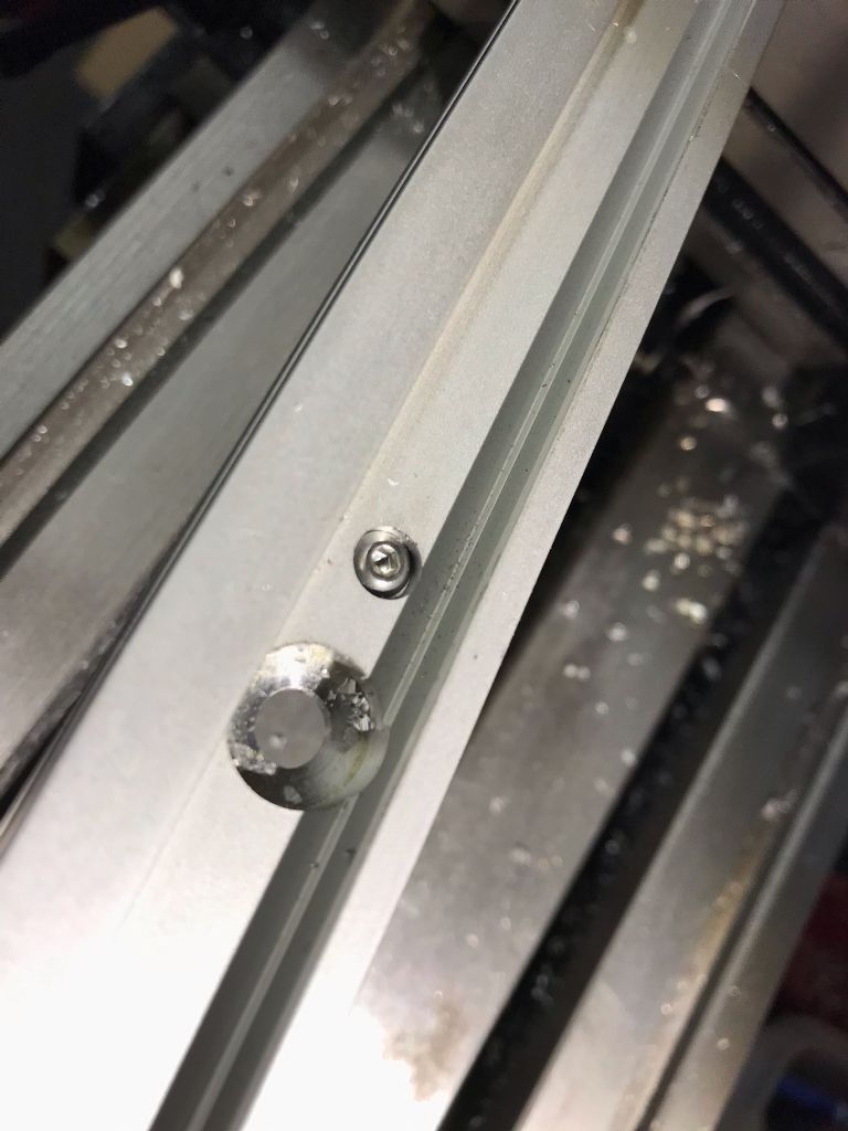

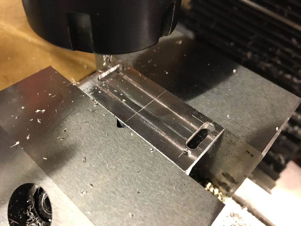

                            31a7fee6-1c00-4849-adfe-3ffd1a51defe.jpeg49637a58-0872-4116-a000-32251d3efcd6.jpega85c2dcc-84c6-4e0d-b9af-02c94159f011.jpegead0ad3c-7115-4e82-b550-1f356767e210.jpeg
                            Hi Roger,
                            Some photos of my X axis installation.
                            Paul

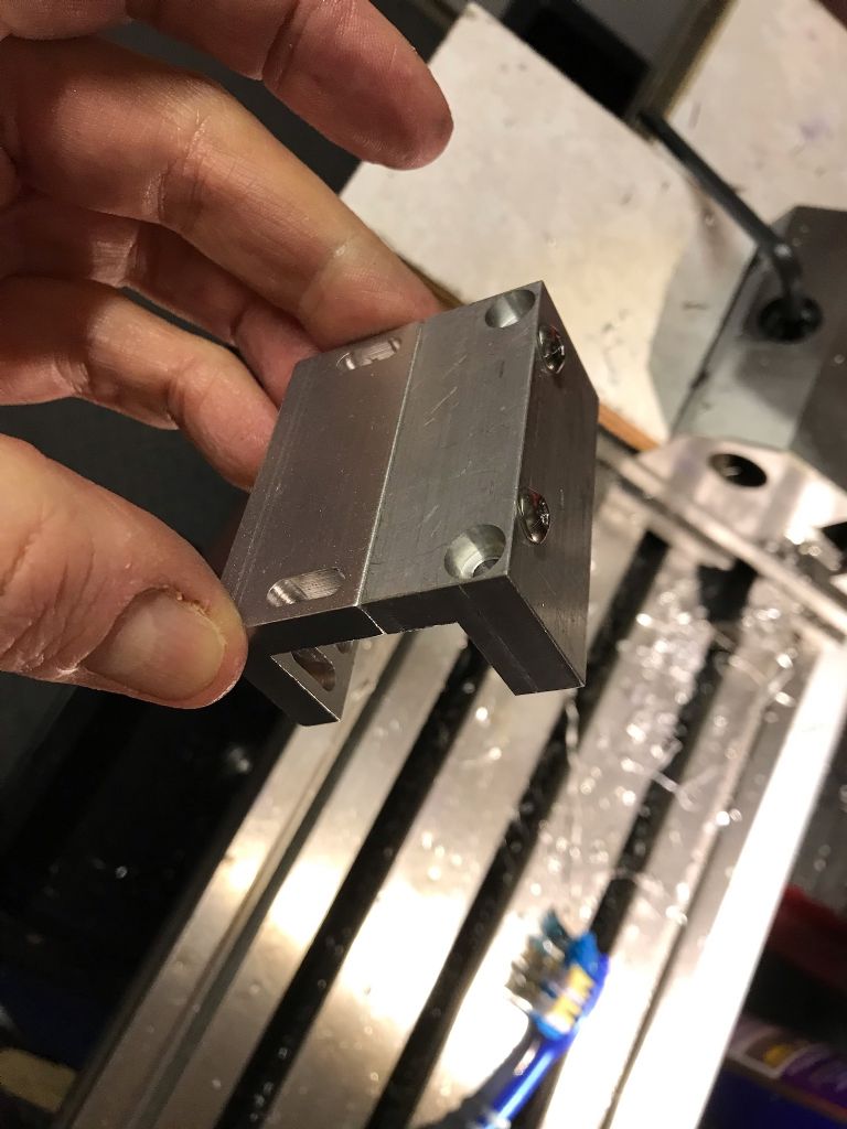

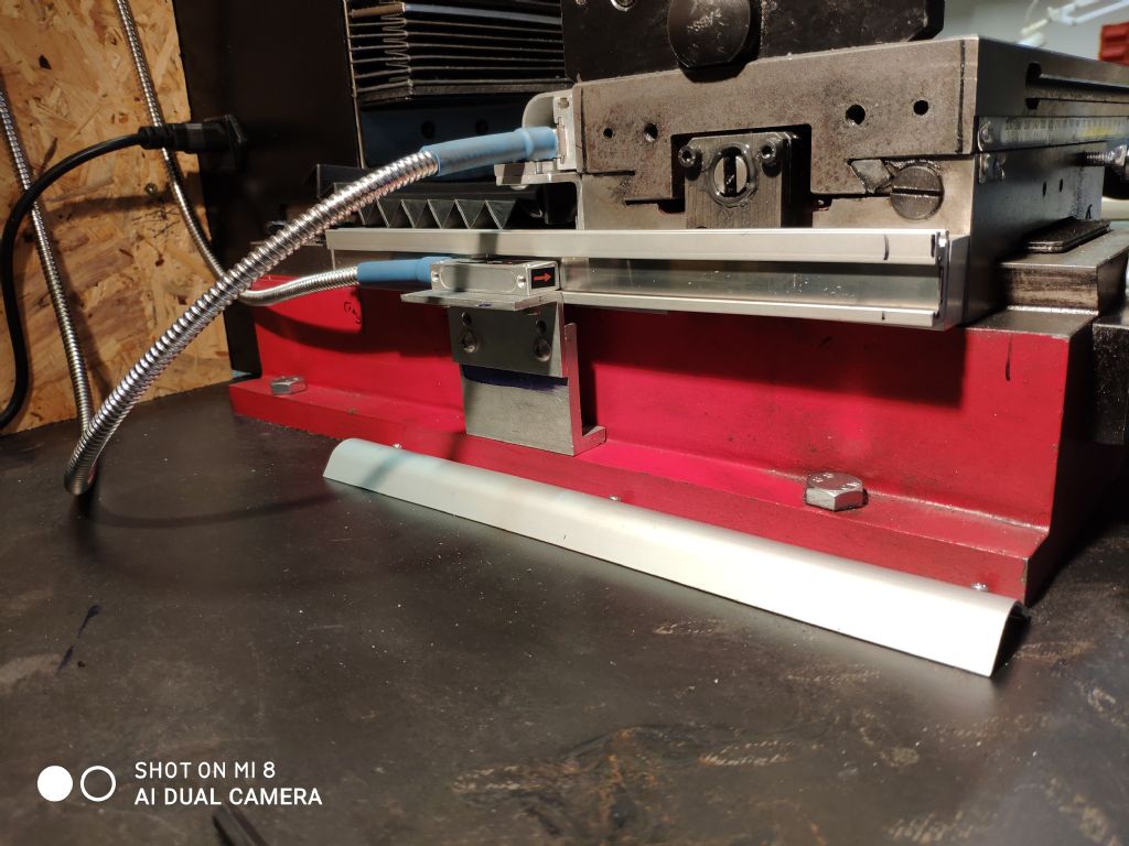

                                Hi Roger.

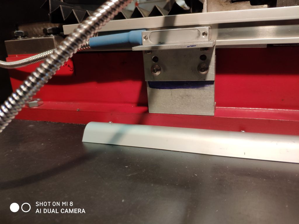

                                After 3 weeks at sea I have finally had a chance to fit the Y axis DRO.
                                I opted for a fixed tape and moving read head.
                                I used the supplied bracket, then made another bracket to bolt to this, and then both bolt onto the table in the drilled and tapped holes already there.
                                The documentation which was supplied with the kit said the head would work with the tape up to 1 degree angle. This was the angle of the casting of the base, it works fine.
                                Anyway, hope you got yours installed.
                                Paul

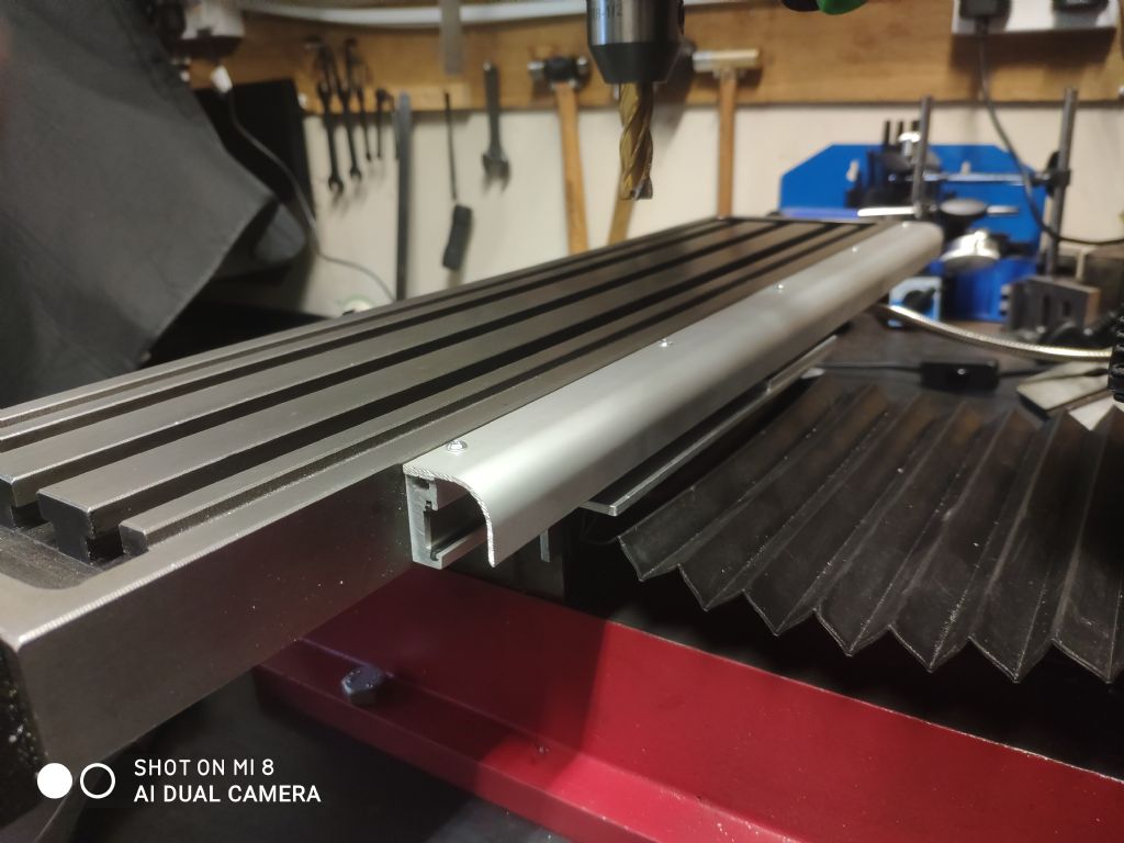

                                  yaxis 3.jpgyaxis 2.jpgyaxis 1.jpgNice Job. I finally got my Y axis installed as well. It is working great. I don't know how I got on without it before.
