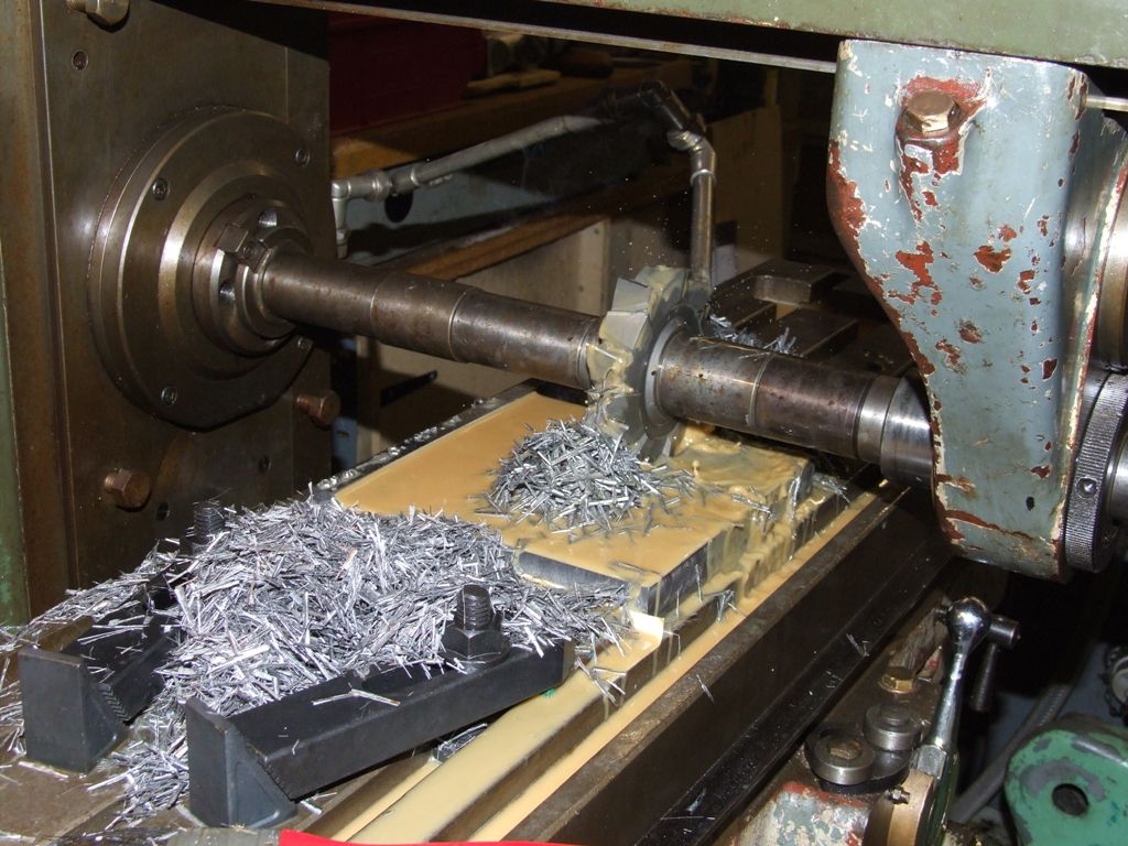

                                      No point in having a horizontal mill if you don't use it to make swarf; 1" wide cutter and ½" DOC:
                                      All my S&F cutters and slab mills are secondhand, via Ebay. Many still had the wax coating,so either new or reground. Don't think I've paid more than £10 for a cutter. Of course there are always the dreamers asking silly money, and cutters with teeth missing, but it should be possible to find decent cutters at a sensible price.
                                      I have the wherewithal to sharpen S&F cutters, although thus far I haven't needed to.

                                      not done it yet
                                        @notdoneityet
                                        If that is a good guess, at 400mm, he would need to have two stabs at it. Table travel is only about 225mm on a 2A. A 40mm riser is neither here nor there, I would say. My ally riser is about 120mm – and that is on a 2B. The work entailed would be considerable and a decent sized riser would only cost extra material. Could bolt on the other dovetail, I suppose….

                                          Posted by Andrew Johnston on 03/10/2017 22:03:37:
                                          Posted by JasonB on 03/10/2017 19:02:21:
                                          Would have thought a side and face cutter in the Horz mill would hog it out better than using an end mill
                                          +1
                                          Andrew
                                          That's not a Centec your using ,unless I'm mistaken 😋

                                            Posted by sean logie on 03/10/2017 22:42:15:
                                            Sean
                                            But it is also a much bigger slab of metal, it's all proportional. Also the amount of metal that a S&F cutter can remove before it goes blunt would be quite a bit more before an endmill is past its best so figure in the cost of two or 3 milling cutters to one S&F
                                            If I'm right going by past posts this is for a run of QCTP tool holders
